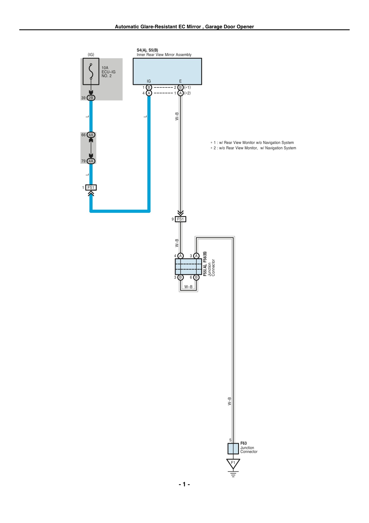

White plug S5 at the rearview mirror. You can cut the ground and switch it to accomplish what you want. It's the white wire with a black stripe, pin #2.
Only problem is with that ground cut the rearview camera in the mirror will not work (unless the switch is closed). Or- in addition to the switch, you could wire in a relay that overrides the switch and grounds the circuit when the truck is in reverse.
