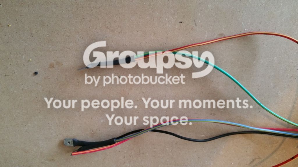

I received the CKMA12 as a gift for Christmas, and as I waited for the inflation kit, I did little research and prepped the AOB switch harnesses. I already have two AOB switches, one for the compressor and one for a future light bar, and I also have a compressor mount from a member here.
After looking through the parts and reading the instructions, I came up with a slight "problem" I wanted to make sure I solved in the install. For some reason the inline fuse was installed about a foot away from the compressor and over five feet away from the battery end. First thing was first, I cut back the tape to give myself some room and cut off the fuse.
Later I took the battery end of the cable, stripped it and used a butt connector and some heat shrink to attach it to one side of the gap, lined up the wire, cut it to size, and then connect the other side of the gap. afterwards I taped it back up just for fun, trying to make it look like it came that way.
Then I shoved everything into a split loom and taped the ends. I then taped up the locker solenoid connectors just to protect them.

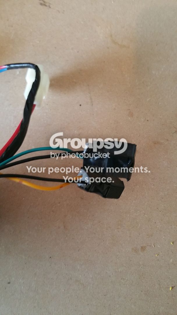

Next up I prepped the switch harnesses. I am not using the compressor for lockers, at least not yet, but I still wanted to use the main harness for a few reasons. It will allow me to be able to just plug in a switch for a locker down the road if I want to add one, It provides me with multiple wires to light switches but only had to tap one wire into the factory dash lights, and it provides numerous ground wires. Otherwise you can just hook your switch into the first part of the harness that you pull through the firewall instead of dealing with the three switch harness. I just put spade connectors onto the ends of the wires for the switches and they fit nicely into the female ends from the ARB wiring harness. From the AOB switch to ARB harness you want to go:
AOB --> ARB
Black --> Black
Blue/Yellow --> Blue/White
Red/Yellow --> Red
Green/Yellow --> Red/Yellow

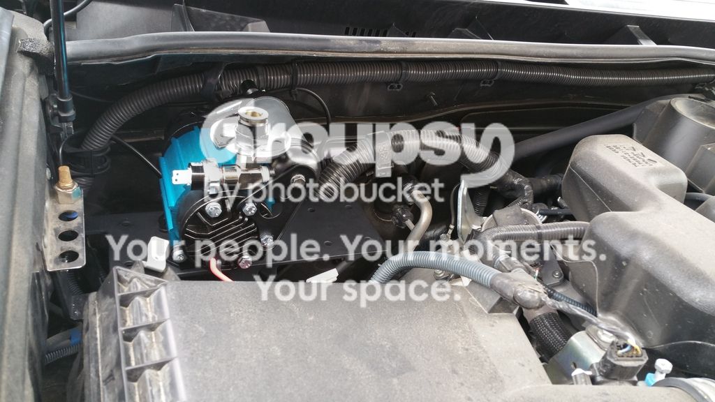

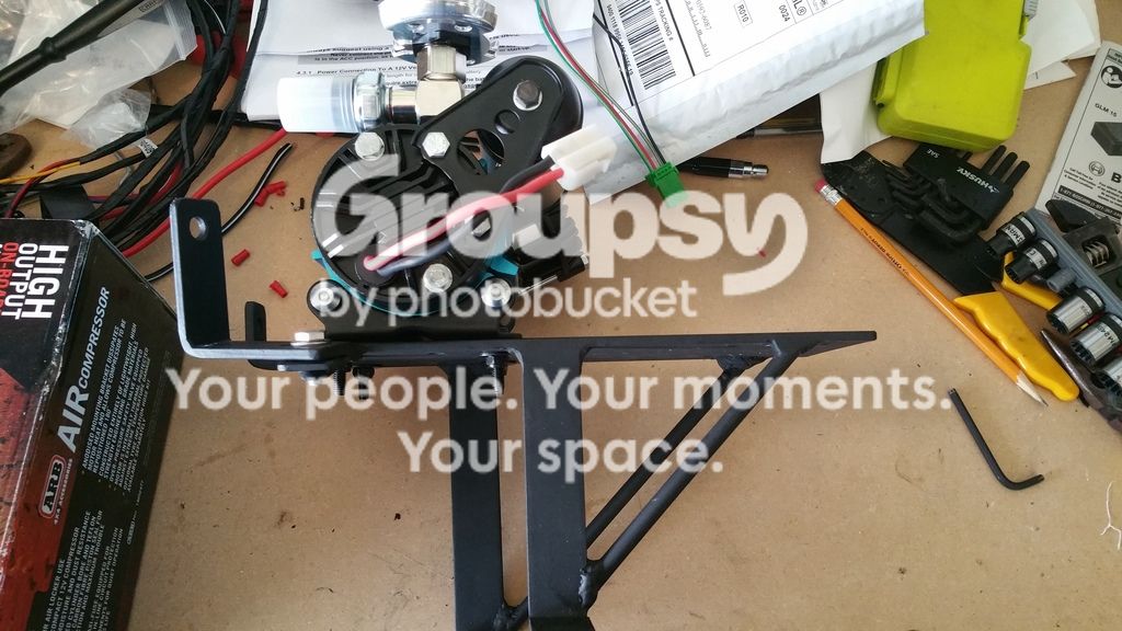

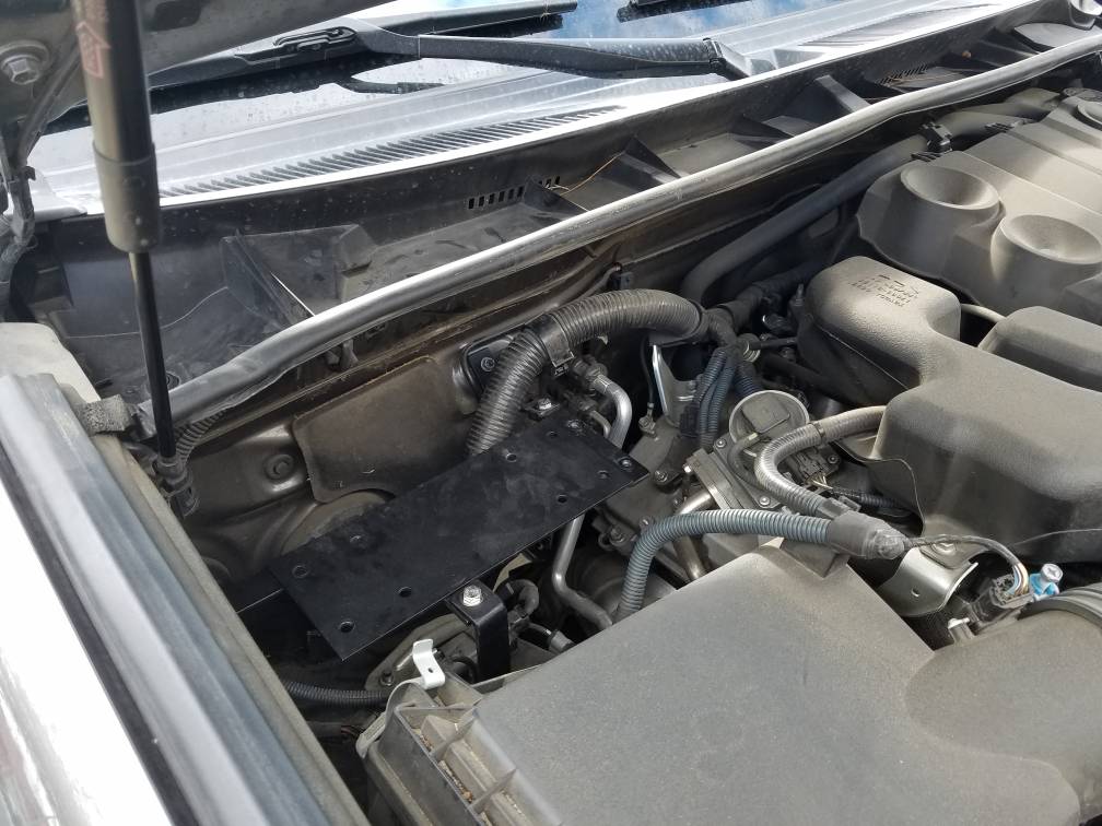

Once my inflation kit came in, I test fit the pump and mount in a few positions. I had to drill extra holes since this mount was made for the dual compressor so I wanted to make sure I got it just right... I failed, I placed the pump too close to the fender well and just could not get my hands in to bolt down the mount, so I had to drill more holes. But I eventually got it mounted up, I took some of the pictures before I moved the compressor on the mount.

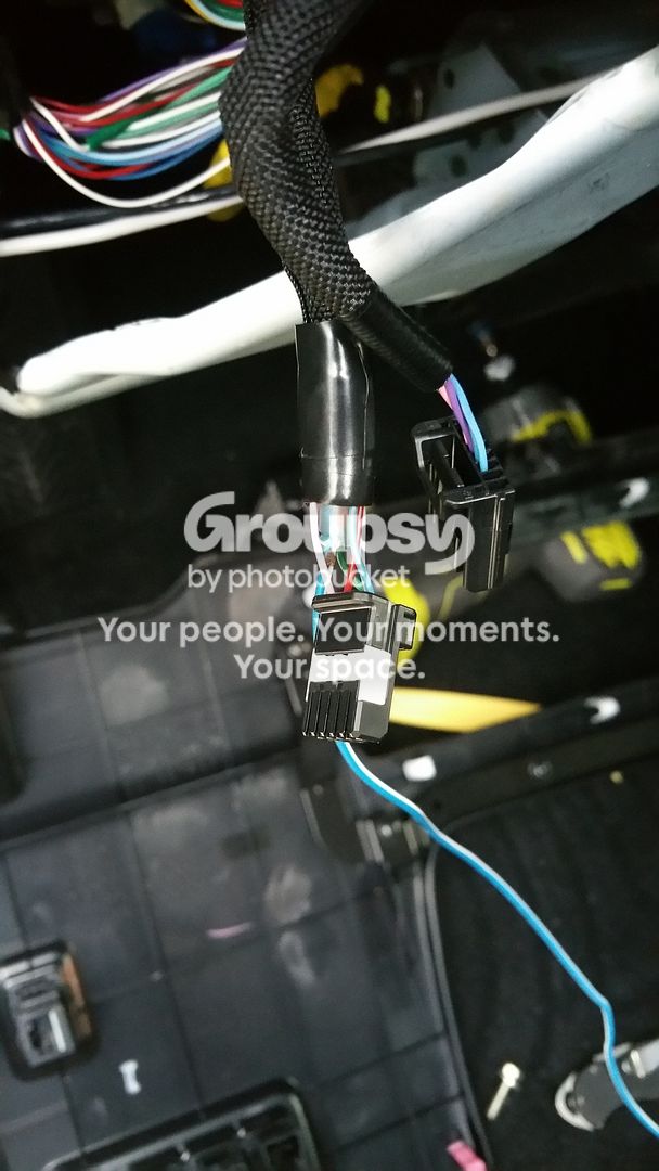

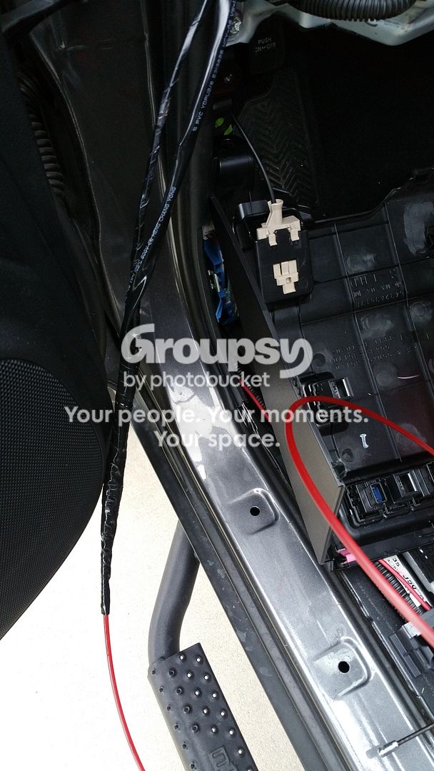

I ran the wires for the switch through the little nub above the main harness. I just cut it off and fed it though with a fish tape and some grease. I also fed through a harness for a led light bar I want to add later. I wanted to go ahead and get all the wires through at once, and I wanted to use the 12v supply for the switch from the light bar harness for the compressor switch as well.
These are the wires for the AOB switch for the future light bar and the Red/Yellow 12v supply wire for the ARB harness. I Attached the Red/Yellow wire from the ARB harness and the Green/Yellow wire from the light bar switch to a spade connector, then attached that to the light bar wire harness. Now I have a 12 supply for the light bar switch and all the switches on the ARB harness.

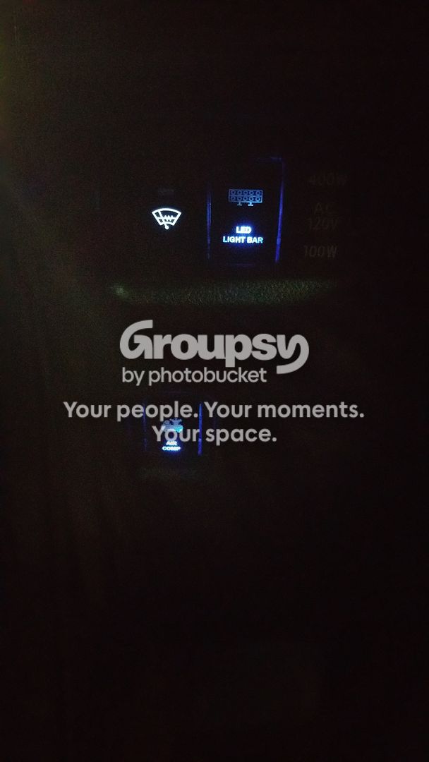

I cut the green wire for the wiper de-icer and used a butt connector to attach the Blue/White wire from the ARB harness with the green wire to illuminate the switch with the dash lights. I plugged the Blue/Yellow wire from the AOB light bar switch to the Blue/White wire for "switch 2" of the ARB harness since this switch will likely never be used by me given I already have one locker.
I tucked everything up and tested the dash lights. I Need to go back at some point and trim down all the excess wires. I just didn't have all the proper parts or time to do it today.

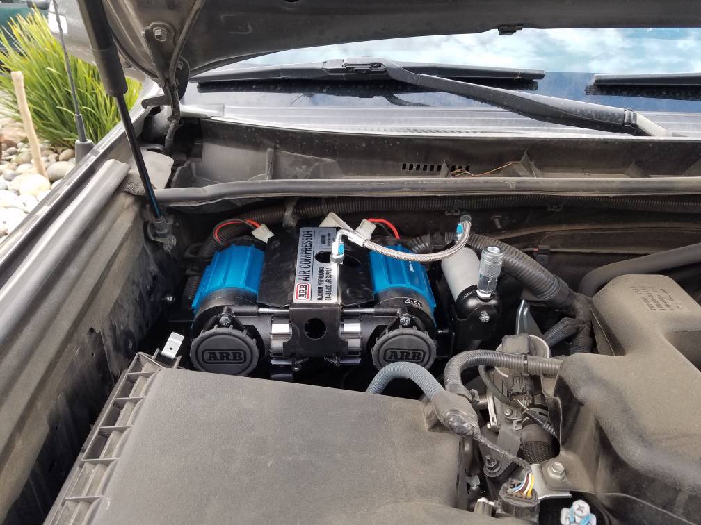

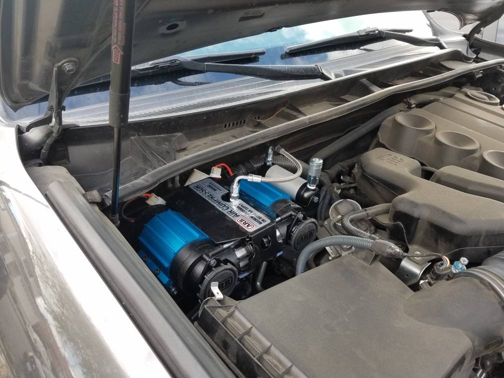

Lastly, I hooked up all the power and zip tied the ARB wire loom along the top of the firewall. I ran the loom under the mount to avoid the heat from the pump melting the wires or connectors.

It's a 40 amp fuse. I tossed the idea around of using a slot on the blue sea box since the amp draw under load is less than 30 amps, but I decided to leave the inline 40 amp fuse and attached the lines to the pos and neg studs on the fuse box with the cables from the battery. That way I can still "use" the fuse box without exceeding the maximum amps for the slots.
Can I ask where you got the mount from? A member thats making them or just someone who was selling one? Looks really nice!

[MENTION=125603]bandi[/MENTION] makes them, he is a member here. Very reasonably priced.

Love the AOB switches and the factory fit! I have a few for my Gobi lights. How's the compressor working out in that location?

Great write up. I installed the same compressor with an AOB switch. Love the OEM look of the AOBs. We installed 5 switches and have 2 hooked up so far. Waiting on our roof rack before we can hook up 2 more sets of lights.
Where can I find a mount for the ARB. In the engine bay what's the best position??
See above...the bandi mount is pretty good. I got it over the Slee (which is local to us here in the front range) because I wanted to mount mine on the passenger side rear of the engine bay. Send me a PM with you cell and I'll shoot you some pics. Don't have any on the computer.
Here's some photos of the Bandi mount. I picked this one last week. Solid mounting solution for the ARB compressor. He has a few different options as well.
If I am not running a light bar harness can you recommend where I should tap in the red/yellow wire?
I believe it has to be tied into a 12v power supply. I am running this now and am planning on tapping into the dimmer switch. I believe it is the green wire that supplies power to that switch.

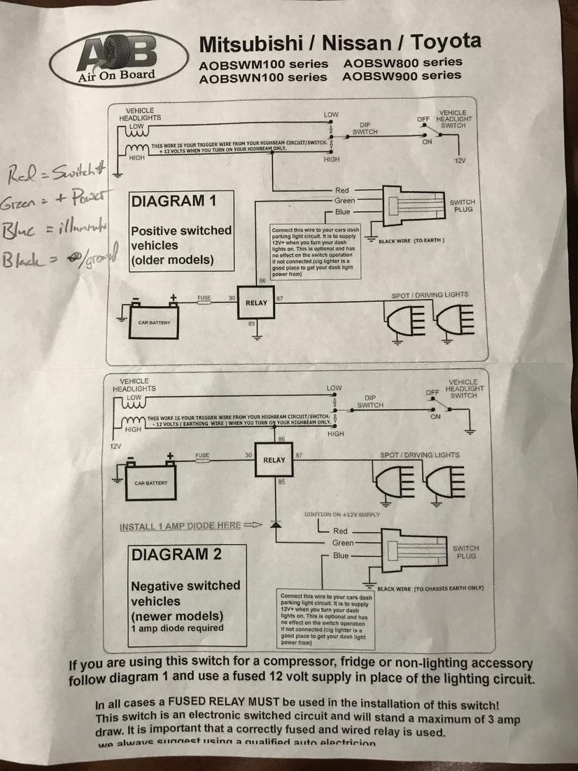

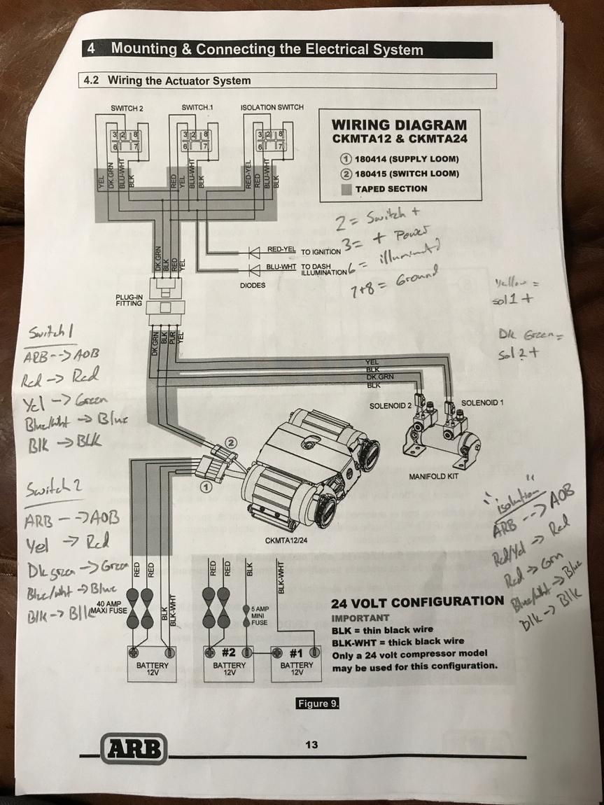

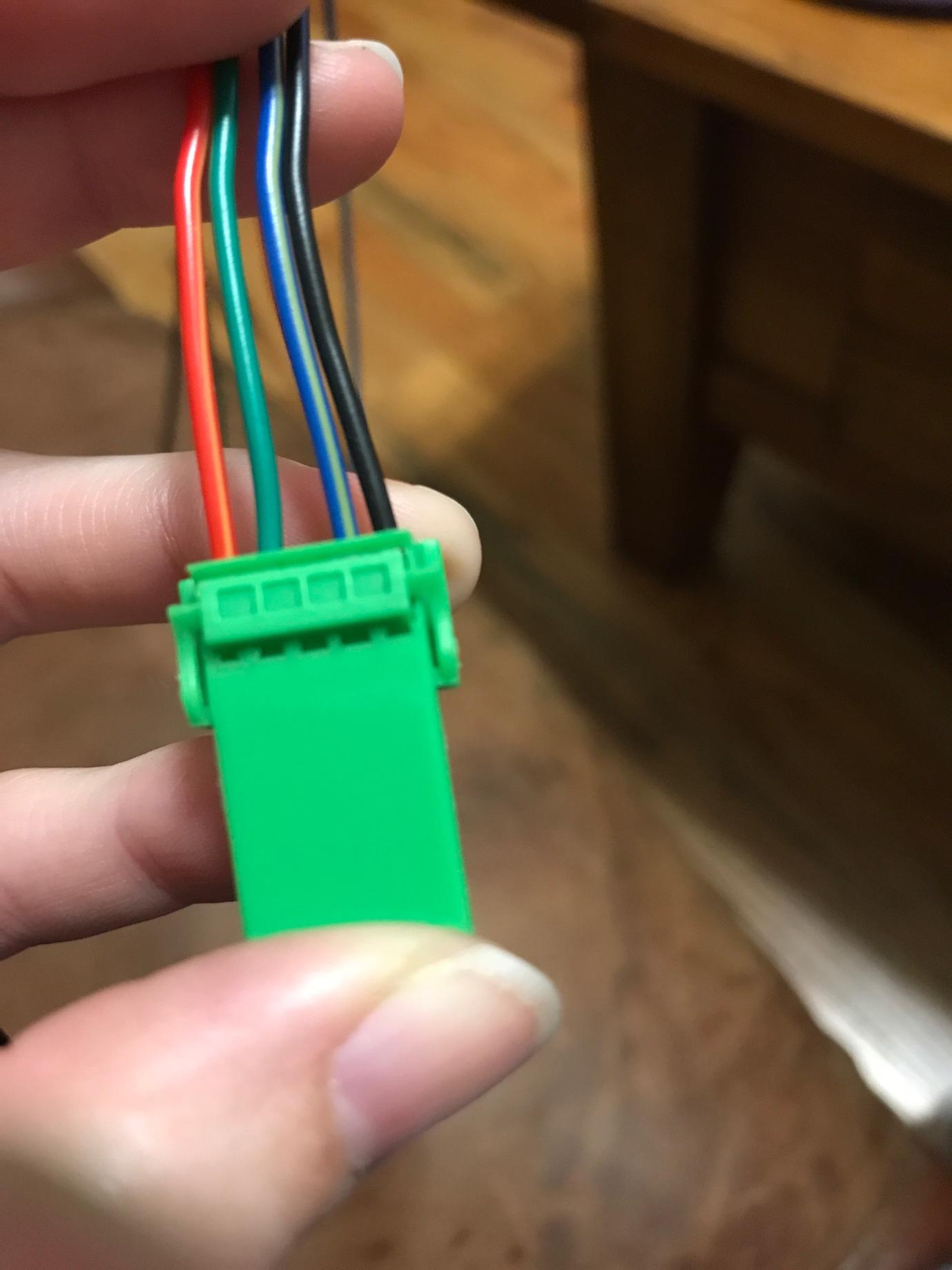

We're working on a similar install this week as well. We're hoping you guys could take a look at how we believe we're supposed to make the connections and let us know if we've got it right or not??? The instructions and wire colors seemed to have changed some from previous threads we've checked out.
AOB instructions

These are the plugs we got with the switches.

ARB instructions
So just in case the hand-writing isn't showing up well enough I've typed it out here:
Isolation Switch:
ARB ---> AOB
Red/Yel -- > Red
Red ---> Green
Blu/wht --> Blue
Black ---> Black
Switch 1 (R):
ARB ---> AOB
Red ----> Red
Yel -----> Grn
Blu/wht ---> Blue
Black ----> Black
Switch 2 (F):
ARB ---> AOB
Yel ---> Red
Dk Grn ---> Green
Blu/Wht ---> Blue
Black ---> Black
Does this make sense/look right????
Thanks!!!
