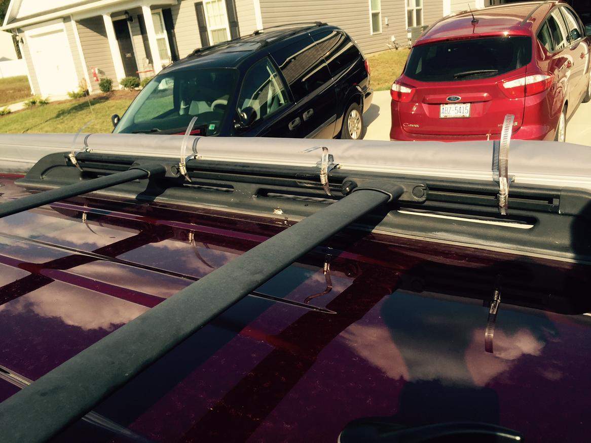

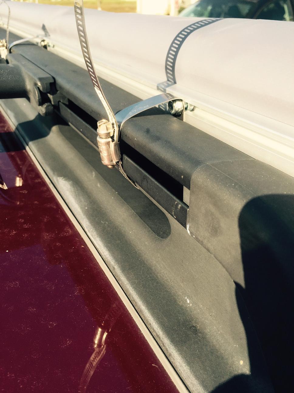

I ended up using worm clamps. Gotta trim them up, but is definitely secure.
If that falls off on the road you are putting people in danger around you. Keep that in mind. That will loosen and break eventually.
