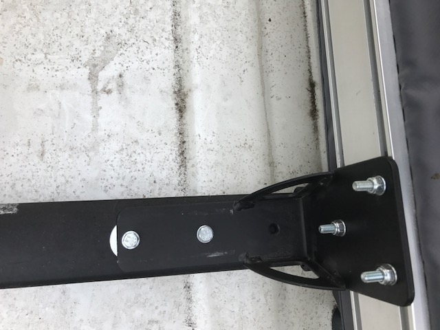

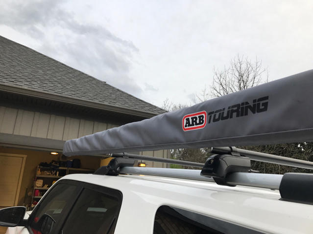

It can be very easily done. Use ARB's gusseted awning brackets and some bits from the hardware store. The factory cross bars are aluminum and can be drilled out no problem. Be sure to put a large drop cloth down to collect any metal shavings during drilling. Laying something down to protect the roof from overdrilling wouldn't be a bad idea, I used some HDPE I had left over from another project. I also stacked two fender washers under the bracket to sit it even with the outer lip of the factory cross bars. I'll update with more photos when I get to my computer.

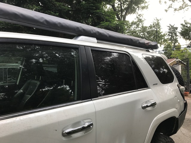

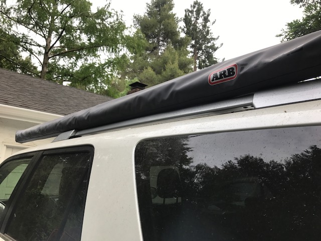

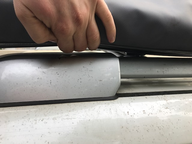

Nice, good deal. Here are some more shots. The ARB bracket allows for vertical/height adjustment. I set mine at the top, this enables enough room to get your fingers underneath to operate the zipper. You're gonna love the awning!
That looks great! Definitely looks to be the best way to mount on the OEM rack/cross bars. I already had those ARB mounts ordered anyways as I planned to use them when I do upgrade the rack, so they will double as both purposes.
Looking forward to using the awning. We move all over the country for work and are usually close to beaches, however I typically sunburn bad and had skin cancer at 27, so I avoid the sun quite a bit. With the awning and walled awning room, I should be 100% good to go!

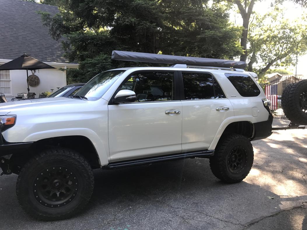

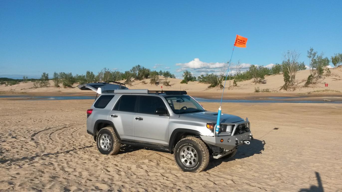

Is that ARB the 2500? Looks good. How long is the part in the front that is unsupported? I believe they recommend 2ft or less.

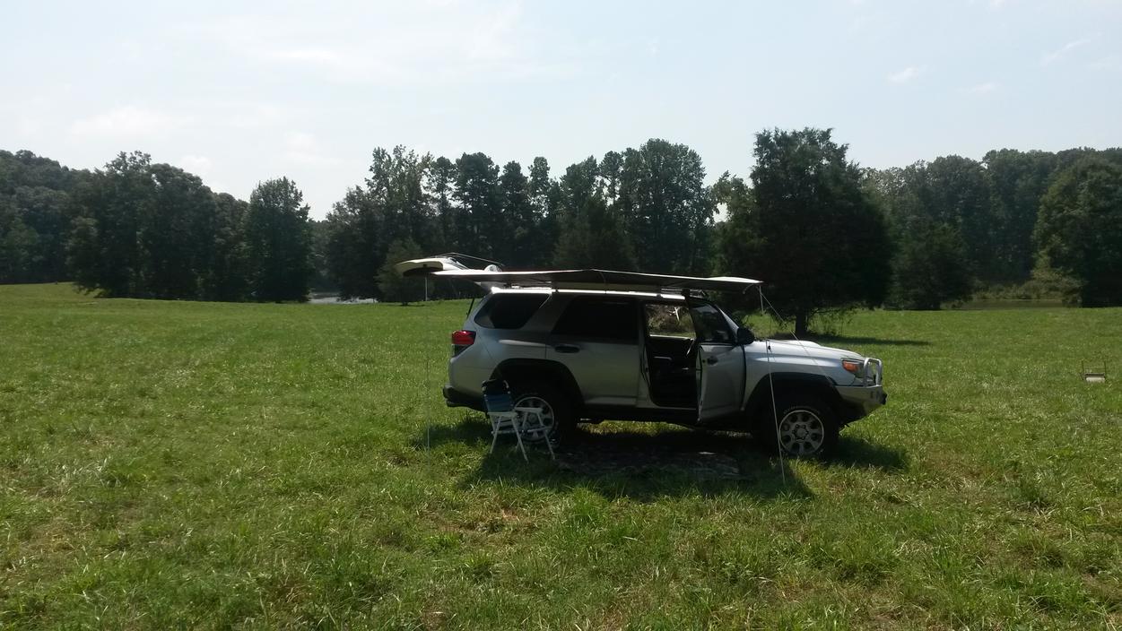

Yea it is the 2500, figured if I was going to carry an awning mind as well get as much coverage as possible. It does stick out pretty far in front.. I had read that 2ft recommendation as well but it works for now until I get a proper rack on. It survived a week in Death Valley if that helps. I can take a pic tomorrow showing overall length.
Measured, when the awning is adjusted such that you have it all the way back but can still open the tailgate, it overhangs 4' from the front mount.. not ideal but seems to be holding up fine for temporary use. Hope this helps.
I'm honestly not at all concerned with that route of mounting. Mine is 500mm shorter so will be slightly better, but I'm sure still ok either way.

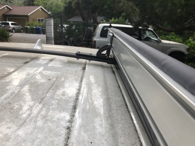

im pregaming an awning purchase, but gotta ask why folks havent considered doing a simple L bracket off of the Tslot OEM rails? torsion issues?
something like this
black is the ARB bracket mount they sell. Purple the awning, Gold is screws. and grey is the custom fab.
