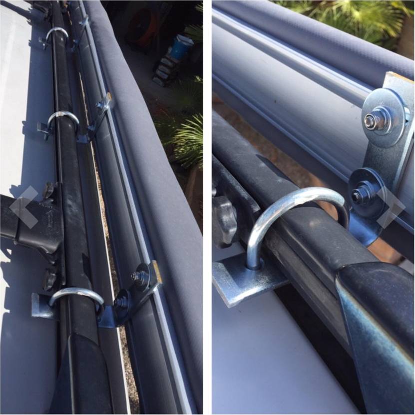

Has anybody thought of this??? I got these photos from this site but I cannot remember who posted them, and this is mounted on a stock rail. Any thoughts/ideas?

Found this on another site, oem rails 3rd gen ARB Awning, looks "simple"
Has anyone done this yet, or found another way to mount an awning to the oem rack?
Seems like there's tons of interest yet I have yet to find a person that's done it successfully (other than this picture, which we're not sure where it came from).

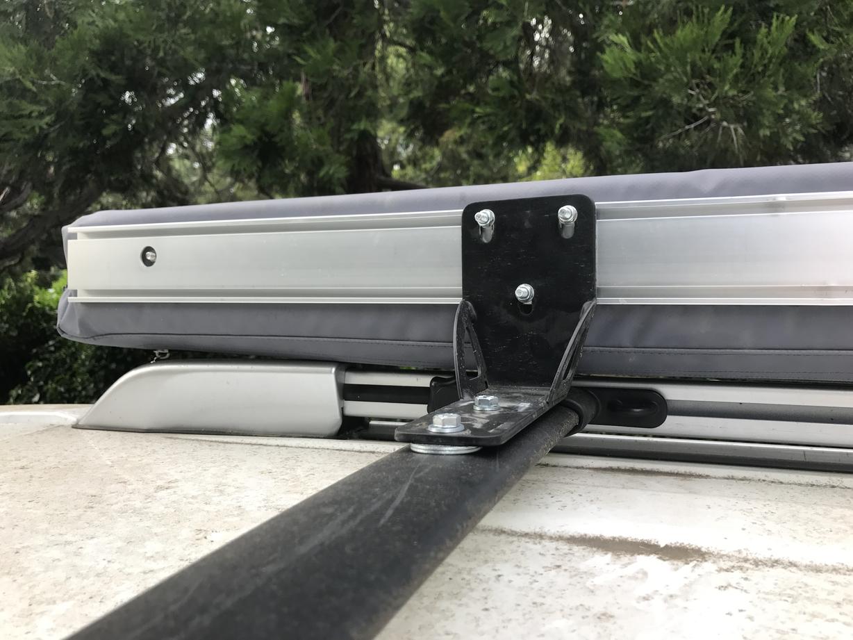

I have my awning coming next week or so and will post up how I mount it so this old thread will hopefully at least have something productive in it. I won't be ordering my roof rack for another month or two so will need something to suffice in the mean time. My original thought was the L brackets as is shown above. I did order the brackets from ARB with the awning to see if those could possibly work with a U-Bolt to go over the oem rails.
It can be very easily done. Use ARB's gusseted awning brackets and some bits from the hardware store. The factory cross bars are aluminum and can be drilled out no problem. Be sure to put a large drop cloth down to collect any metal shavings during drilling. Laying something down to protect the roof from overdrilling wouldn't be a bad idea, I used some HDPE I had left over from another project. I also stacked two fender washers under the bracket to sit it even with the outer lip of the factory cross bars. I'll update with more photos when I get to my computer.
Those L brackets are funky looking, I'm thinking they may have had to wallow out those holes or drill new ones altogether to replicate the ARB bolt pattern, but I could be wrong.
While that looks perfect, I don't have factory cross rails. I could potentially pick some up, but I'd hate to dump too much money into the project knowing I'll be getting a full rack in the upcoming months.
