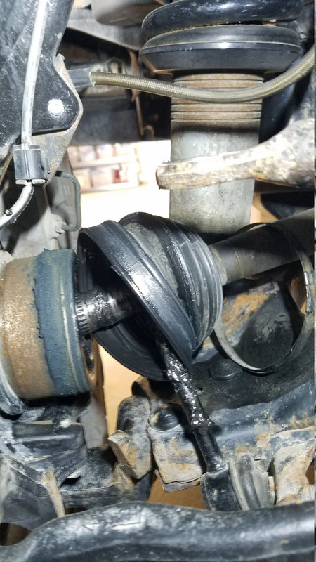

That's the setup I had until I got tired of replacing broken ones on a yearly basis simply from let's say spirited road driving. Now I have 3rd gen fronts on the front and rear because I had an old set lying around. I'm sure it was the poly bushings that kept breaking them because I haven't had any issues since replacing all of them with OEM rubber ones. The poly sway bar bushings would constantly fill up with sand and grit too.
Not sure if this would have happened with the stock length fronts. It was when I had the longer 2nd gen ones on the front. Happened a few days after I installed a brand new cv axle pfft. Took me a little while to notice, it didn't affect the driving other than body roll which made me look. Was actually able to regrease and reclamp the boot. Something to consider.
Whoa wth? So your link disconnected somehow and jabbed your CV boot?
Yeah it snapped off at the bushing washer and managed to push the CV boot/clamp off. I always wondered what would happen if an endlink broke and flopped in to the steering or CV and assumed Toyota had thought about this scenario so didn't care much. But obviously this one was longer than stock so that's what can happen I guess.
