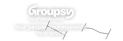

The thing you have to keep in mind is the IFS won't have the ability to get over objects like a solid axle due to the design. Here's a basic diagram of the geometry
axle.jpg~original
Oh, also, you can bend IFS a lot easier. By the time we swapped the axle off the 89 4runner, the IFS bracing was leaning on the front diff.
Thanks Galatic, your diagram makes perfect sense. When the vehicle with IFS is leaned over and the inside wheel goes up, the front diff stays put and you lose clearance.
