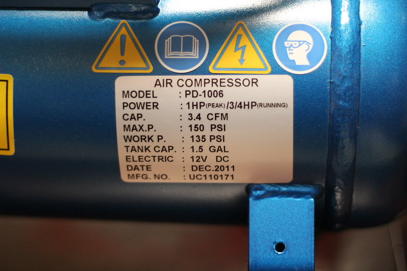

HOLY CRAP!!! That price can't be right! I paid $300 and change. As for the specs... I'll look because they used to be on there (I bought it in late 2016). At the time, I spec-ed it out and it was better then the ARB Dual. I don't remember the numbers right now.
Order Summary
Item(s) Subtotal: $309.51
Shipping & Handling: $19.49
Total before tax: $329.00
Estimated tax to be collected: $0.00
Grand Total: $329.00
SPECS:
http://shop.air-zenith.com/200psiob2-black.aspx
http://www.air-zenith.com/images_u/220200983135PMOB2 MANUAL.pdf
I did buy the ARB manifold when I got my gears and locker from ECGS and it works fine with this compressor.

I known that you have pretty much made up your mind about the compressor but I might throw out one more option.
I love my puma and it fills faster at 3.4 cfm @ 40 psi than almost anything else on the market for the size.
IMG_1587 by Sam Wright, on Flickr
Here is a great thread on it.
https://forum.ih8mud.com/threads/puma-12v-compressor.166969/
with the removable tank it would be super simple to set up to run both your ARB's and to fill tires and even run some air tools.
and is a happy medium on price. $240
https://www.ebay.com/i/283005940134?chn=ps
Just another option. :lookout:

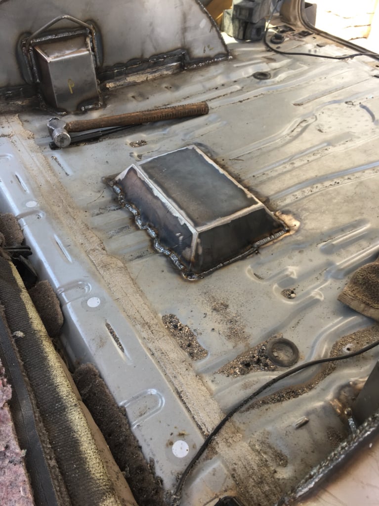

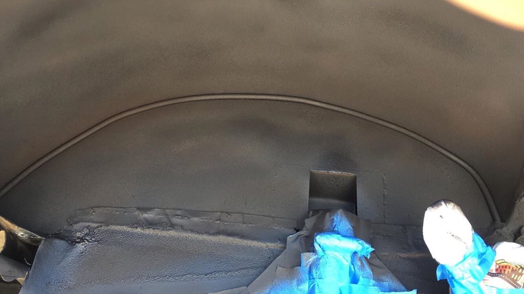

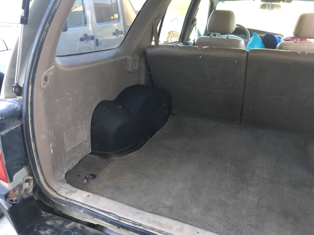

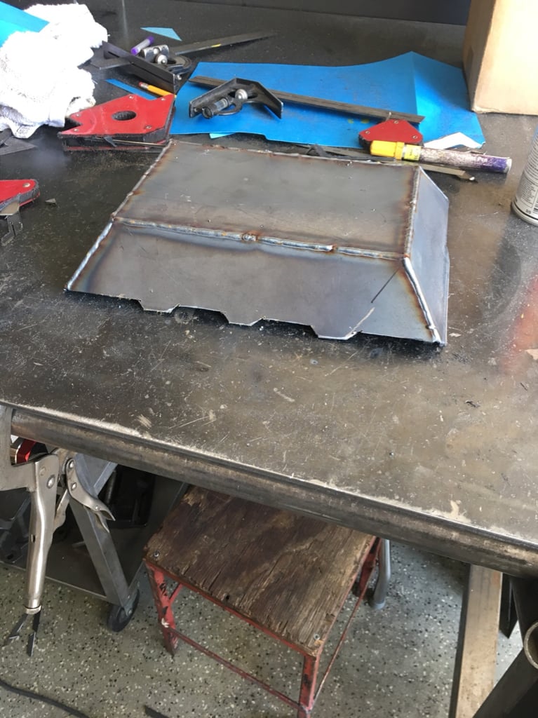

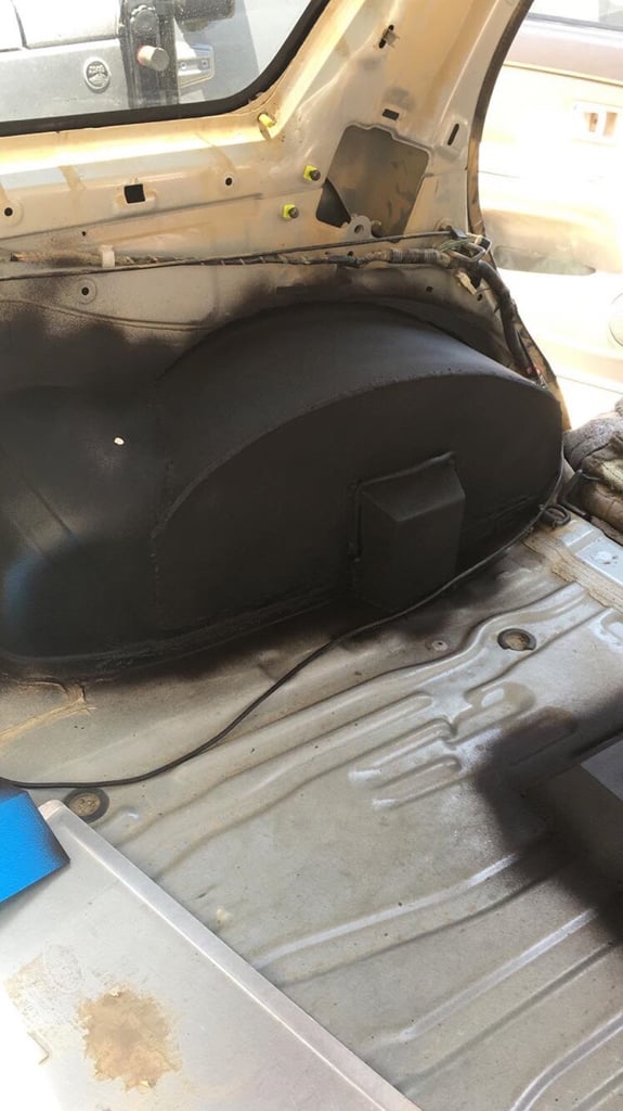

Got pretty much everything to do with the tubbed wheel wells knocked out this past weekend. Started off Saturday morning by fixing my wifes Chevy Cruze again... Had to replace the PCV Valve that is part of the valve cover. I just replaced this part in November 2016. After that I got working on the 4runner. I knocked out all the final patch work on some of the smaller areas, and just did a little more prep work. Nothing worth taking any pictures for, except some additional tie down points made from 5/16" rod. Still didn't take any pictures though.
Sunday I was able to spend all day on the getting it done. I started by covering that little hole in the middle of the floor. The upper links come through the floor about 1.75" at full shock bump so, I made a hump that was about 2" tall. I used a little thicker steel for this piece (14g), because it needs to take a little more abuse of throwing a heavy tool box on top of it, and it needs to really hold some rigidity since the brace on the bottom was obviously completely cut out. I wanted to make it more of a trapezoid shape to keep some triangulation in the mix for rigidity, and also so that its not as much of a blunt edge to get my toolbox hung up on as much when pulling it in and out. Also not having 90* corners, makes it easier to clean all the dirt 'n shit.
From there, it was time to prep everything for paint. I just used some acetone and a rag to wipe down all the surfaces and grocery bags over the shocks. Pretty straight forward. I used some of that Spray On Undercoating to spray everything. I can't remember which brand, and can't compare to something like 3M since I've never used this stuff before. I went to town on all the seams with a few thick coats on the inside and out. Then started with a few coats all around on the entire wheel well, both inside and out. This stuff seems to work alright. I wish it was a little thicker and more rubbery, but it will do. Eventually I will do some indoor/outdoor carpet on the wheel wells. Then painted the frame and bump stop cans with some semi-gloss paint.
Next was putting the carpet and plastic panels back on. I just rolled out the carpet and cut a small corner out on the passenger side wheel well. The rest I just pushed into place. I might cut it a little more to make it fit a little better, but idk yet. For the panels, it was just cut, fit, cut, fit, etc. until it was right. I did cut the passenger side a little much on the top (Maybe 1/2'-1"), but it will be fine. The drivers side came out much better.
Last thing was putting the bump stops in. I put a thin layer of anti-seize all throughout the cans to hopefully keep the bump stops from getting stuck and rusted in down the line. I am going to pick up my buddies nitrogen tank after work sometime this week and air up the bumps and shocks a little more. I'll take it with me on my next trip out to play around with the pressures. Eventually I'll get around to meeting up with my other buddy that turned some bump stop spacers for me to shorten the stroke to 3" instead of the current 4".
Now that all that stuff is done, I need to finish buttoning up a few things. I had my brother order me a new fuel pump today, so that I can replace that this weekend. Then bleed the brakes, tighten the link jam nuts, and air up bumps & shocks, and hopefully cruise up the fire roads for a quick test of the new setup.

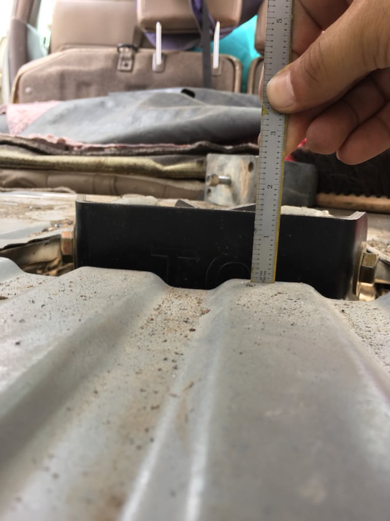

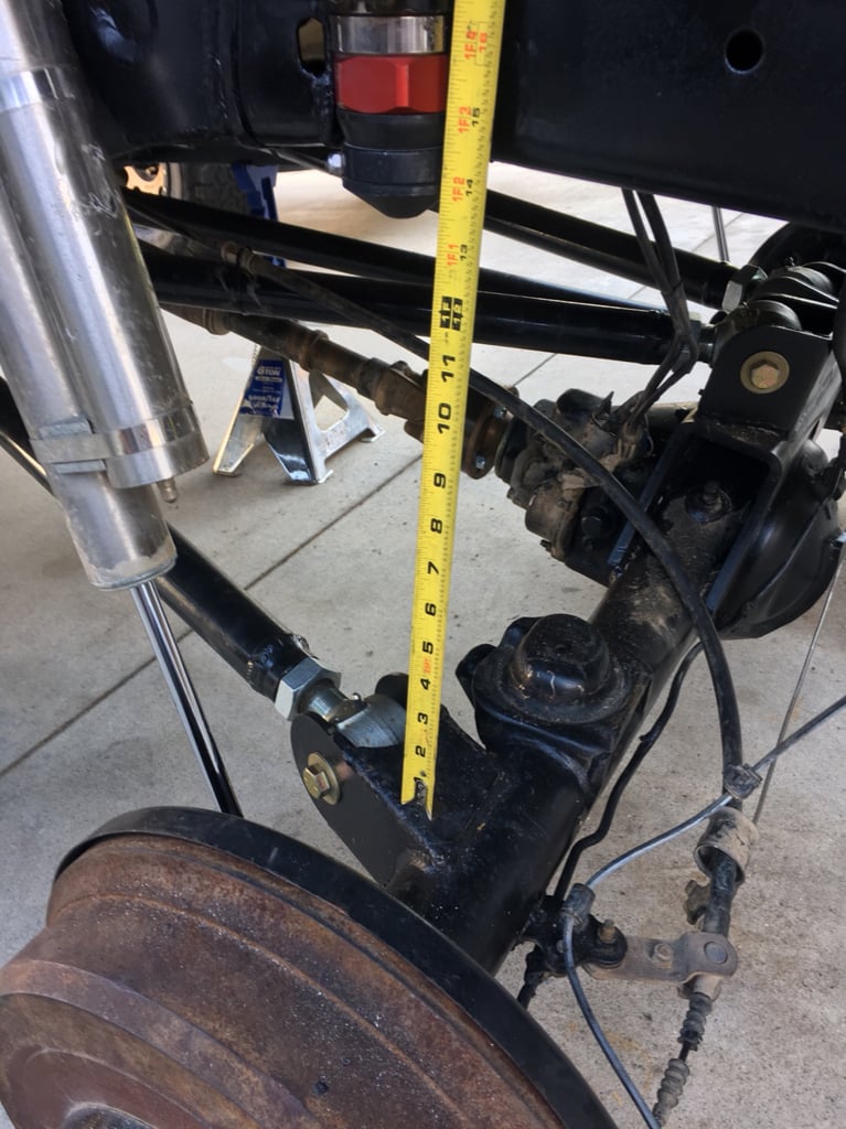

I took some measurements of things after I was done working on things for the day. Measuring the travel without bump stops, just shocks, it came out to 14.25". The axle sits 1/2" below the frame rails with the shocks fully compressed. With the bumps installed, it measures out to be about 13.5" of total travel with the axle about 1.25" below the frame rails at full bump. Not bad. Now I need to focus on the front end before I get too far into the rear end. I don't see a point in getting much more than that until I have significantly more travel up front to justify more rear end suspension. Long term plans are Long Travel (either keep IFS or go TTB swap). From there I would need a wider axle to match track width and fit coilovers/bypasses. If money permits, then a fabricated 9". If not, then maybe a Tundra 10.5"? Still don't know what the WMS is for those newer Tundras.
Also today I ordered an ARB Single High Output compressor from Amazon. It was Prime Day (What a joke that turned out to be!), so it was on sale for $30 off at $246.09. I also pulled the trigger on the front locker from ECGS. I went with an ARB, and obviously 5.29's to match the rear end. I ordered it a little later in the day, so I haven't spoken with anyone on the current turn times yet. I will call them tomorrow to see what they estimate. Pretty stoked to finally get this thing back on its feet and 4wd again. It's been 9 months without 4wd and almost 3 months since I've driven it. I just hope I don't get too excited and break something first trip out in my typical fashion...

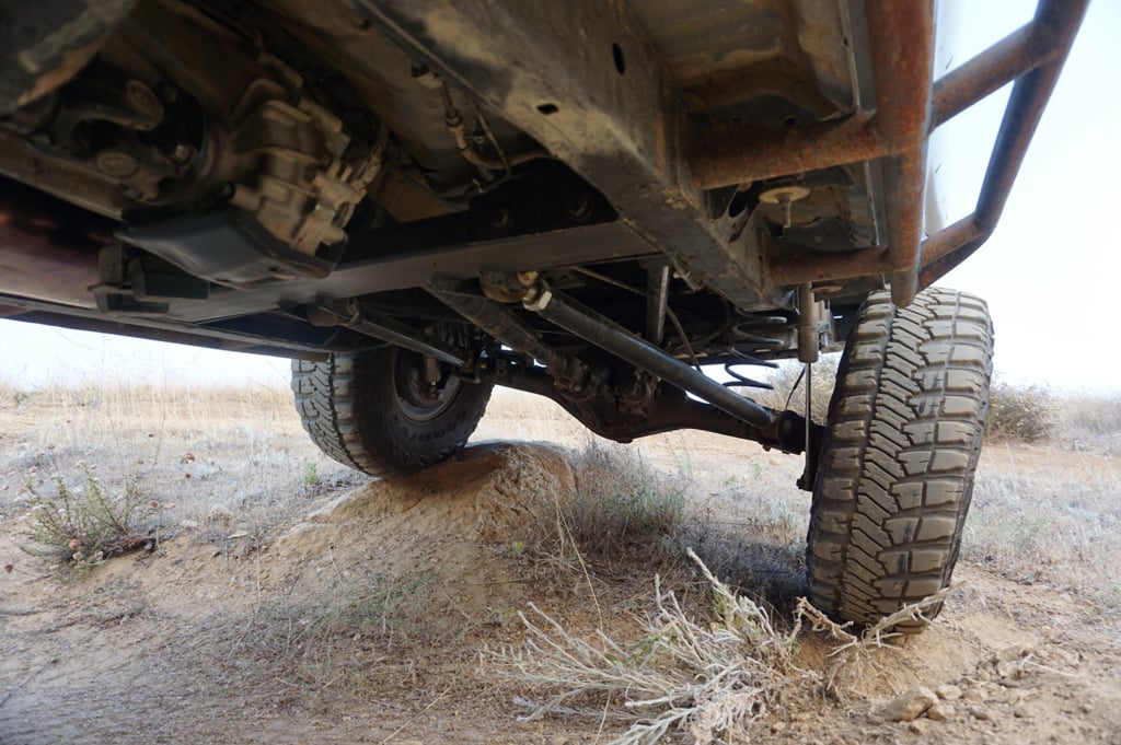

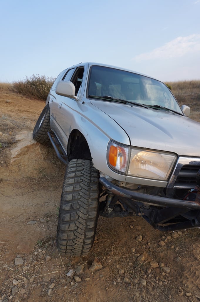

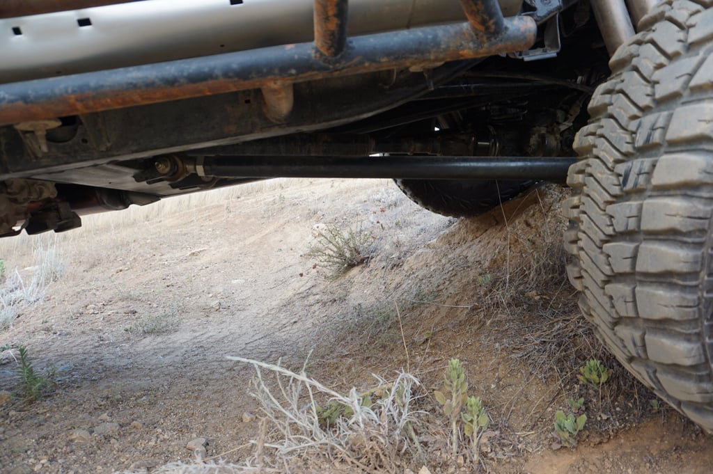

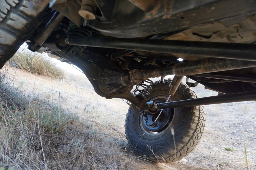

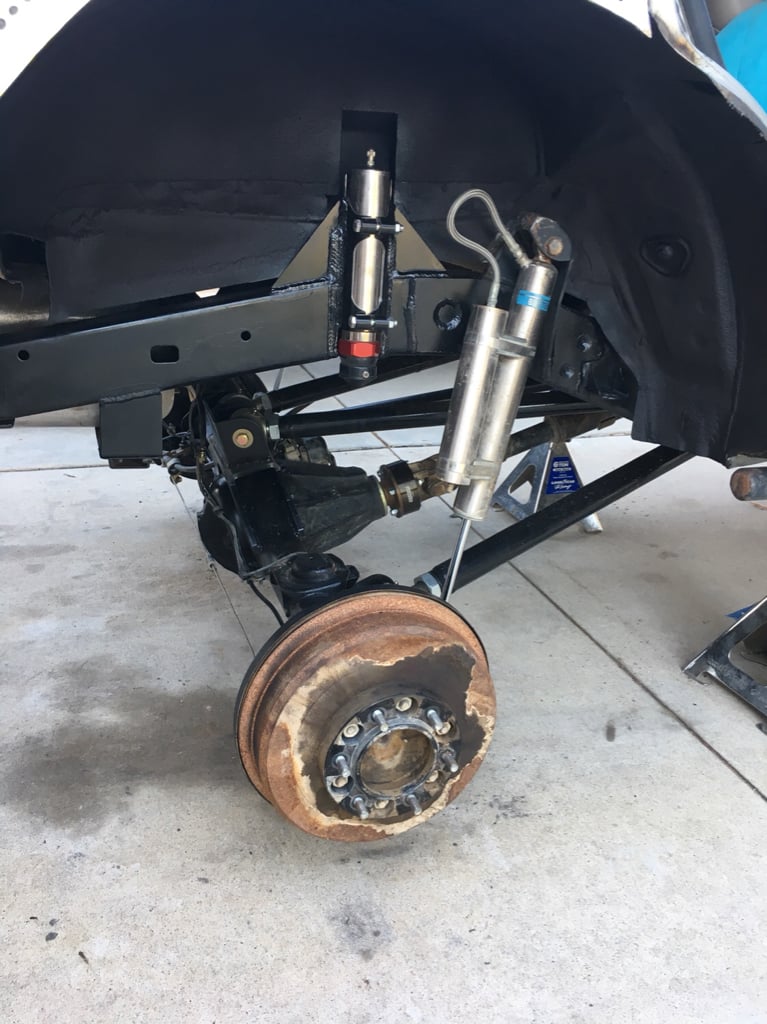

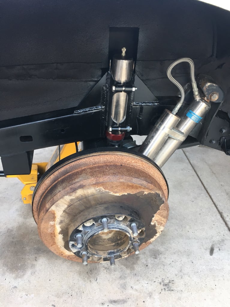

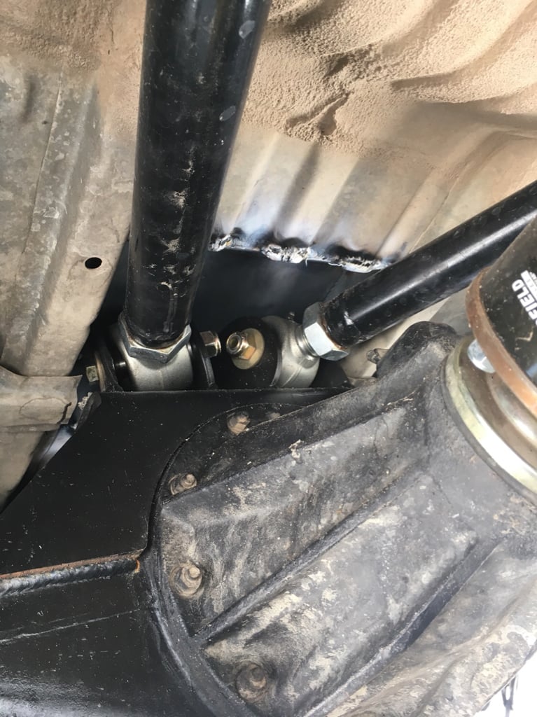

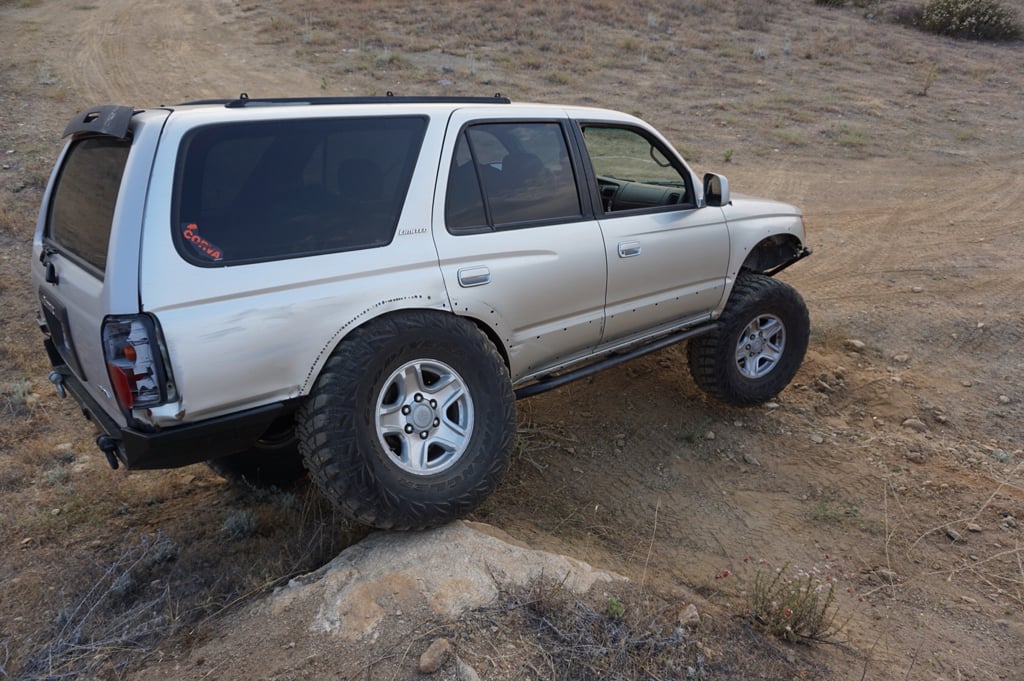

Got pretty much everything buttoned up now. 4-link is done, along with the tubbed wheel wells and hydro bumps. Been driving it around the past couple weeks and it feels pretty good. A couple things that I noticed about the new rear suspension setup:

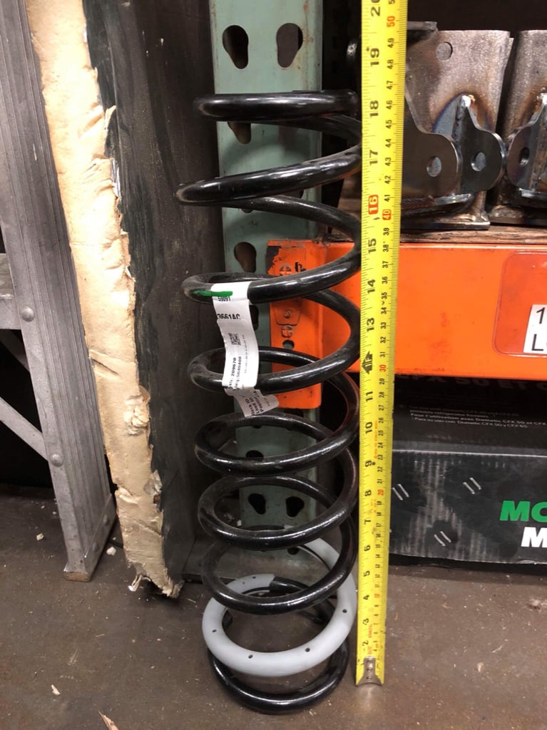

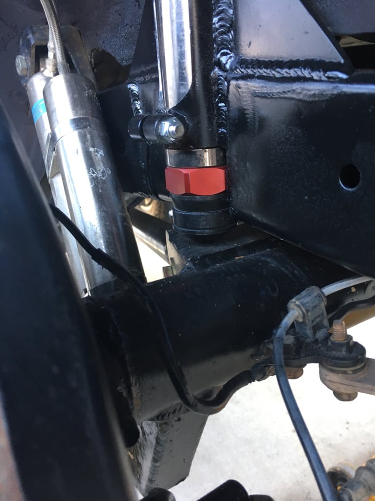

1) when I welded my coil buckets back in, I welded them in about an inch or so lower than stock. Didn’t have much of an opinion due to how the frame rails slope back down as you go further back. This resulted in a little higher ride height in the rear. Kind of a bummer since I have been wanting a lower ride height. I’m looking to find some stock Jeep JL coils to try out. They are tall enough and should be soft enough to give me around the 2” lift I want.
2) Even with the increased ride height, there is noticeably less body roll. Not anything dramatic but still noticeable. This is because I increased the Roll Center about 2” over what I had before. Once I lower my ride height, it’ll be nice.
3) At about 100% anti-squat, there is no squat when accelerating. Personally, I don’t like that part. Once I lower my ride height a couple inches, the A/S should go down a little bit (not as much as I’d like but better than nothing). To me, stock setup was pretty nice with about 70% Anti-Squat. If there were an easier way to lower that number for me without decreasing ground clearance, I would.
4) No Roll Oversteer! This was a big one for me. Ever notice when you corner, that you have to countersteer as the body rolls? That’s roll steer, and it’s super sketchy and annoying. Now I actually have a tiny bit of roll understeer. Super weird to get used to but it’s super predictable in the corners now. I still find myself anticipating countersteering as I go into corners, but realize I don’t have to anymore. Super nice!
5) Up travel and hydro bumps. Wow! Hydro bumps are super awesome! I used to have those 4-1/2” daystar bumps that gave about 2.5” of compression, but you still felt it ever time you made contact. Now these hydro bumps are so plush, I can’t even tell when they make contact. Up travel is awesome too. I tried to jump and only came within about 2” of full bump. It’s nice to be able to hit some hard stuff and not bottom out all the time, even with soft suspension. Right now I have just a hair under 9” of up travel at ride height. Once I lower the rear to where I want, I should be at around 7”. I think that 50/50 ratio with up/down travel will be perfect.

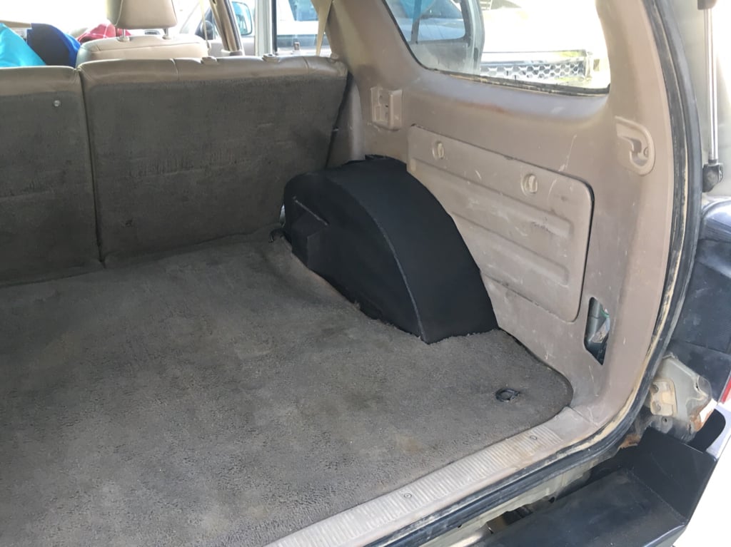

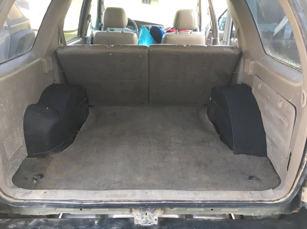

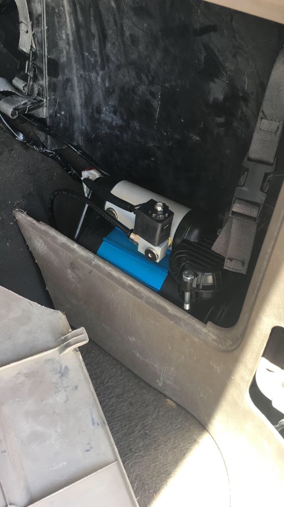

Next thing was the air compressor. I installed that in the rear cargo cubby. Pretty straight forward except having to extend all the wiring. Nothing hard, just time consuming. Especially trying to solder 8-10 gauge wiring with a soldering iron that can’t stay hot enough to do so. It looks boogery but it’ll be fine. Got all the switches wired up everything works.

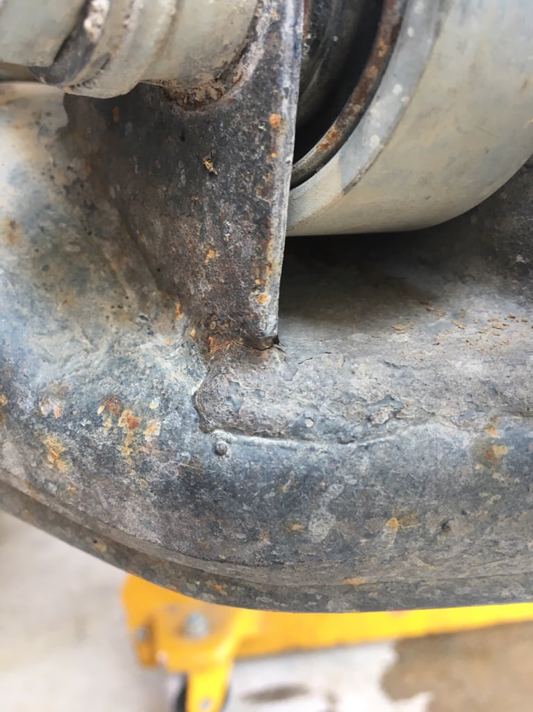

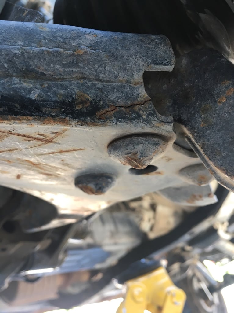

Also found some cracks in my LCA. It’ll get replaced after my trip. As long as I’m not jumping, it’ll be fine.

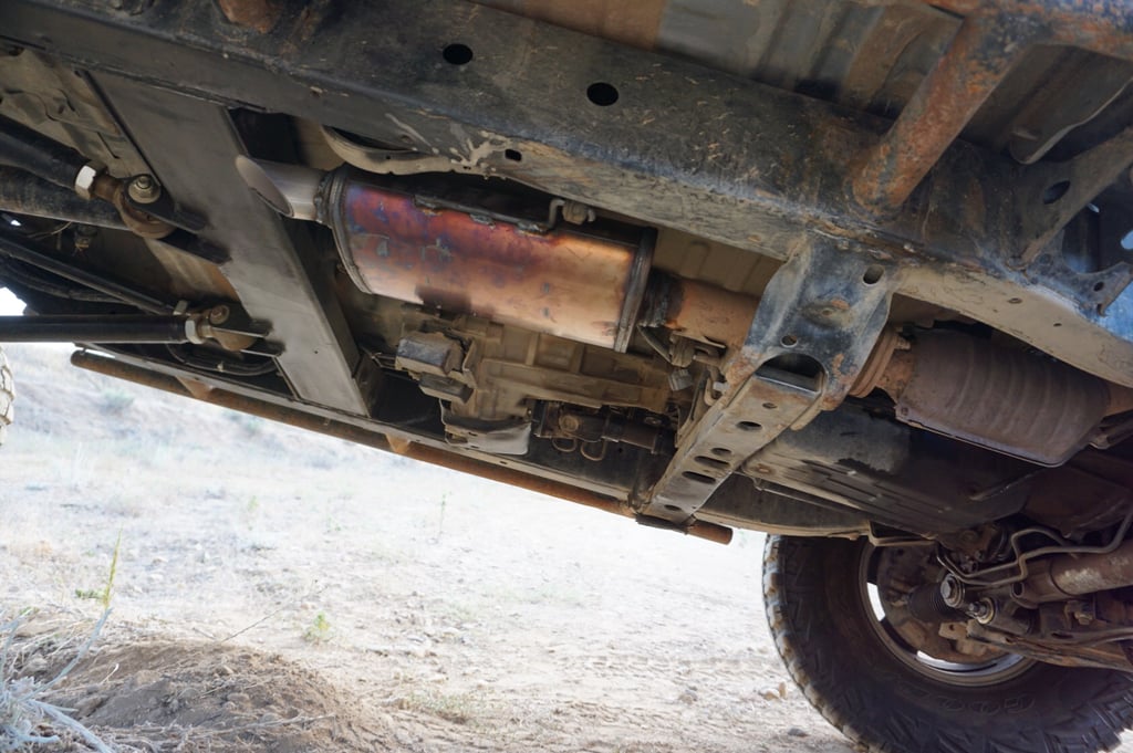

New muffler. I wish it was super quiet, but that’s all I could fit in that spot. I despise loud exhausts on 99% of vehicles.

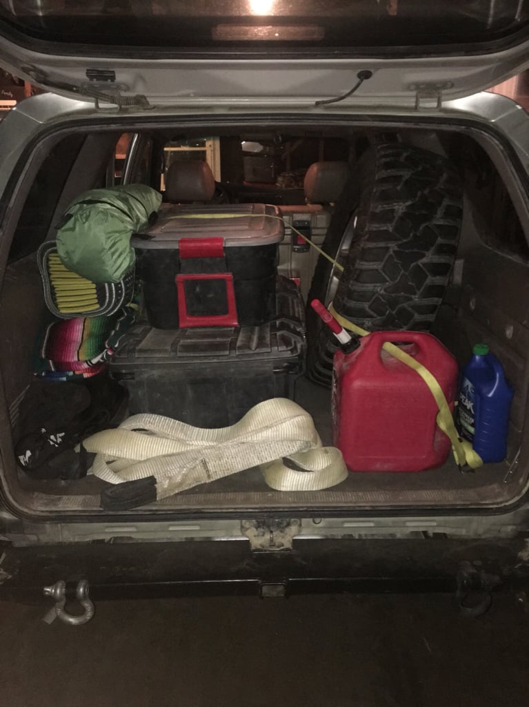

I get off work, haul ass home and finish packing the last minute stuff, drop of the kids at my parents, get gas and more ice, then hit the road by about 7pm. Right on time. Drive the 7 hours up to Courtright Reservoir and attempt to find the group at 2AM. After a few circles around all the campsites, Andy heard me and turned on all his truck lights for me to spot out in the distance. Everyone was asleep at this point so my wife and I each cracked open a beer a decided we need to get some rest. We both didn’t want to setup a tent, so we set the way for the rest of the trip by sleeping under the stars. This was way better than sleeping in a tent, and to have my wife be on the same page was pretty awesome.
Truck mostly packed besides clothes bags and some food. I figure I had maybe 700lbs in total? It was a lot and my motor definitely felt it.

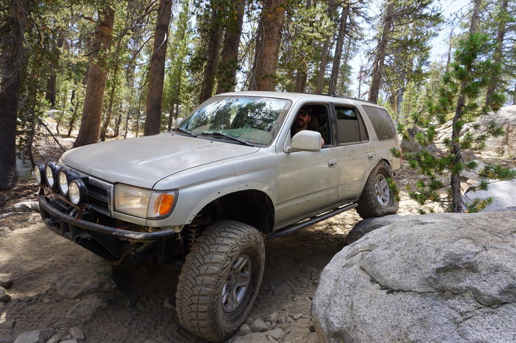

Woke up this morning and said some hellos to my Tacoma buddies that I've wheeled with before, and got to meet [MENTION=143526]theesotericone[/MENTION] for the first time.
[MENTION=135317]rkntoy[/MENTION] met up with us in the morning at our campsite (Voyager Rock Campground) at about 9am. We chatted for a bit while getting everything together and was on the trail by about 10am. We heard it’s important to get an early start because the next Campground was 8 Miles away at the top of Thompson Hill. We were also told don’t underestimate Thompson Hill. First obstacle was Chicken Rock. This wasn’t hard by any means, but it was an extremely steep granite slab that is maybe a hundred yards long. A lot can go wrong quickly if there is a problem on that hill. We all made it up no problem.

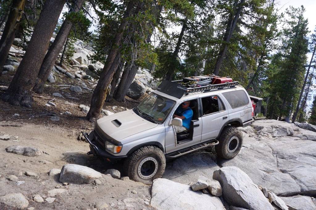

From here there are plenty of obstacles, but nothing super difficult as long as you pay attention to your lines. This section got us thinking that we were going to make camp way earlier than we expected, but we were definitely underestimating Thompson Hill. This hill is about a mile long of steep loose climbs with large boulders and ledges all the way up the hill. We started up it taking our time and one obstacle at a time. Eventually we all had some spots that were tough, and would need some rock stacking (Even with everyone being dual locked). I really got to put the front locker to the test here, and boy is it nice to be able to flip the switch and keep climbing. After a ways up, [MENTION=143526]theesotericone[/MENTION] broke a CV. It was kind of a shitty spot to try to fix it, and we thought we were close to the top, so he decided to try to limp it in 3wd up to the top. Well that was definitely not our best judgment. After another little ways up he was struggling again to get up an obstacle, so we go look and it the other CV was broken now. He was trying to get up a loose ledge in 2wd. Not happening. So instead of breaking more shit, and knowing we were very close to the top at this point, we hooked up the strap and I pulled him to the top of the hill. Luckily we were past the worst of the obstacles on this hill, but it still wasn’t any walk in the park to get up. Once at the top, we were only about a 1/4 mile to camp, so we decided to fix it there since it was getting later in the afternoon, and we were all pretty beat. Camp this night was at Thompson Lake. We all just relaxed for a bit, ate some dinner, then [MENTION=143526]theesotericone[/MENTION] and [MENTION=135317]rkntoy[/MENTION] fixed the CV axles while the rest of us proceeded to relax and drink some beers around the campfire. I was wearing sandals all day on the trail, and I jabbed my toe into a sharp stick earlier in the day causing a nice little hole in the front of my big toe. I just walked it off and let the dirt wash the blood away. Well later that night when we were hanging around the campfire, I noticed something looked funny on my toe, so I looked and sure enough, I still had a small piece of that stick still in my toe. I was walking around for hours like this and didn’t even notice! I wish I got some pictures of it.

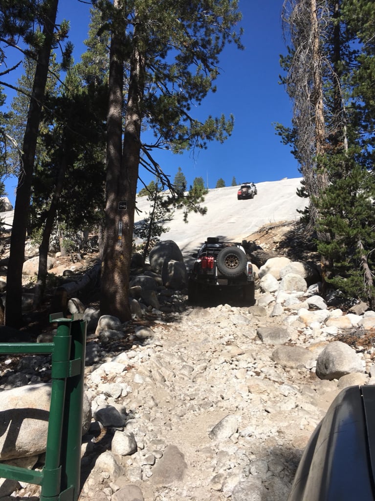

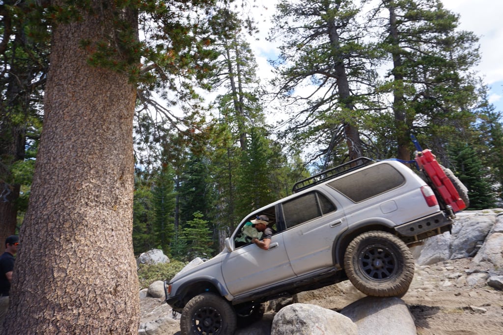

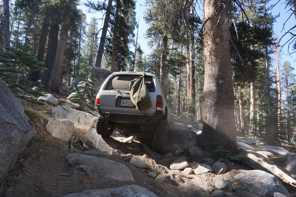

Chicken Rock. Pictures do not do this justice on how steep it is.
The forest is dense right here
Some bridge we crossed, I think on the first day.
Some big dome of granite

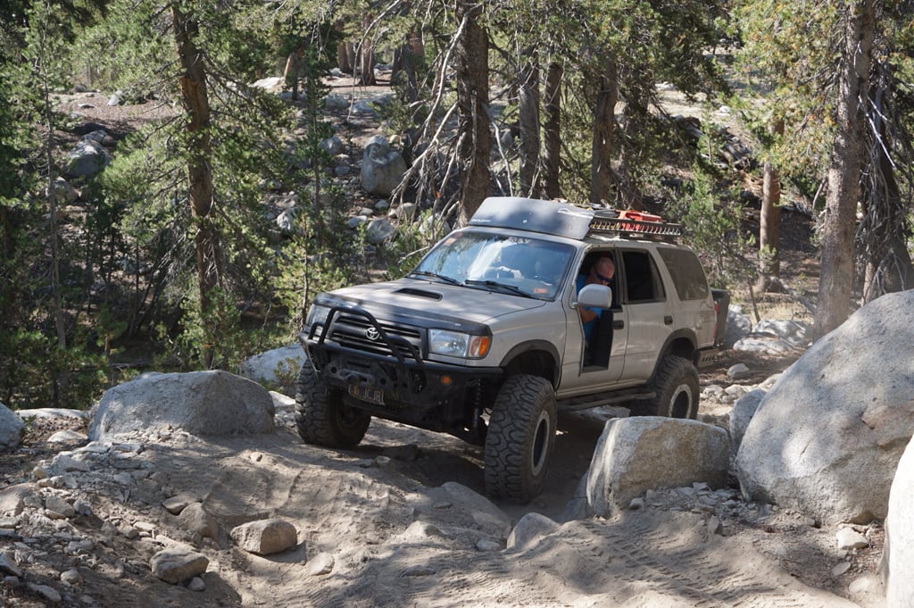

[MENTION=135317]rkntoy[/MENTION] motoring on up the hill with his 37’s and dual cases

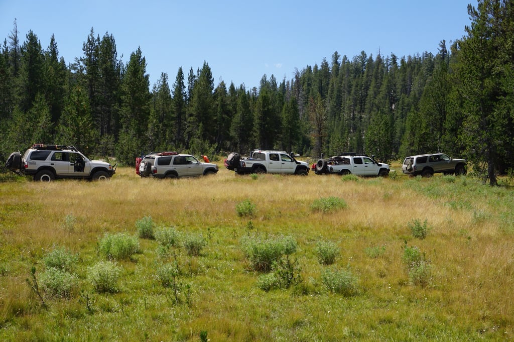

Camp for the first day

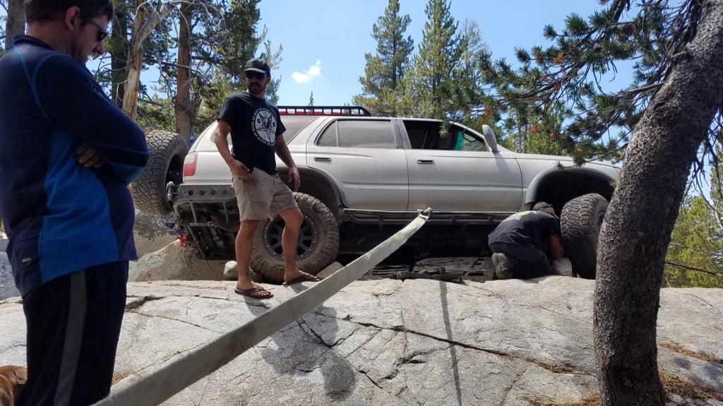

So a couple lessons we learned that day were:

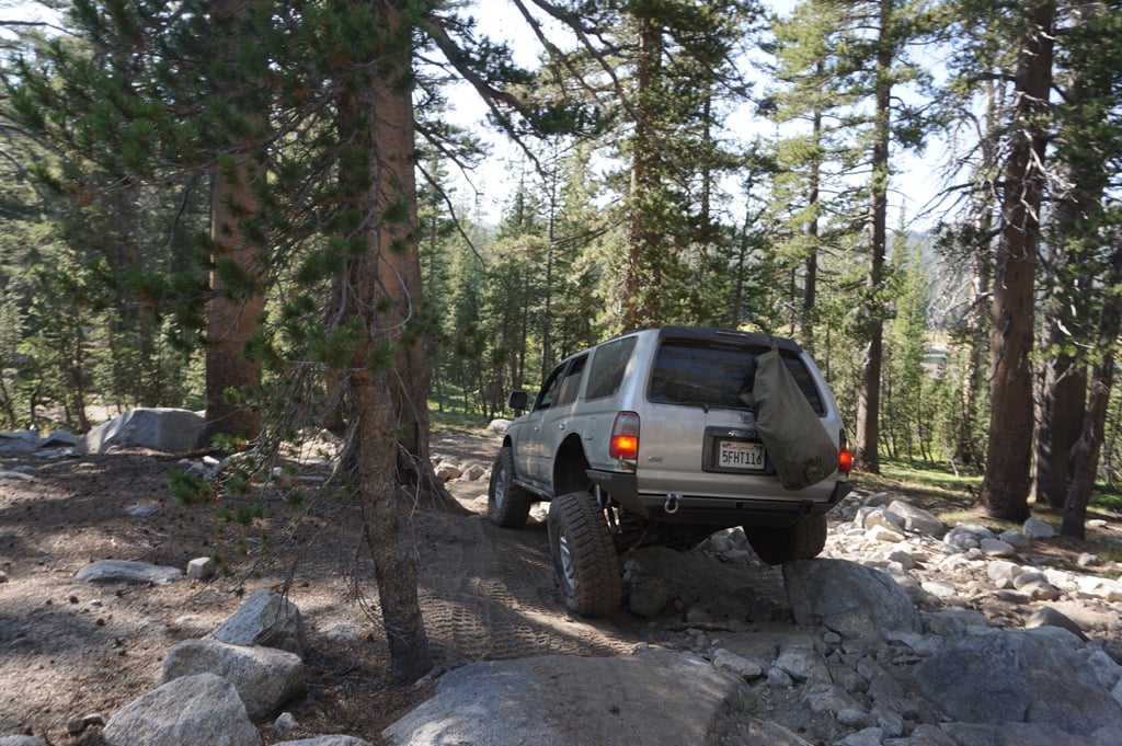

1) Don’t underestimate Thompson Hill. It can end up being half of your day.
2) If you break something, fix it! Don’t try to limp it further. Especially on Thompson Hill.
