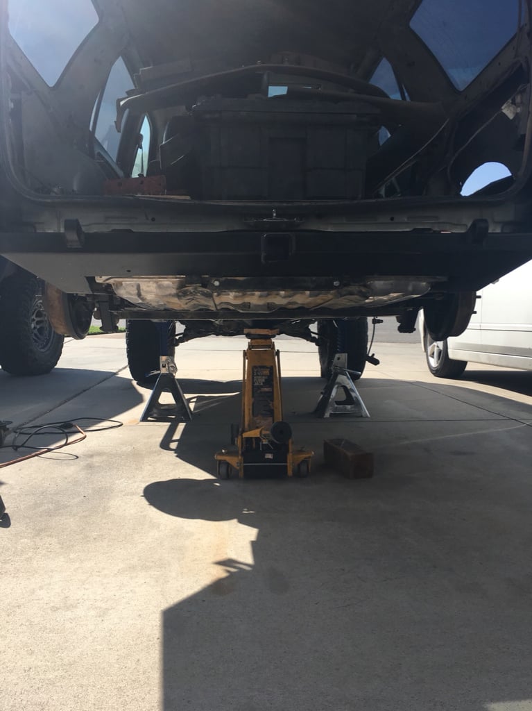

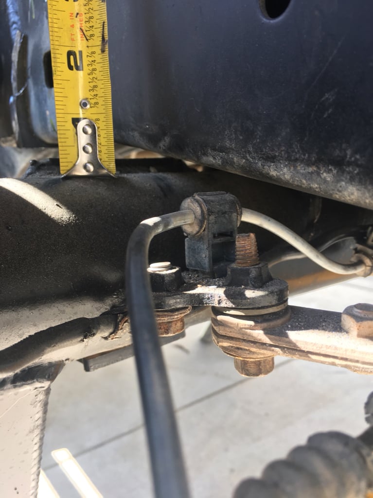

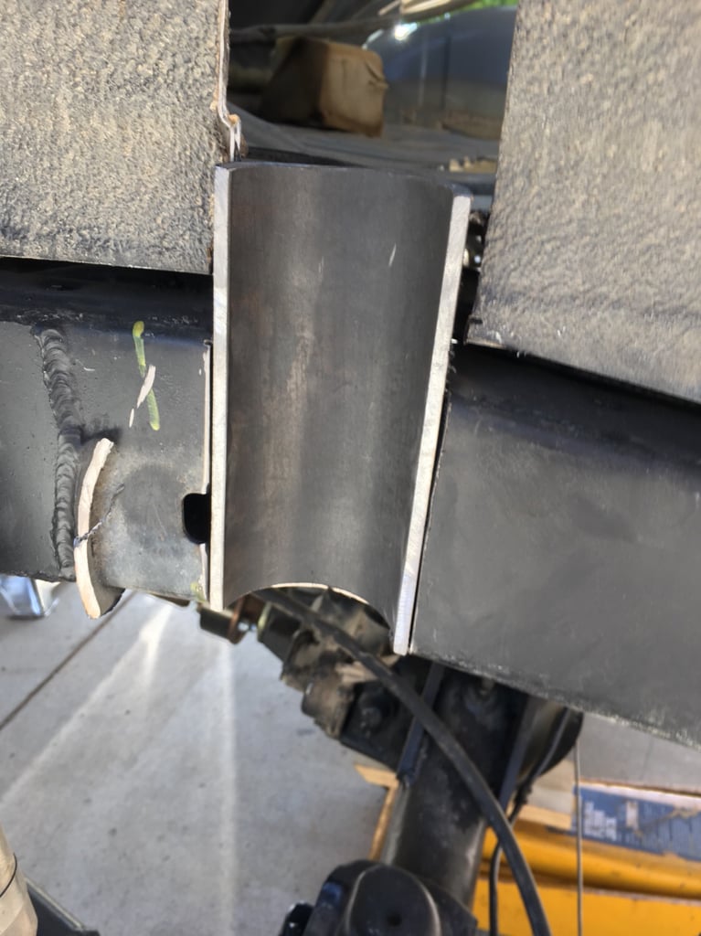

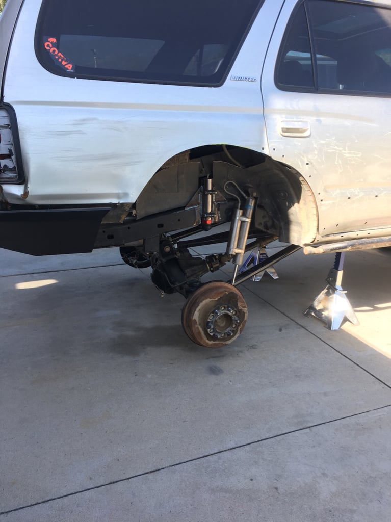

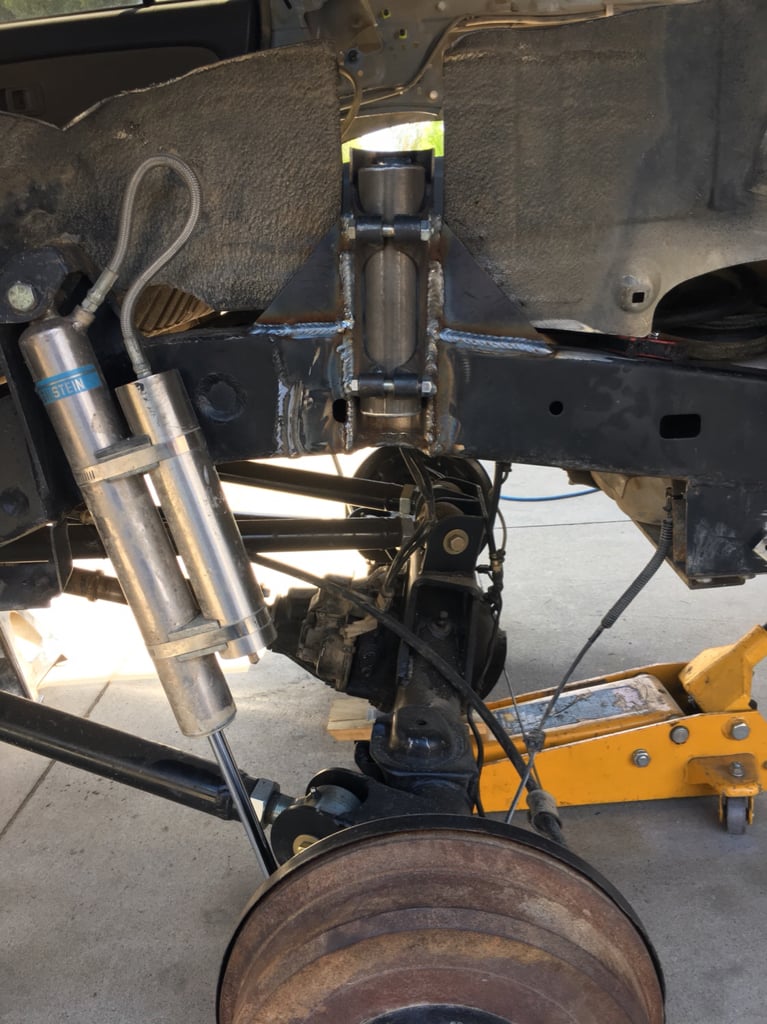

Shocks completely bottomed out at 1/2” below the frame rails. Bump stops are set for about 1/2” below that for obvious reasons.
Where did my axle go?!

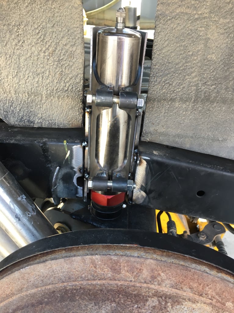

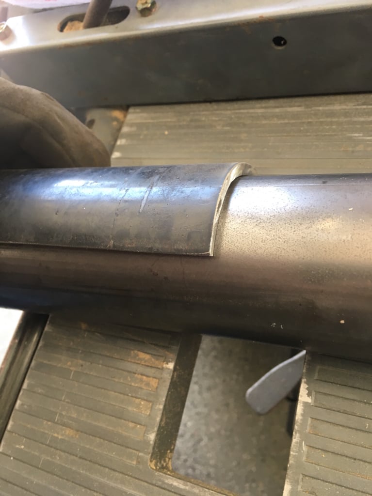

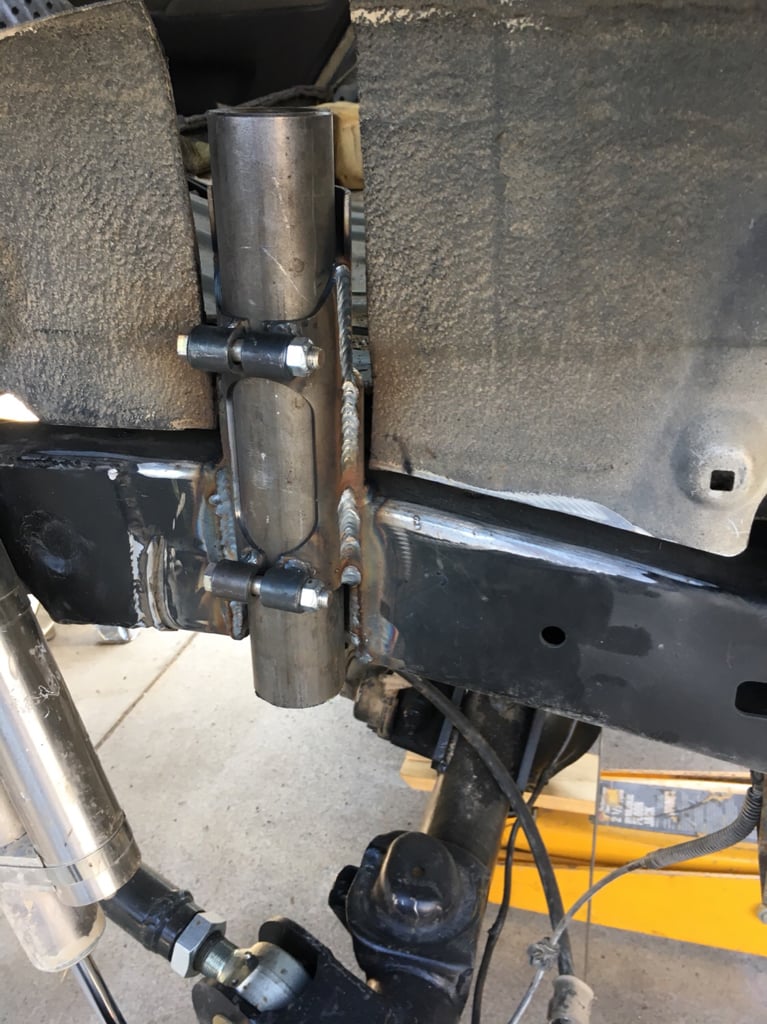

The 2.5” ID pipe over the 2.5” OD tubing
Welding them in with a piece of 2.0” x .250” Tubing to keep the cans from warping.
Some gussets to help keep the frame strength.
Finished product one the other side.

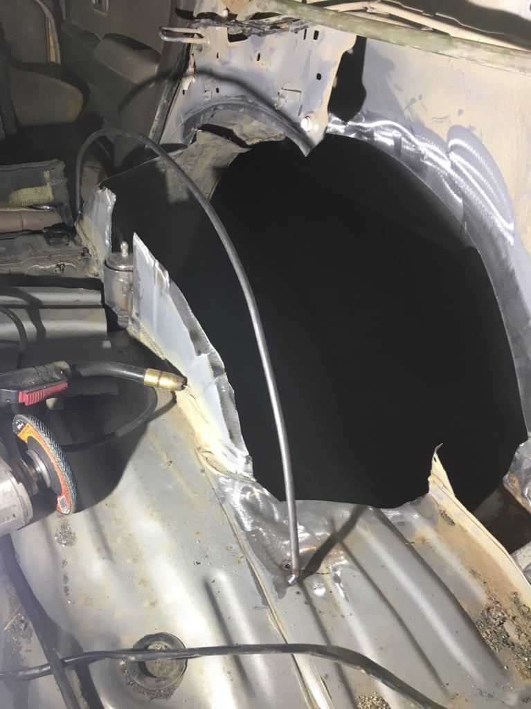

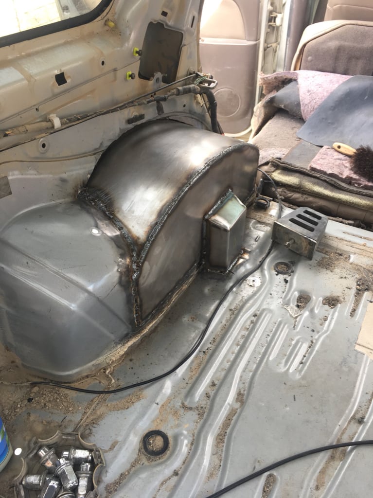

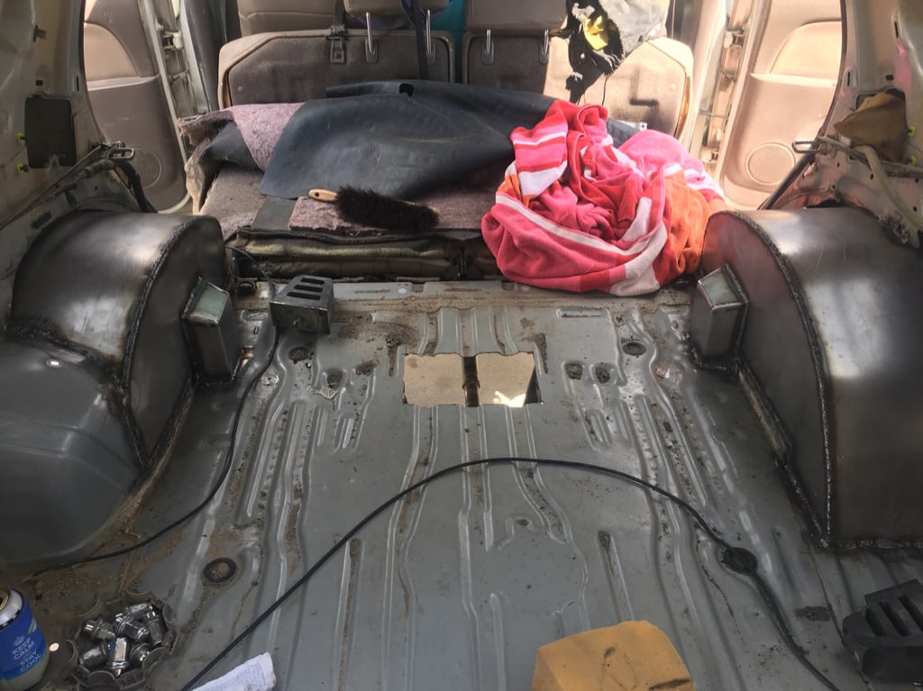

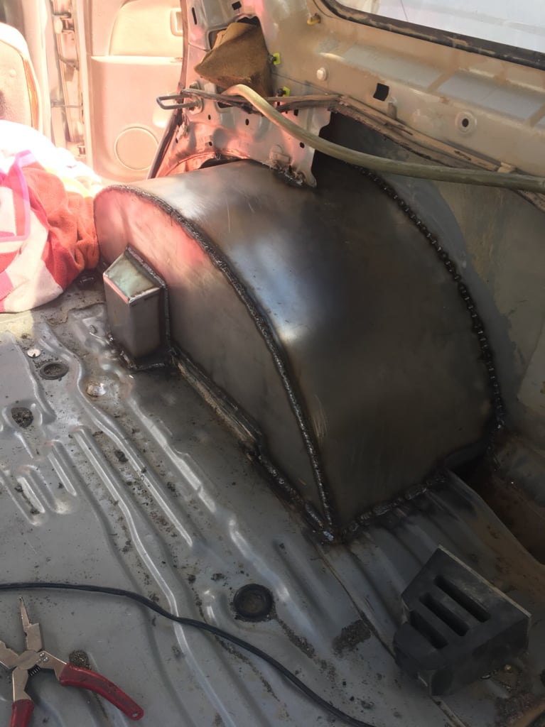

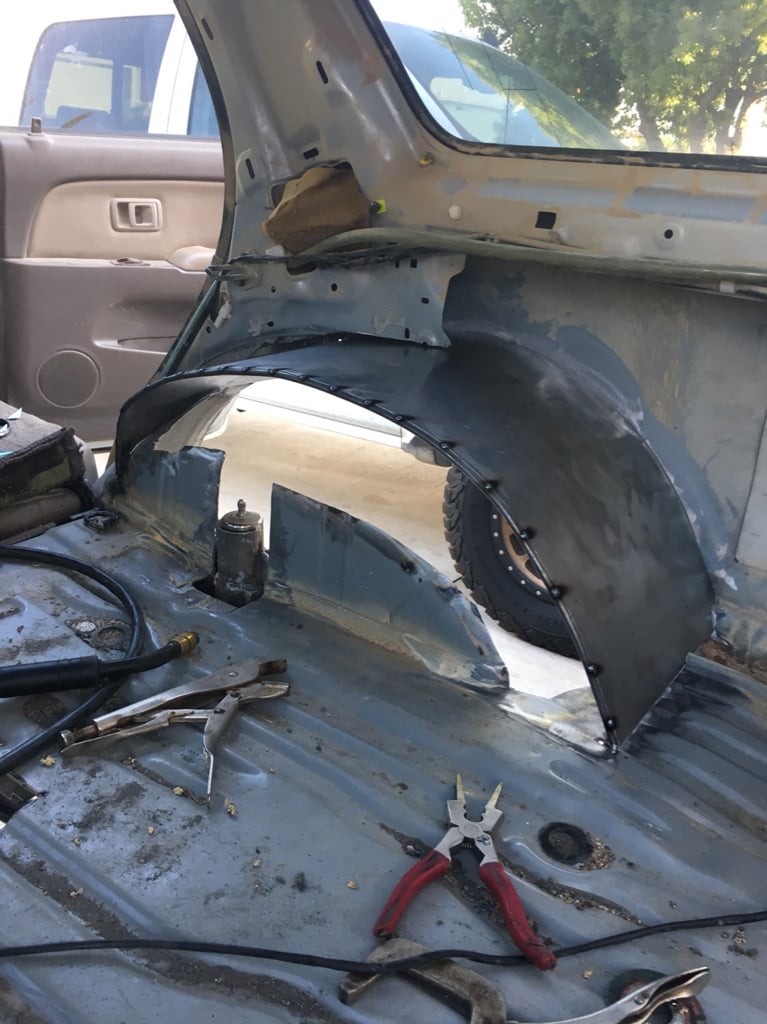

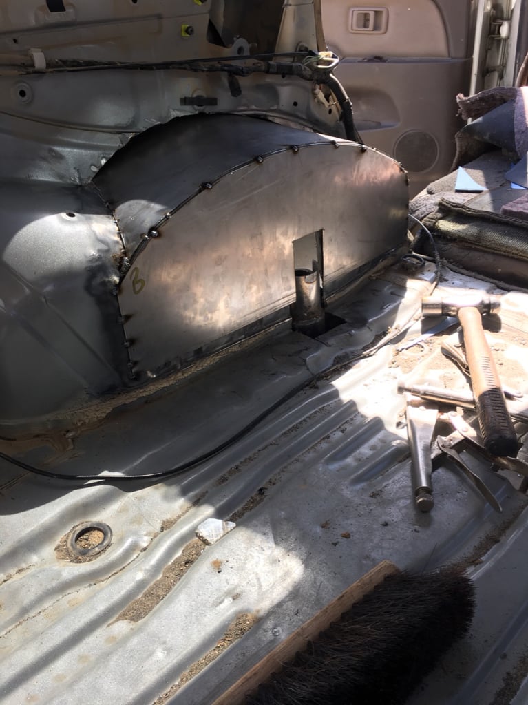

Made some more progress on the wheel wells this weekend. It was a long weekend with this crazy weather. Friday was like 114° during the day. Luckily I didn’t have to work in that heat because I luckily work in an air conditioned office, but by the time I got working on the rig, it cooled down to a nice 106°. By the time I was done working on things at 10 pm it was barely under 100. Great weather to the start of a long weekend. It didn’t end there though. I woke up Saturday and it was already blazing in the early AM. By 12:30 it was 110° but thunderclouds started to roll in quickly with projected storms. So I cleaned up and pulled the welder in, swept all the metal off the floor and called it a day. It ended up only sprinkling on and off for a couple hours, so we ended up cruising over to my parents and cooled off in the pool. Today was just hot all day. Miserable but not having things done has been worse, so working in the rig was what I was doing. Now enough about the shitty weird weather. I’ll keep it short and simple.
Friday I got off work and started working on the drivers side wheel well. I started with the 5/16” rod to frame the shape of things. Easy peasy. Next was the actual sheet metal. All was going great, I took some measurements, traced some paper as templates, cut some metal and test fitted. Looked like I didn’t cut enough. Cut some more. Still didn’t fit right. Cut some more of the body to get things to fit right. Realized I cut too much. Tossed the piece in the scrap bin. Called it quits for the night and proceeded to drink many beers on the sidewalk and watch the local forest fire with a pair of binoculars.

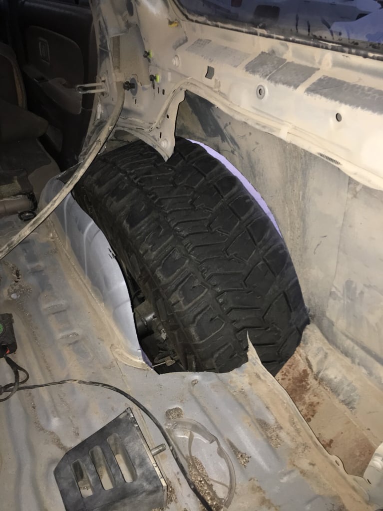

Saturday woke up early with a clear mind. Already hot as hell. Looked at the big hole and came up with an idea to use the piece I cut about a 1/2” too short. I was able cut and bend a piece of the existing wheel well up to fill the gap cleanly. Easy peasy. Immediately ran out of welding gas. Good timing because the welding supply closes by noon. Refill my tank, pick up some cut off wheels, and new welding gloves. Back to work. Get back to welding and fitting things. Storm rolls in. Call it a day.

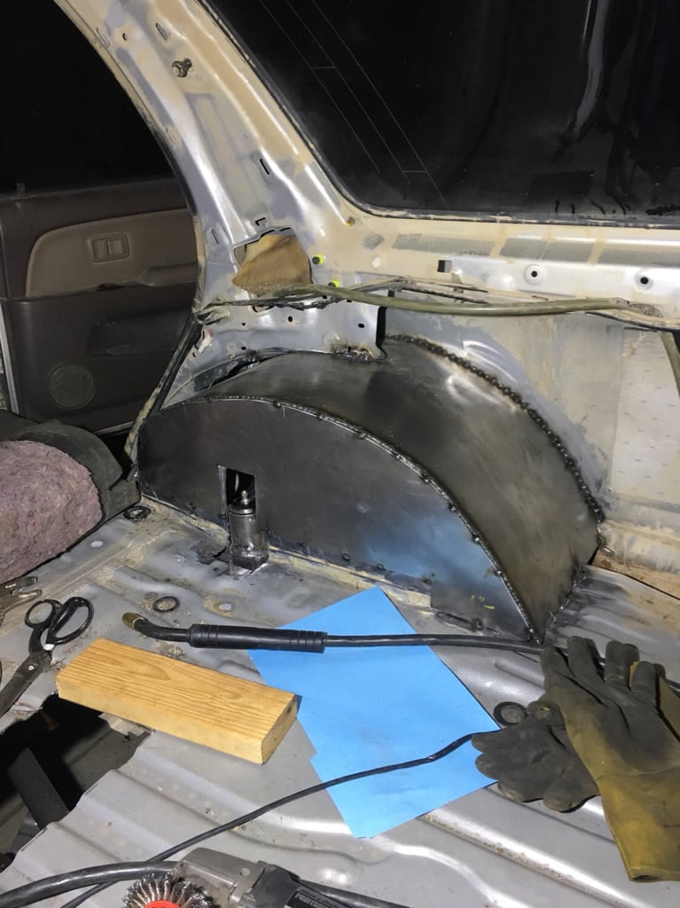

Sunday. Got another early start and helped a buddy weld some mounting nuts for the skid plate that he ripped the bolts out of last weekend. Done in 30 minutes. Back to more sheet metal work. Today I had no major issues and was productive all day without any distractions or hiccups. Finished the actual tubbing of the wheel wells and covers for the holes from the new bump stops. What a relief!
Now I gotta patch the hole in the floor and undercoat & paint everything. Still gotta trim the plastic panels to fit around the new wheel wells, bleed brakes, tighten link jam nuts, replace fuel pump, hit the desert (hopefully).
