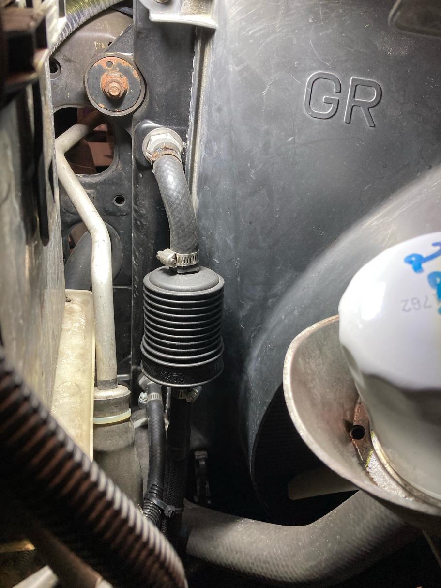

Yes, you cut out about 3” of hose and hose clamp it in place. To make it easy to replace in the future, I install it in the top radiator cooler hose before the elbow. ATF flows from trans->upper radiator port->lower radiator port->back to transmission.
Side note: there are two steel ATF cooler lines at the bottom on the radiator. Mine had nearly rusted through on the drivers side. So I cut the rusted section off and slipped the ATF hose over the cut end and hose clamped it in place. There is very little pressure in this hose, but I would suggest a worm gear hose clamp for security.

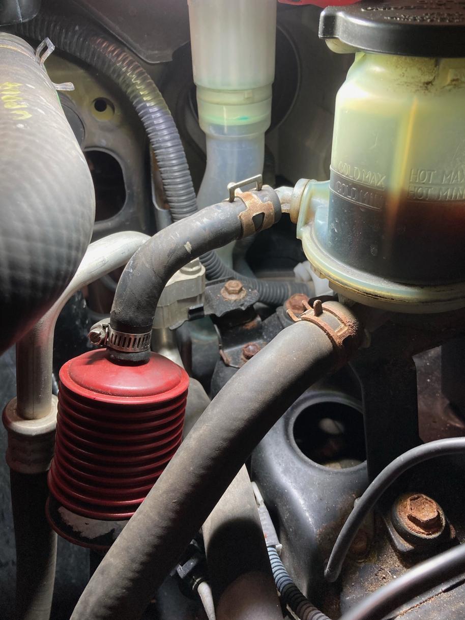

I also add one to my power steering fluid.

What I do when I get a used vehicle is replace all the ATF and most importantly add a MAGNEFINE 3/8” filter and ATF cooler. The filter will catch any old crud released by the new ATF and prevent it from causing future damage. Check out what these filters caught on my other vehicles.
The magnefine filter has a strong magnet to catch ferrous material, then filters the fluid with a paper filter to catch non-ferrous material. I leave it in 50,000 miles and it costs just $25. Well worth the money and effort to install. I have never had a tranny failure. My last car was a Lexus IS300 2001 I bought with 96,000 miles. I just sold it with 286,000 miles and the trans shifted like new still.

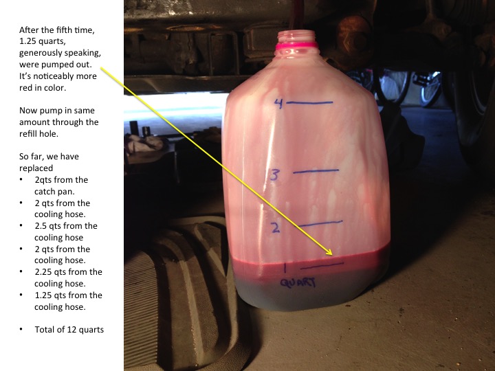

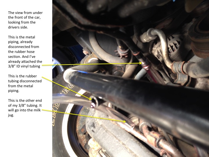

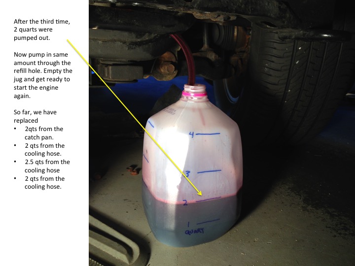

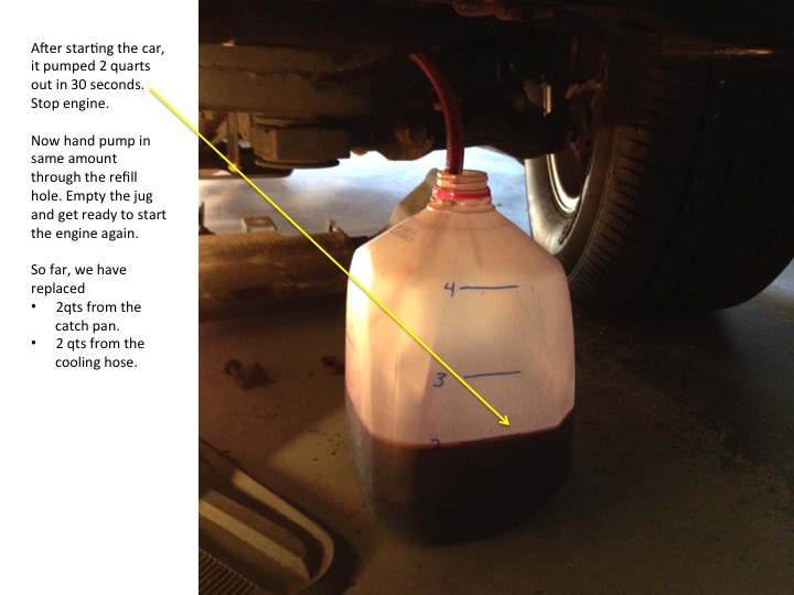

10. Attach the 3/8" clear tubing to the metal pipe at the connection you just removed, and route the other end of the clear tubing into the milk jug.
11. Start car, and it will pump ATF out into the jug at about 1 qt every 15 seconds. Shut engine after 2 qts have been pumped out.

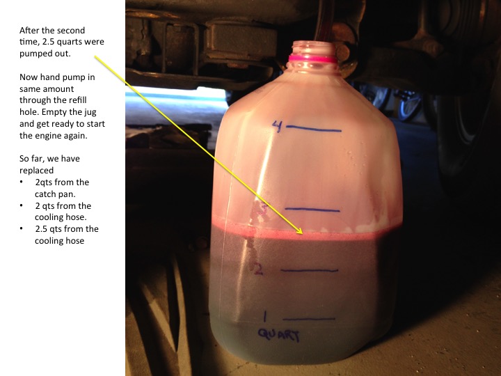

12. Hand pump in 2 qts (or the amount that came out) through the refill hole, and empty the milk jug.
13. Start car, cycle through all the gears. This time 2.5 qts were pumped out when I stopped the engine.
14. Hand pump in 2.5 qts (or the amount that came out) through the refill hole, and empty the milk jug.

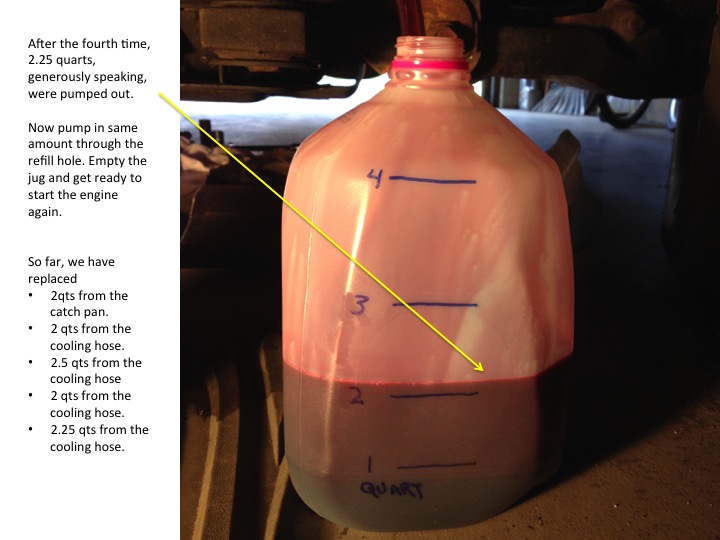

15. Start car, stop after 2 qts have been pumped out
16. Hand pump in 2 qts (or the amount that came out) through the refill hole, and empty the milk jug
17. Start car, stop after ~2 qts have been pumped out
18. Hand pump in through the refill hole the amount that came out, and empty the milk jug
19. Start car, stop after 1.25 qts pumped out. I wanted to get 12 quarts in there
20. Hand pump in through the refill hole the amount that came out, and empty the milk jug. At this point, I've pumped in 12 quarts total.
21. Pump another half quart so you will have some fluid flow out during the Fluid Temp Check. So now I have pumped 12.5 quarts of new fluid in there.
22. Reconnect ATF line and return the hose clamp to its original position
23. Finger tighten fill plug
