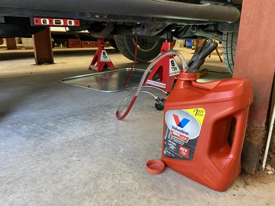

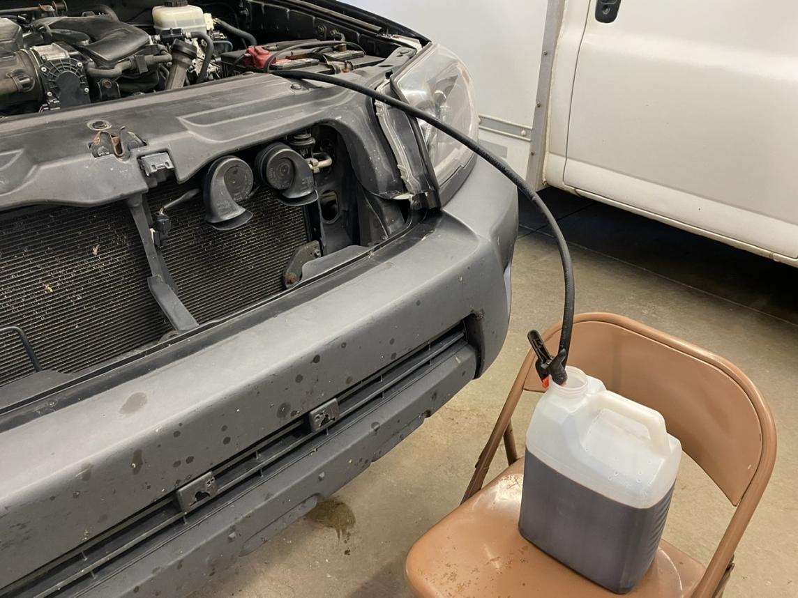

Did this today, utilizing the experience of many others in this thread. Gravity filled using a rig I made with a skinny funnel and 3/8 vinyl tubing. Didn't drain the pan as I didn't have a way to measure, just pulled the line at the trans cooler at the front of the radiator. 2 quarts at a time, before I even got to 11 quarts I was getting much better looking fluid and the final 2 (I did 12.5) came out looking brand new by the end.
I think it shifts better, I dunno for sure. It's ridden a couple of hundred miles on the road and a few miles on rocks and is still gold so I assume it's G2G.
I used authentic WS fluid. I believe in using the product that the transmission was engineered to use. No hate towards anyone who feels otherwise.
Thank you very much for this. I have never owned let alone serviced an automatic. It all went well, start and stop every 2 quarts.
The only snag came at the end, I really don't like this "wait until it slows to a trickle" method Toyota devised after too much sake - what was wrong with a dipstick.
I forgot to put a fresh washer on the level check plug, had to take it out again, and I lost about 300ml of fluid. The engine was off so I assume it settles back into the oil pan when that happens. Not happy with that.

Successfully completed this fluid exchange this past weekend. I used about 12 quarts to complete the exchange. I did the process by using the trans cooler lines that come up to the radiator and filling through the fill port on the trans. The process was very easy once everything was set up to collect and fill fluid.
I used Valvoline ATF. There was a noticeable difference on the first drive after completion. I recently did a pan drop/filter change and filled with OEM Toyota WS fluid, after that service I had a noticeable increase in “judder” at low RPM and light throttle. After this service exchanging for Valvoline synthetic ATF that “judder” is completely gone. After all that was done I installed a Magnefine filter to help filter the fluid since the “filter” in the pan isn’t much of a filter. I have my Scangauge hooked up to monitor temperatures going forward.
Thank you to all who have posted. Here’s another 4Runner saved and improved. I completed this with 226,000 on the clock.
