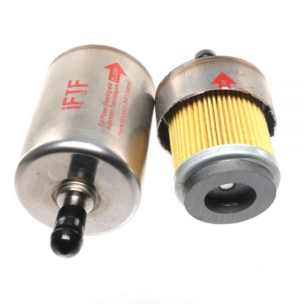

What I do when I get a used vehicle is replace all the ATF and most importantly add a MAGNEFINE 3/8” filter and ATF cooler. The filter will catch any old crud released by the new ATF and prevent it from causing future damage. Check out what these filters caught on my other vehicles.
The magnefine filter has a strong magnet to catch ferrous material, then filters the fluid with a paper filter to catch non-ferrous material. I leave it in 50,000 miles and it costs just $25. Well worth the money and effort to install. I have never had a tranny failure. My last car was a Lexus IS300 2001 I bought with 96,000 miles. I just sold it with 286,000 miles and the trans shifted like new still.

On my 07 4runner I just replaced all the ATF with 10 Qts Amsoil synthetic. And added a cooler and filter. Runs great at 223,000 miles, shifts like new, better than when I bought last summer.
The filter is the key IMHO
I do my own basic work on my cars, but this will be my first auto. (Not as common over here)
Where in the fluid 'circuit' would this be added and is it as simple as slipping a pipe off and adding this filter?
Cheers
