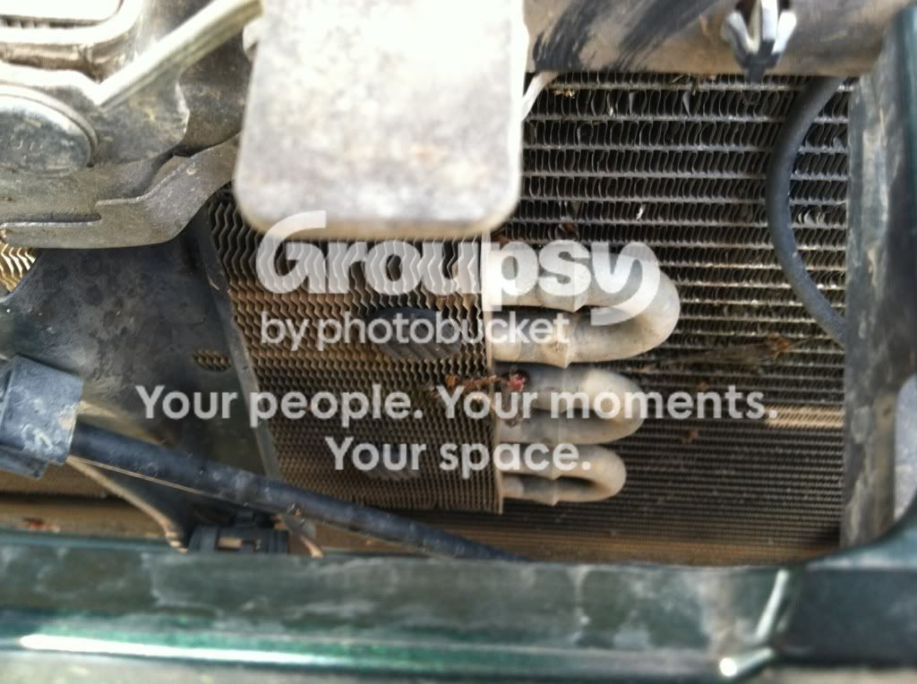

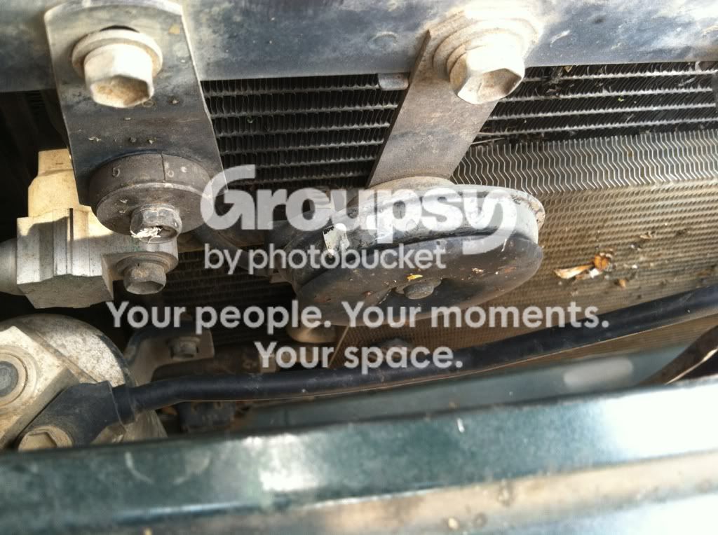

Thanks Drcoffee. Here is my current trans cooler, I have no idea what brand or model it is.
