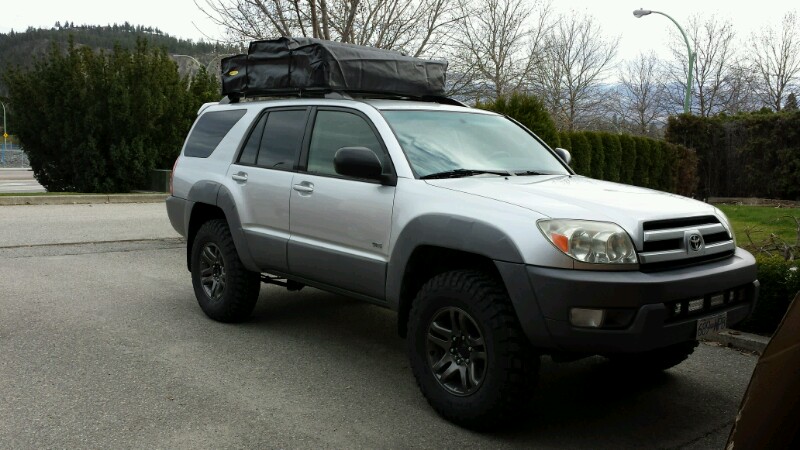

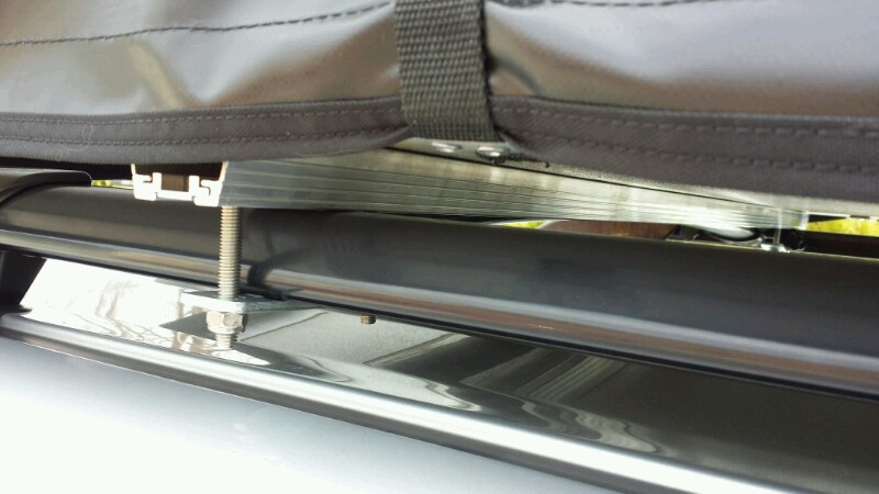

Not familiar with the differences between the sport rack and my sr5 one, but I ended up mounting our RTT to the factory side rails. There is just enough height to clear the cross bars without having to remove them, and the rails are more than strong enough.
Keep in mind you will probably have to assemble the tent when you pick it up (bolt on the mounting rails and ladder), as well as trim the tent mounting rails to length if you are mounting it to the rails and not the crossbars. (This step can be done when you get home)

Thank you for the pics! It helps to see the mounting hardware
