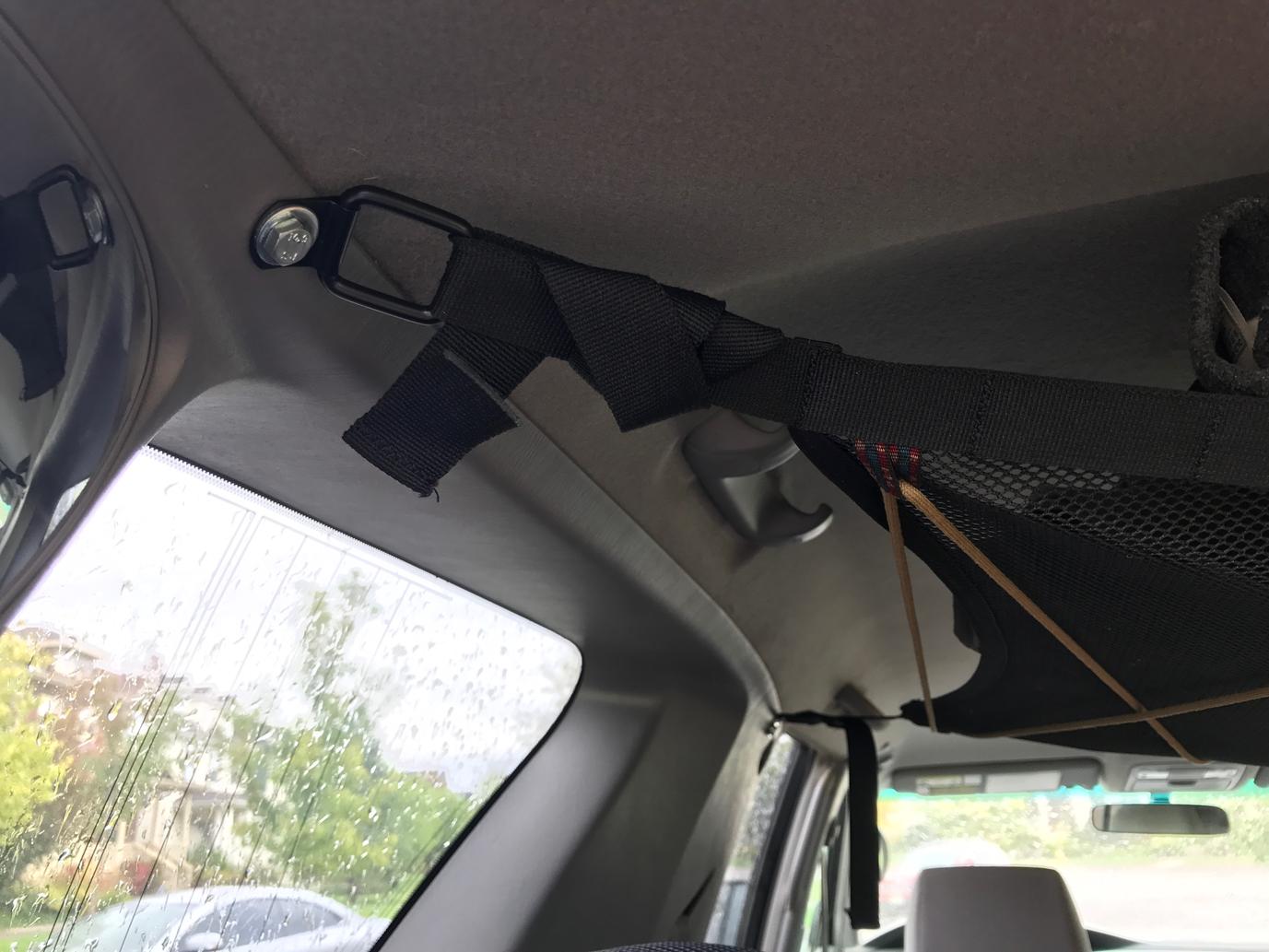

I left the rear grab handles in place for front mounts, hooked bungees onto them. The rear mounts I removed the grocery bag hooks, reused the bolts with large flat washers and hooked the bungees onto the bolts behind the flat washers. I imagine D-rings could work using the grocery bag bolts. Can't remember if I tried to keep the grocery bag hooks and hook the bungees behind them.
I bought this https://www.amazon.com/Bungee-Cords-Assortment-Extra-Strong/dp/B013U23ICQ but at Home Depot. I think I used 18" from side to side, 24" from front to rear, and 32" diagonally. Made it nice and tight.
EDIT: I finally looked at that 9 Moon kit the OP used, those mount hooks would have worked great for me using the grocerybag hook bolts, I think maybe the OP had to drill them out a bit.
Mind explaining what exactly you had to "Modify"? Just ordered my net and will be doing it this weekend.
I used the OEM bolts, rather than the ones that came with the storage net. For the rear door handle mounts, I used my knife to notch two of the black plastic pieces. Take a look at the first two or three pics in my original post.
The OEM bolts fit into the black plastic pieces, I didn't drill them out.

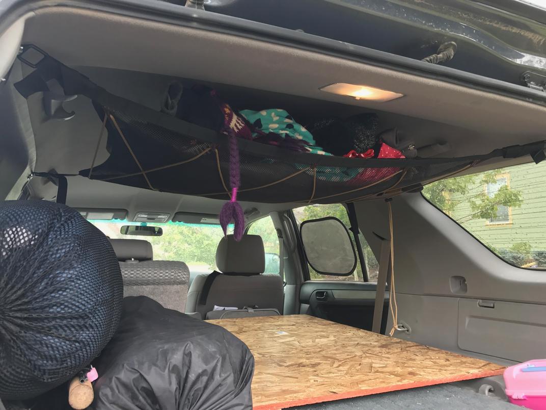

I'll get some pics later. I drilled real close to the air bag, but I think that's the only important thing. I've actually got it stretched and connected at 3 points.
These look pretty interesting but how about some pics of them loaded with whatever you carry up there.

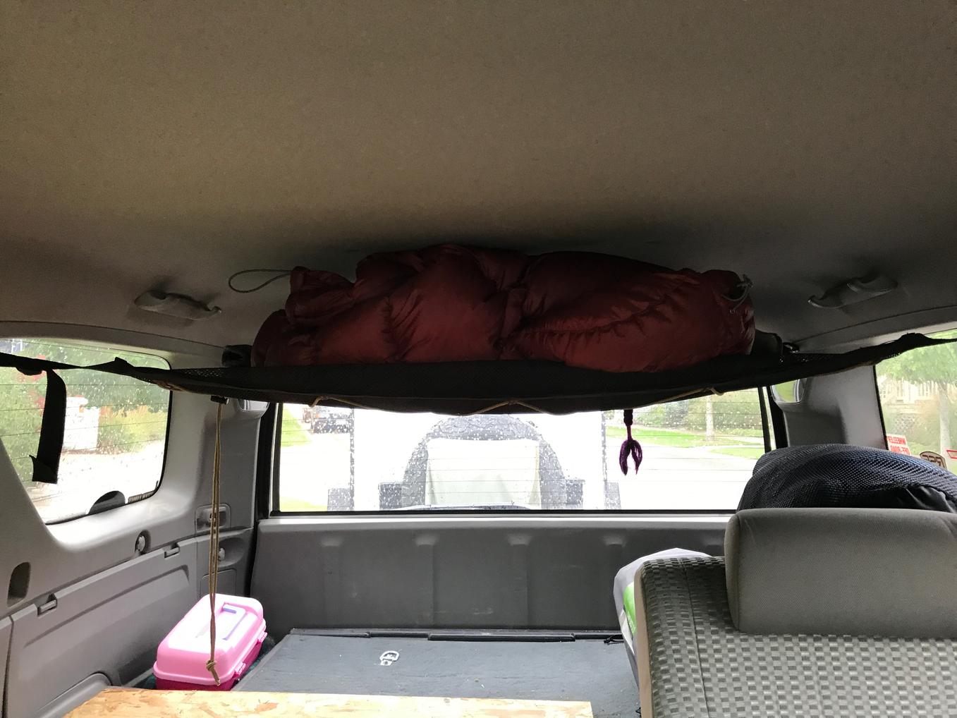

I would definitely say you need the bungie cords or something through the netting to firm it up otherwise it dips down pretty good. I tried a couple pillows and it was crazy low.
This weekend I had some clothes up there and found I would need extra bungee cords. So I bought a few more today.
One by the mirror, one by the airbag, one tied to the handle over the rear passenger.

Thanks for the pics! I got some M6 machine screws and nylock nuts from Home Depot this morning, drilled holes just through the plastic trim, and attached the D-Rings to the trim. It holds real solid. Here's a few pics of it loaded up with jackets, coats, hats and gloves for 3 people. Really helps to not have all that laying on top of everything else in the cargo area. This is the Blue Ridge Overland attic for Land Cruisers, btw.

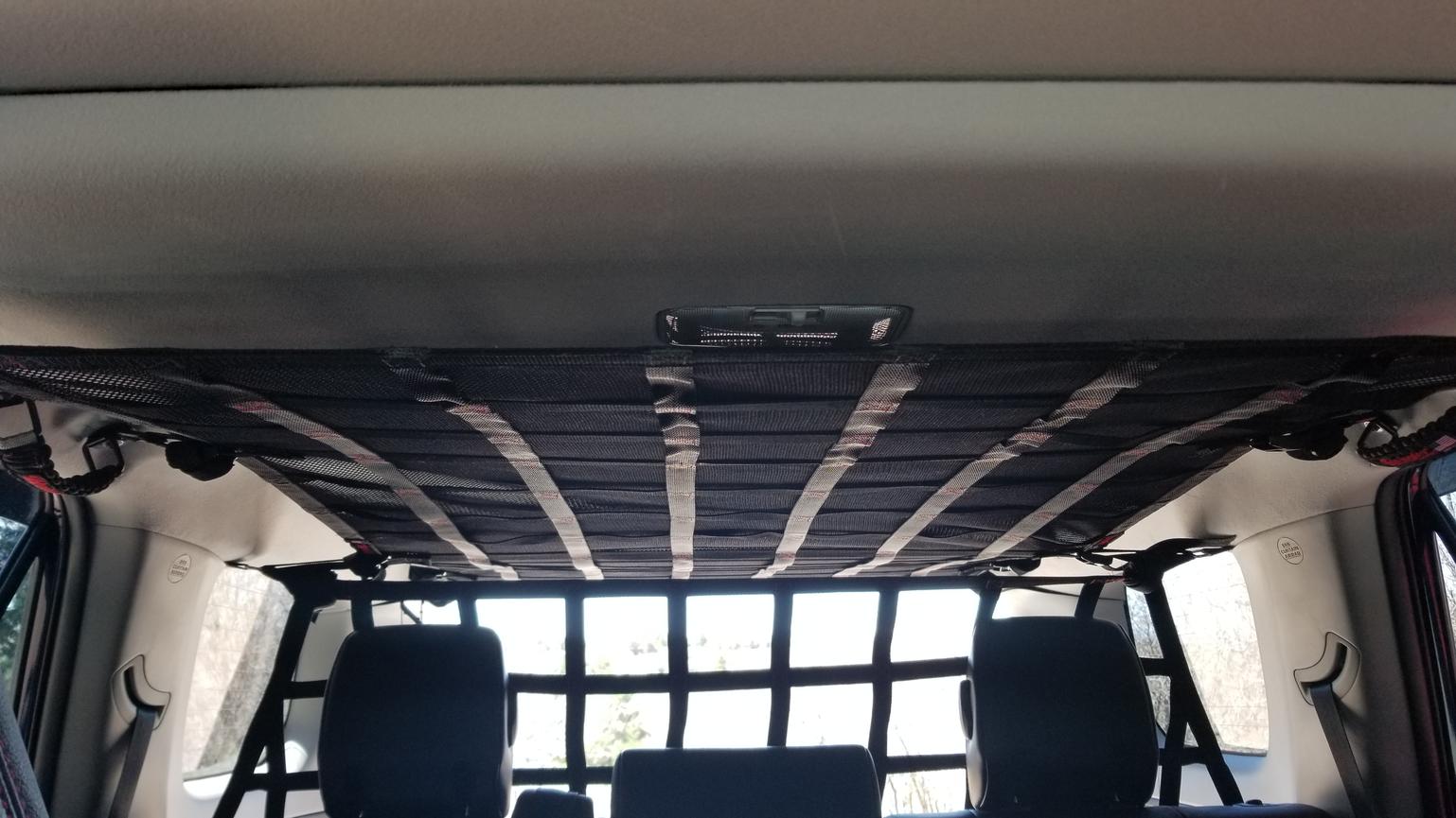

So for internal roof nets, is anyone using these? They look expensive but thiccccc.

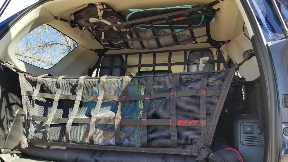

https://raingler.com/products/2003-2009-toyota-prado-full-ceiling-storage-net
https://raingler.com/products/1990-2009-toyota-2-4-gen-toyota-4runner-ceiling-storage
https://raingler.com/products/2003-2009-toyota-4th-gen-4runner-prado-rear-ceiling-storage-net
They look like $130 to $220 dollars. This guy installed one from Raingler:
https://www.youtube.com/watch?v=w6uG1mdHZR8
But even these seem to sag like 7-8 inches when fully loaded into the rear view.

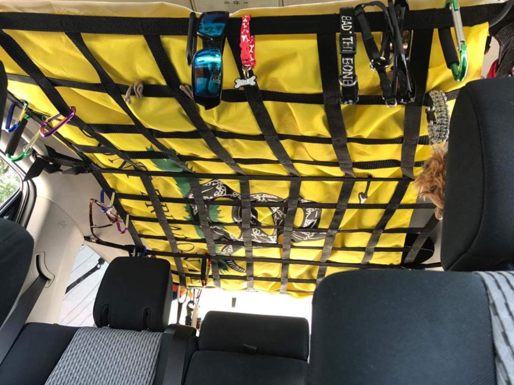

The net ones are like this and use 800psi webbing and milspec grade stainless hardware. 4 different sizes/locations and can match interiors or stitch colors. Lifetime warranty and all hand-made right here in Colorado.
