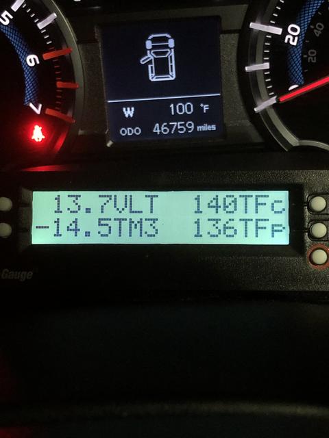

Are you guys able to get both trans codes to work? Which is pan and which is convertor?
Ordered my gauge today.
For at least 5th gen.....The link you posted for temperature #1 is for the converter. The second one is for the pan. Yes they work. See the temps on the right in pic.
Ignore the difference in angle between dash and Scanguage lol. My velcro is starting to let loose on one end of the gauge.
