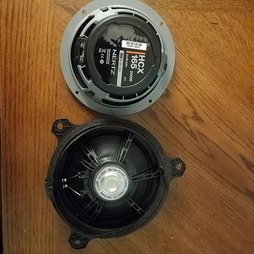

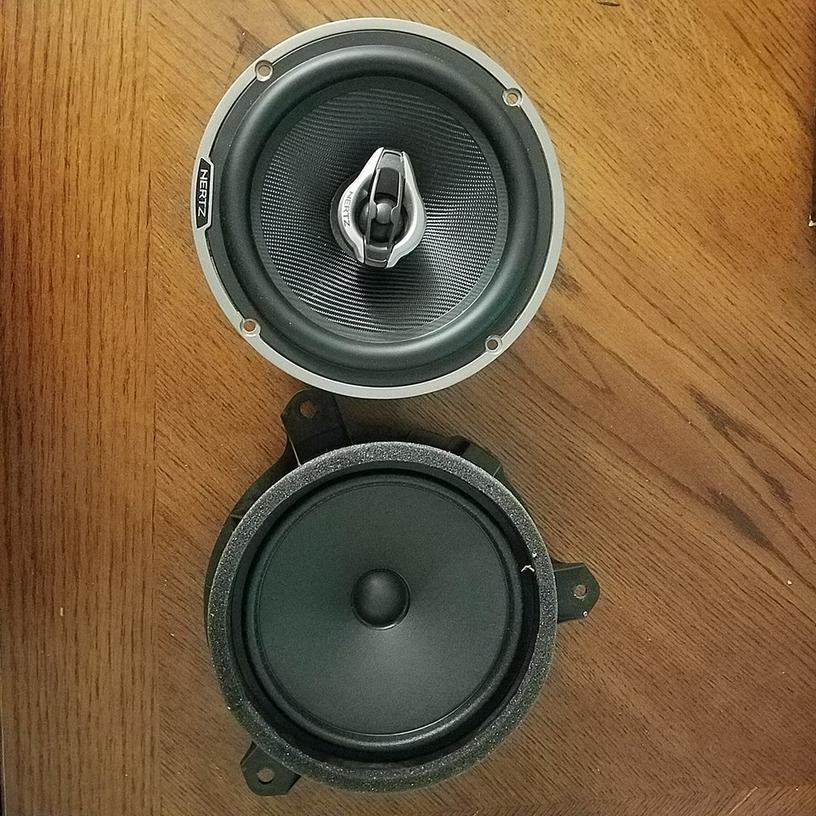

OK, JL C2s installed all the way around, components up front and 4 coax in the rear. Observations...
First, I suck at following standard work. 4 out of 5 door panels had to come back off after I reinstalled them because I forgot to hook something back up.
Second, the rears really need some help, wired in series and the factory HU is really weak in that space. If not adding an amp, cheap 6.5s if anything would be the better bet. The sound is cleaned up, but unremarkable. [MENTION=124049]keyser_soze[/MENTION] is right about just doing the front and nothing else, especially if you are not going to amp the whole truck.
Third, wiring an Amp for the whole truck is gong to suck. I am going to wait a while before I tackle that, but the whole car is going to have to come apart to make it right. If anyone is going to tackle this themselves, I suggest having another car to use so you don't have to rush to get it done so you can get to work on Monday. It'll take time to do it right.
Lastly, the sound deadening really quiets things down, and makes the doors feel more solid, with that solid "thunk" when you close them.
