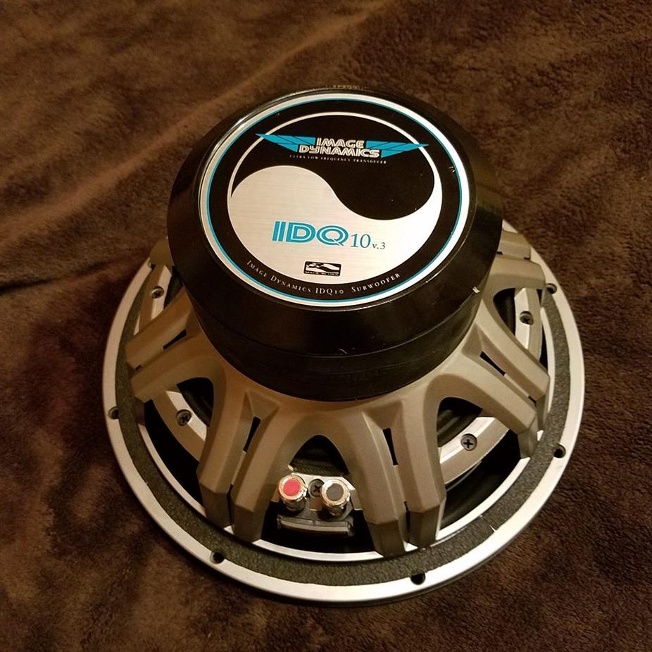

My install will start in a week or two. Still gathering up a few components but here's where i'm at as of now. Going full out SQ

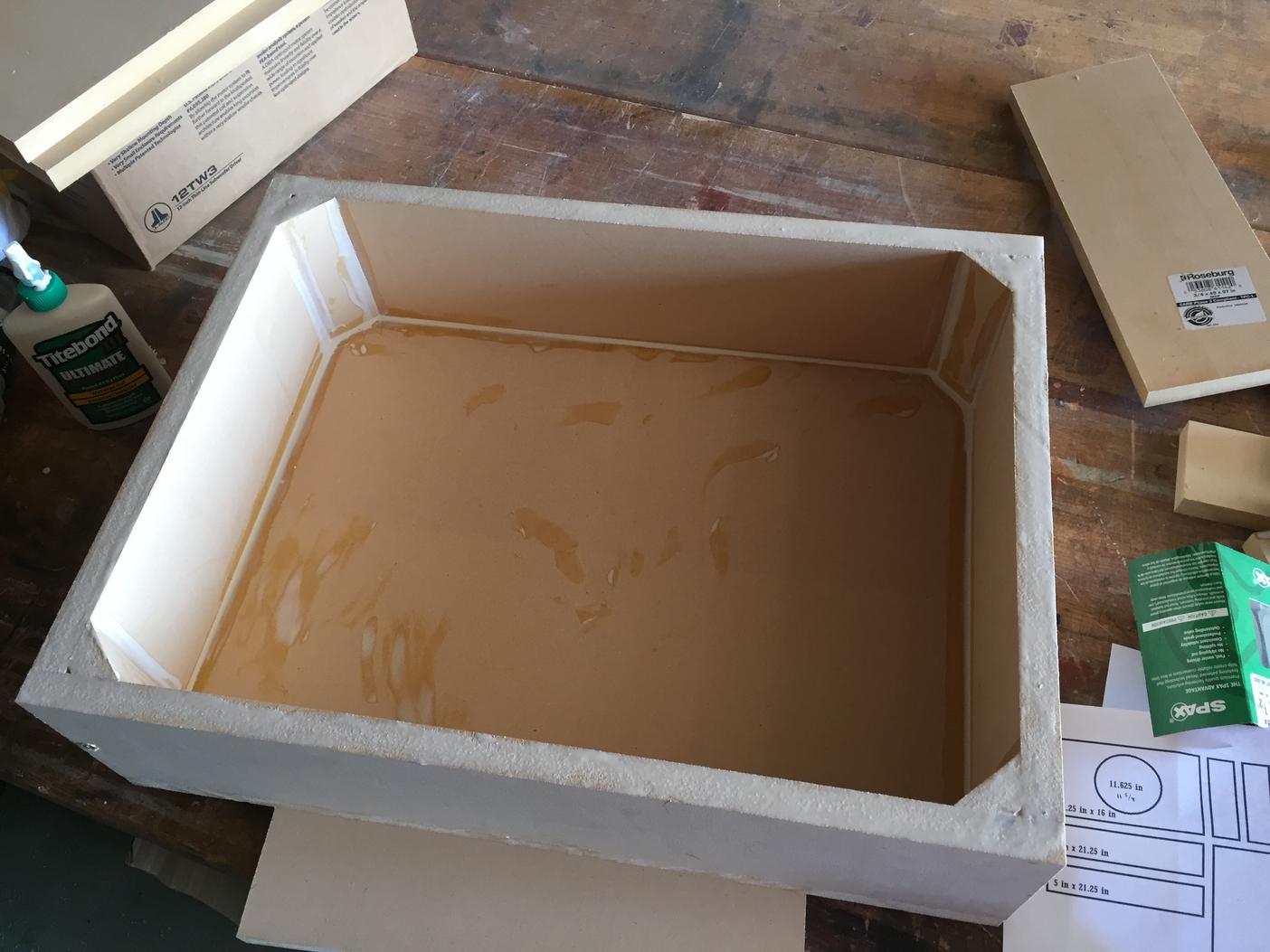

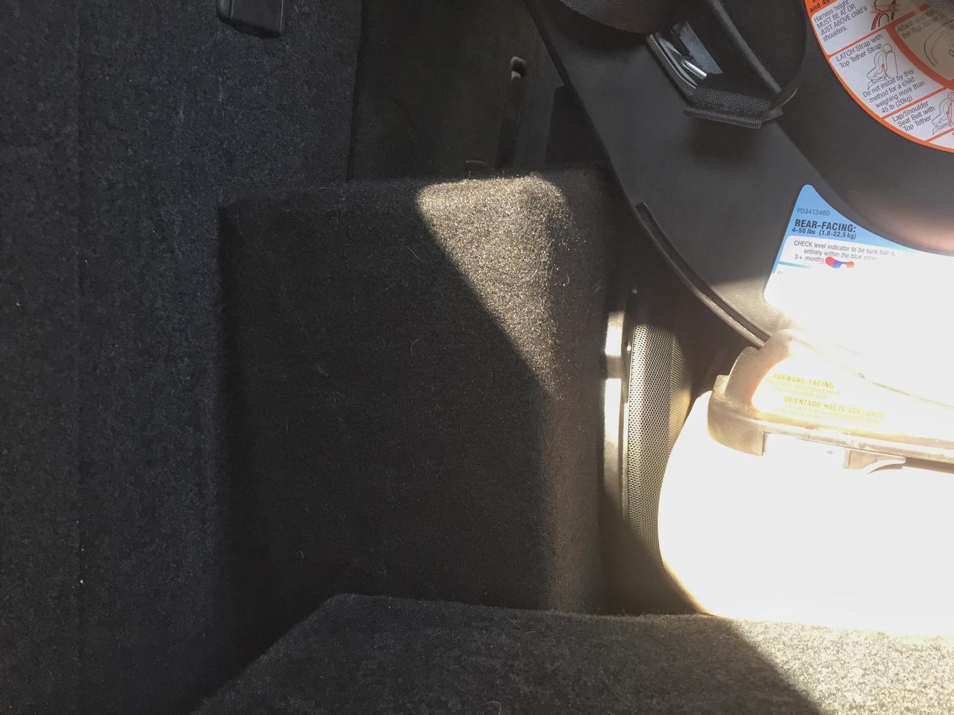

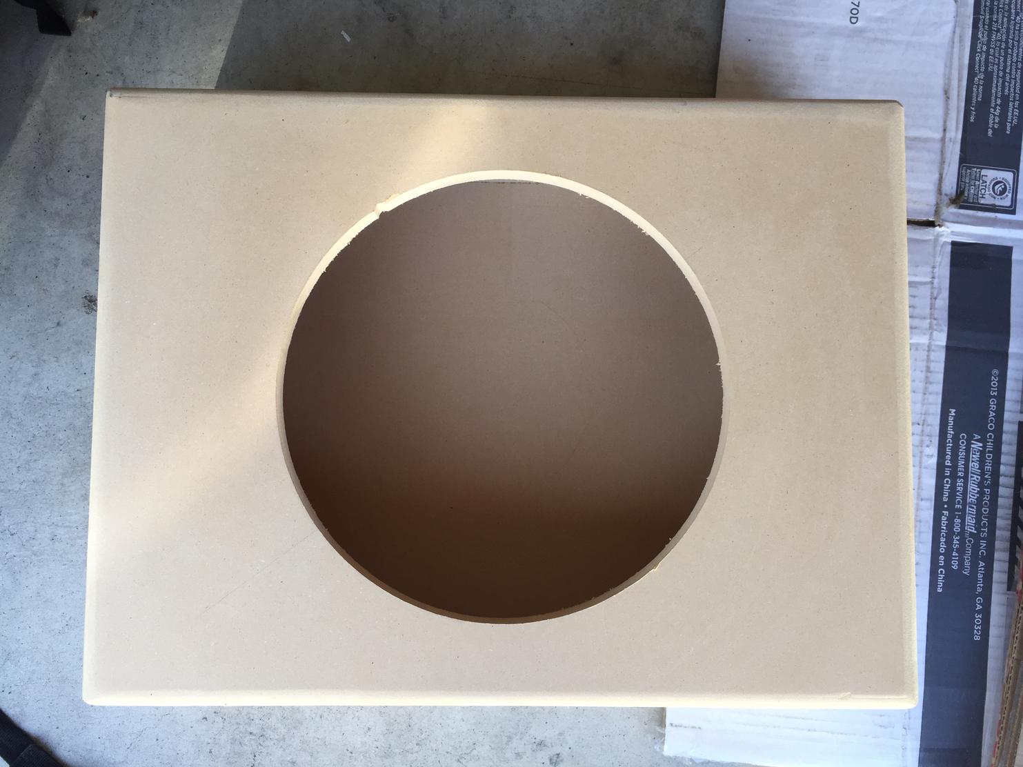

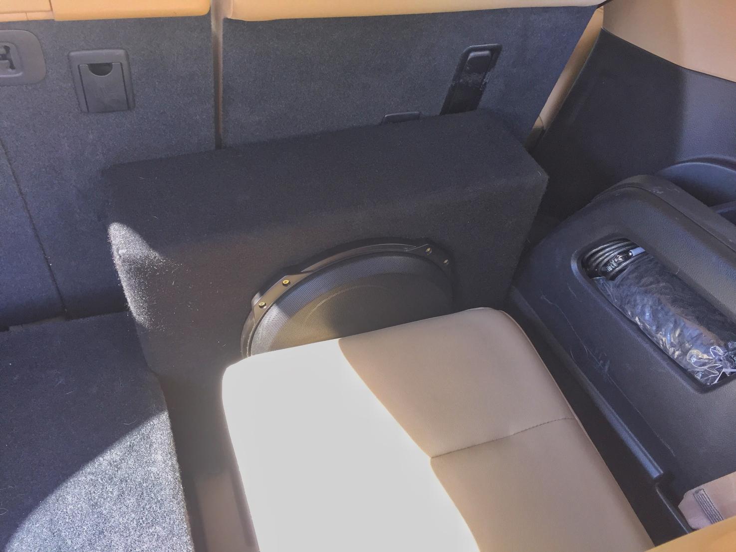

Made my sub box per JL Audio's specs for my 12TW3-D4 Subwoofer. I added some bracing in all the corners. Debating on wrapping it in carpet or vinyl that'll match the interior upholstery. I'm installing it where the third row passenger's feet would normally go with the seat up. Since I have a car seat there, it'll take up no additional cargo space and be out of sight. I am so close on completing my install!

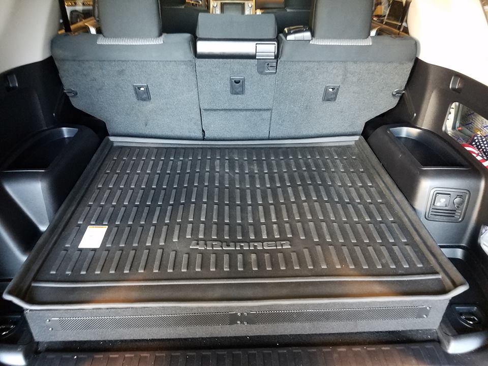

Easy fix. I added a Kicker Hideaway Sub under my driver seat and it's night/day a better sound system now with the bass fill it provides paired with the OEM speakers.

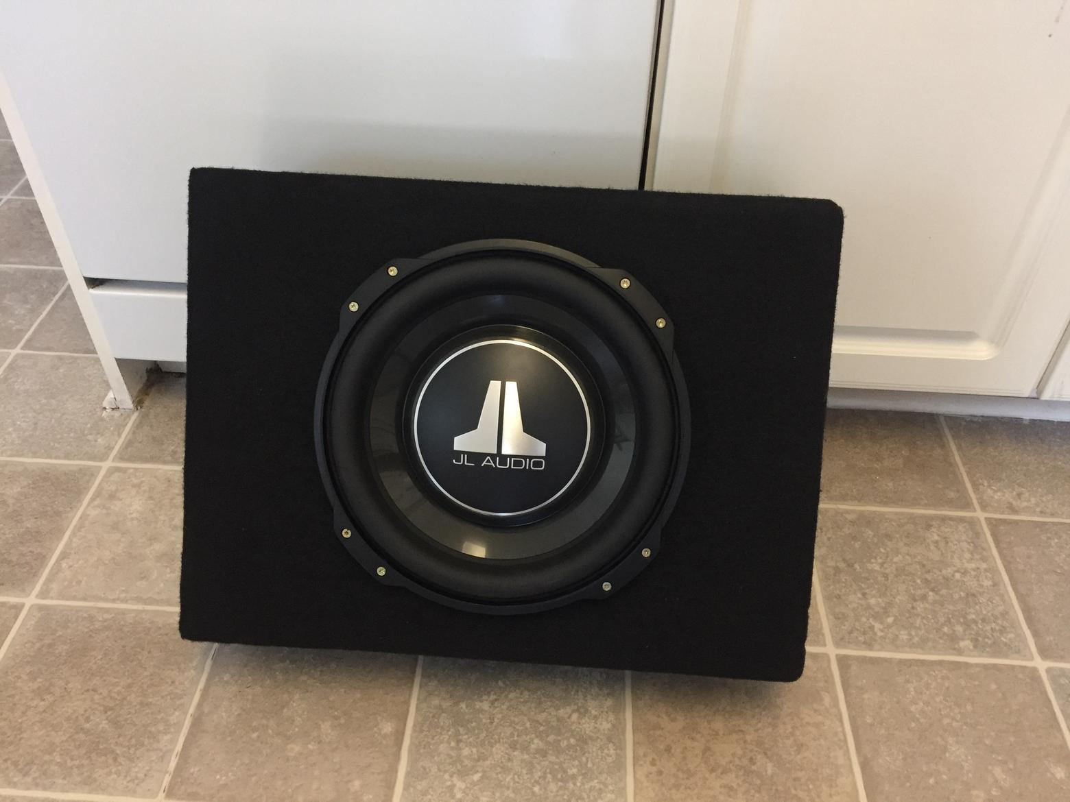

Sub fits perfect in the location between the 2nd and 3rd row, where the passenger's feet would normally go. Tight squeeze but it fits like a glove and to the exact specs of JL. Sub is a JL Audio 12TW3 dual voice coil running at 2ohms. Sub box is approximately .9 cubic foot and sealed. Just need to find the time to tune it with the rest of the system.

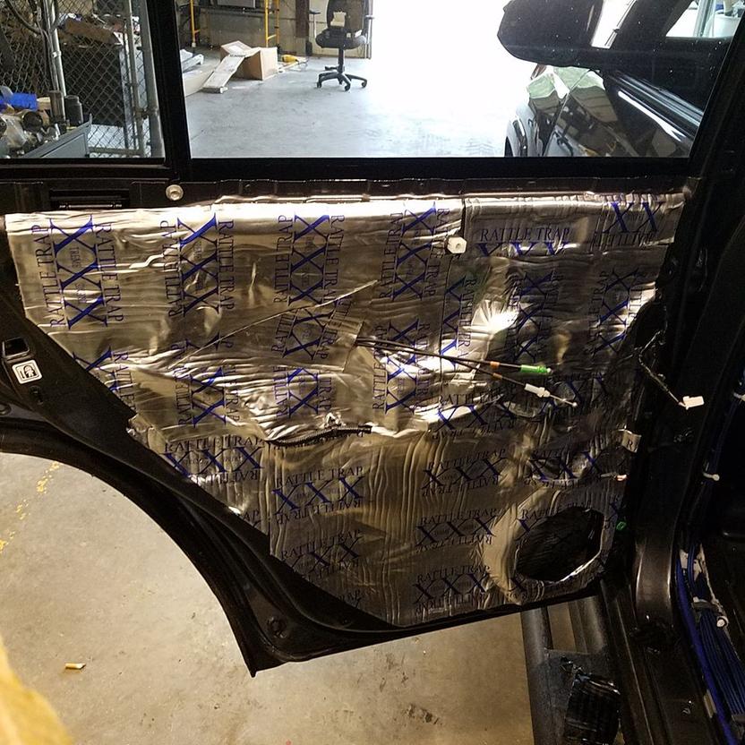

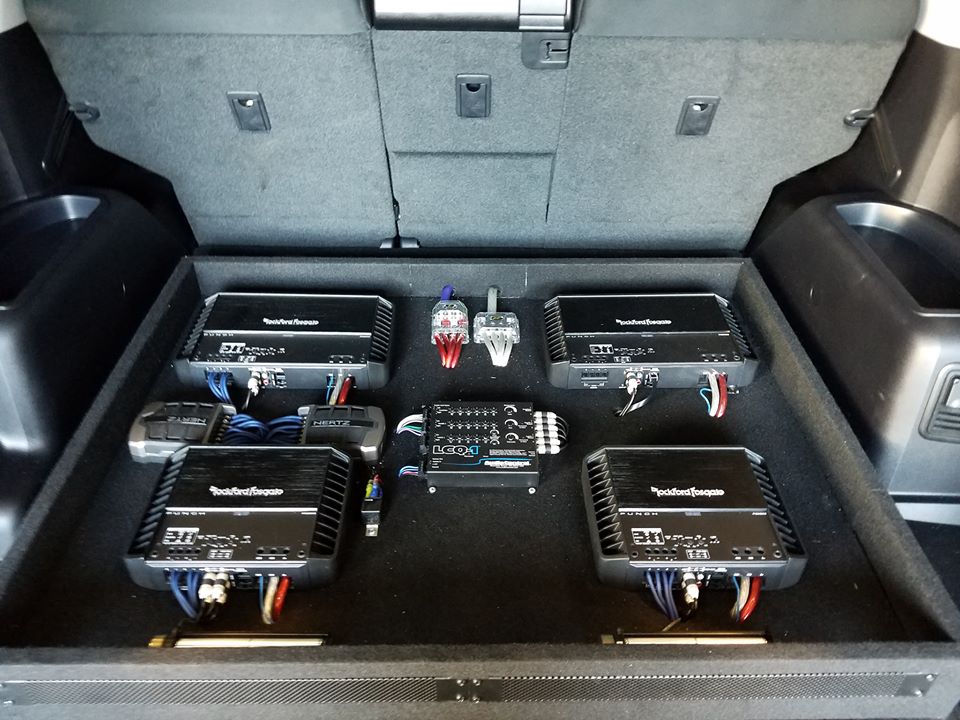

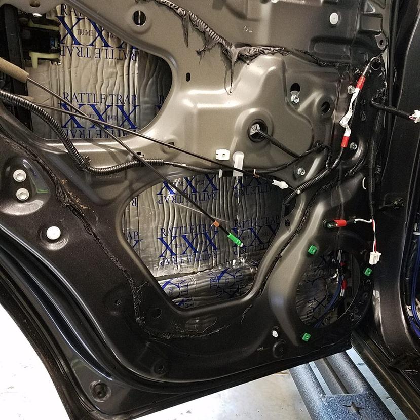

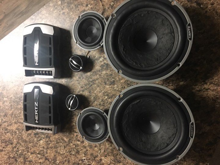

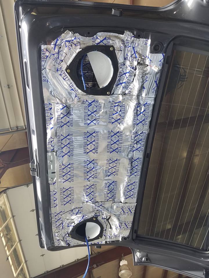

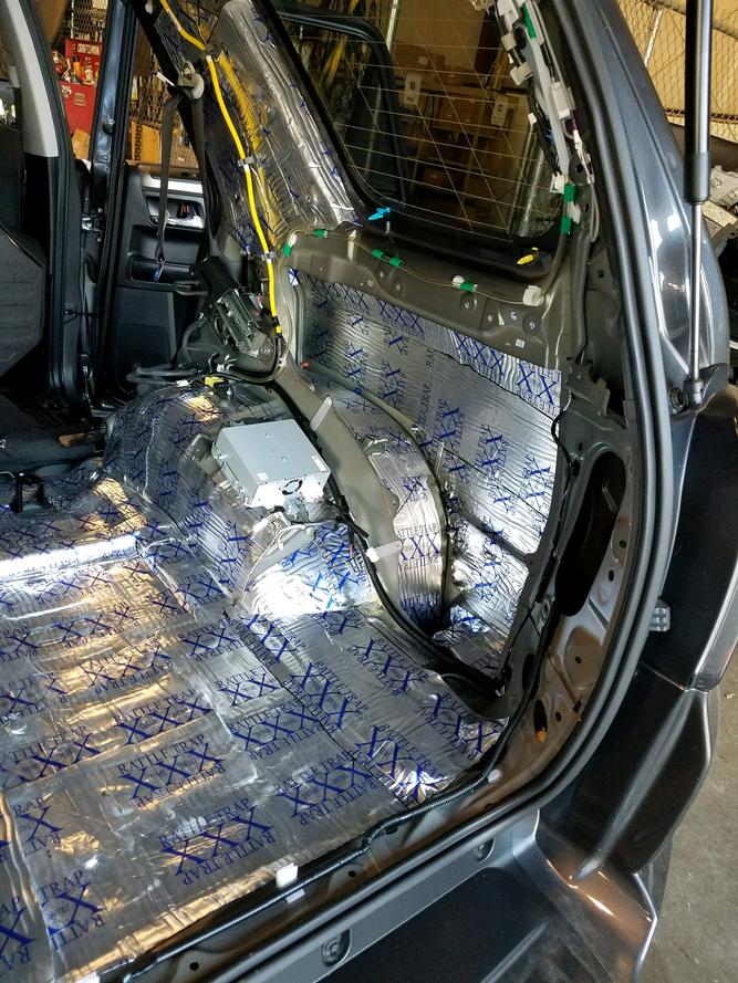

SQ build with a single JL 10TW3 fiberglassed into the passenger quarter panel. All doors are Hertz High Energy speakers. 3 way component up front. One amp per pair of speakers. So much sound deadening the tailgate didn't stay up anymore. Had to install the GOBI struts to support the added weight of the door. Every driver including tweeters has 12 gauge OFC wire soldered to it. 0 gauge OFC power cable, Stinger 8000 RCA cables.
