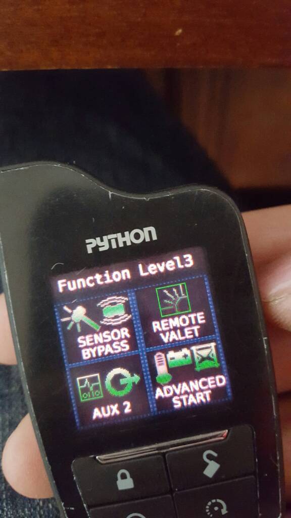

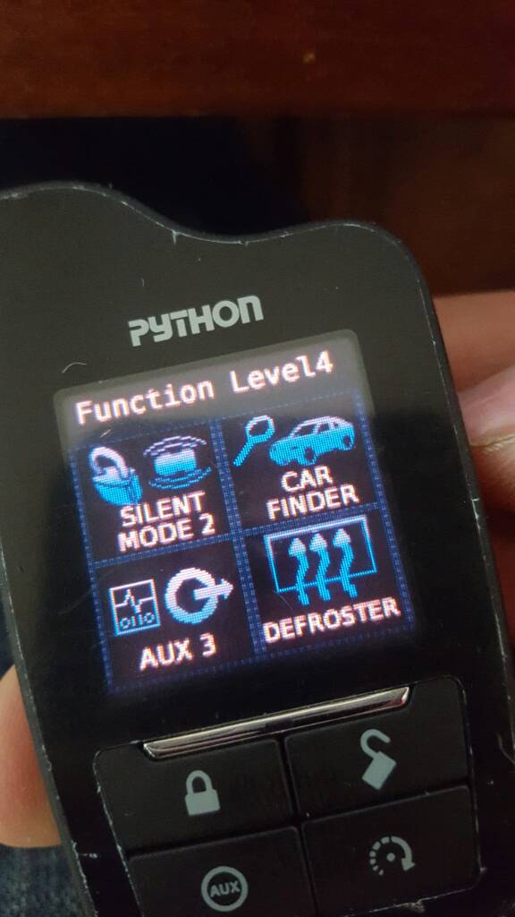

I've just installed an alarm too that seems to have a defrost button as well as timers and so on.... just got it, so I'm not sure how everything works yet, but it's definitely there on the remote.

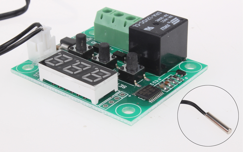

I think I could rig up something by using a micro-proccessor like this one; "but we'll see":
It's cost is about $5 bucks... here's a link to it's description: W1209 12V 50 110°C Digital Thermostat Temperature Control Switch Sensor Module | eBay If you would be interested in using a processor like this to 'Over-ride' the oem rear window defroster switch, I think I can draw up a wiring scheme to integrate 'seamlessly' with our oem rear defroster dash switch; processor decides when defroster needs to be on or off automatically based on the outdoor ambient temp... there are plenty of processors around to choose from; we'll just have to pick one that matches all of our particular application parameters! ...I'll be back once I've had time to read up on these processor electrical system Nomenclature specs, and the O.E.M Defroster wiring (input/output/build-platform),
