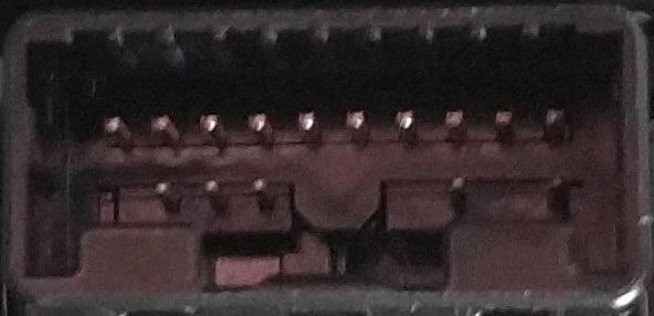

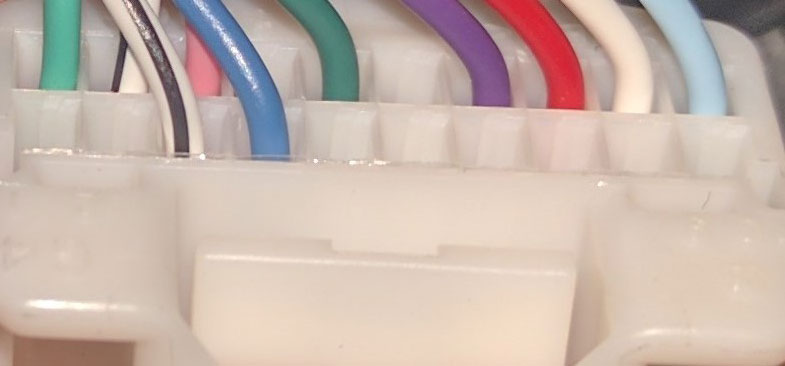

After studying the diagram, it appears to use a slightly different labeling of the pins/wires than I used in my earlier post:
11-12-13-14-15-16-17-18-19-20
01-02-03-04-05-06-07-08-09-10
plug wires:
11-12-13-XX-15-XX-17-18-19-20
XX-XX-03-04-XX-XX-XX-XX-XX-XX
colors -
03 = white + black (WHT/BLK) = switch/circuit for 01-10? (LFO?)
04 = blue (BLU) = fogs (BFG?)
11 = light green (LT GRN) = high beams on (HU?)
12 = white + black (WHT/BLK) = switch/circuit for 11-20? (EL)
13 = pink (PNK) = light sensor? (?)
15 = green (?) = ? (?)
17 = violet (VIO) = high beams flash (HF?)
18 = red (RED) = tail lights (T)
19 = white (WHT) = auto (A)
20 = light blue (LT BLU) = head lights (H)
stalk pins:
XX-02-03-04-XX-XX-XX-08-XX-10
connections (P=plug, S=stalk, X=neither)
PS-PS-PS-XS-PS-XS-PS-PS-PS-PS
XX-XS-PS-PS-XX-XX-XX-XS-XX-XS
