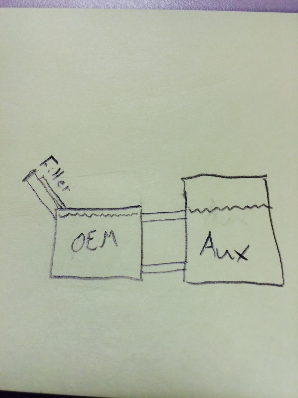

My concern with gravity feed is the pressure 18.1 gallons of gas may have on my stock tank. Prepare yourself for the stupidity that flows through my brain daily....
Mr. Wizard's overly simple example: If you take two cups - a larger and a smaller and connect them with a tube at the bottom of the vessels the pressure tries to normalize. The fluid from the larger cup pushes itself into the smaller cup, and that cup over-flows. So in my pea brain the larger tank will force gas back into the smaller tank causing fuel to creep up the filler neck.
There - now that I've got the crazy out I have one more point. I was hoping to avoid a line below the frame rail so I wouldn't have to worry about snagging it on a rock. A pump allows me the freedom to go above the rails, but does add a degree of complexity in wiring.
I talked to coinball about that one - just a bit more then I want to pay. Tank, sending unit, and a chunk of steel that will become the skid plate only puts me in at $60 so far. I need to test fit the tank to check if I can make the stock filler location of the Camry tank work with ANY configuration right now.
Hmm... I like where you're heads at. Wouldn't that would only be if the opening for the system (The filler cap) was below the second tank? Other wise it would just rest at the highest point within that line. And if you plumbed them to the same point you wouldn't have any issues... as long as the lowest point in the system was the pump location.
That probably is the case. I'll mock it up and see what it looks like height and plumbing-wise. If I could run two larger lines between the two tanks, one at the top and one at the bottom it could fill and vent off the OEM set-up. If may make any portion of the aux tank that is above the OEM tank just empty space, but would be an easy solution to the dual filler neck.
Like this fine example on quality sticky note paper. I'm surprised my work hasn't blocked T4R from my computer for all the time I waste here.
So if the fuel level was higher than the top of the OEM tank would that cause issue with the breather/evap stuff? Because I think the Camry tank will sit well above the OEM tank.
That is the million dollar question and honestly why I was thinking of using the sending unit as a transfer pump initially. Too many unknowns.
