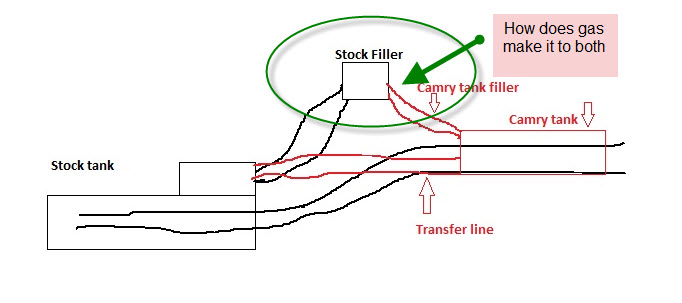

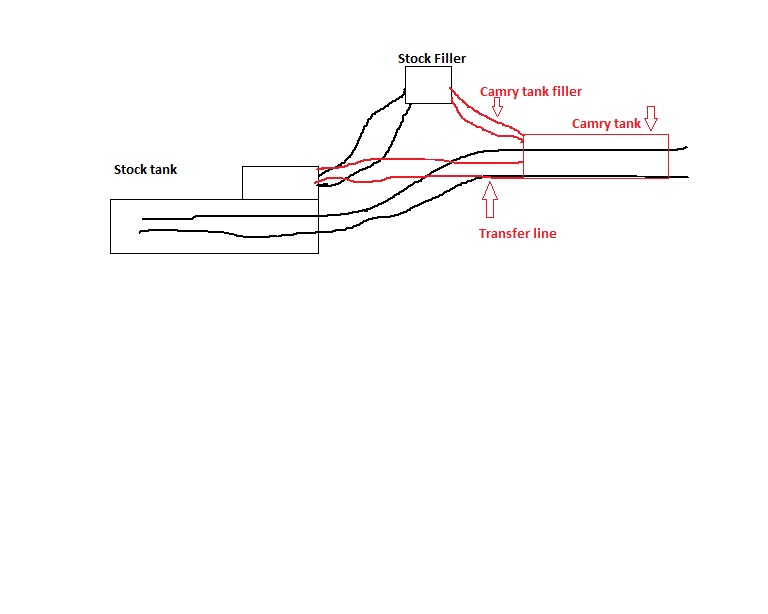

Here is a cruel drawing for ya.....
It's not that hard.
Run the filler to the Camry tank from the STOCK location.
Run a line from the CAMRY tank to the STOCK tank.
Wham, Bam, Thank You Ma'am.
There is no reason to think about the evap system, because you're not modifying the tank. You're ADDING another tank, thus increasing the CAPACITY of the VEHICLE. Not the TANK by itself.
The Camry tank is just a reservoir. Nothing but 5 Jerry cans strapped to the under side of the truck.
The TRICK, is to make sure you get the transfer line at a low enough point on the AUX tank where it will get ALL the gas out of the tank.
You need a 1* drop from the damn transfer tank to the Stock tank. That's enough to keep the fluid flowing south.
The gas Guage will read full, until you use the gas in the AUX tank, and then will start getting lower because you're using the fuel in the STOCK tank.
I can see how that would be a problem for some of you, but shit, you already know the damn mileage your 4Runner gets PER TANK.
Make sense now?

We have a term for what you guys are doing with this Aux tank thing in the Navy.
It's called "nuking" it.
You're OVER THINKING the PISS out of this set up.
It's not that hard.
Make sense now?

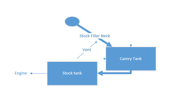

Of course I'm over-thinking it. That is the fun of a forum. I get 9 hours a day in front of a PC, whereas I'm lucky to get an hour a night under my truck. I like the simplicity of the plan, I'm just not sure how your set-up allows gas into the Camry tank without causing a standard gas pump to auto-stop. It would require the stock tank and filler neck to fill which usually stops all modern pumps. The only answer I see it to either valve it or daisy chain it.

Sorry to bust your bubble but can have the secondary tank any higher then the the stock tank. If the fuel level is above the stock tank, it will flood the Evap box killing it and drawing gasoline directly into the manifold.
sing toe is 100% correct. the camry tank is going to have to run independently along side the 4runner tank, like the early efi F-Series trucks that had dual tanks. flip a switch flip your source.
YOUR DRAWING!
You DON'T fill both tanks. You fill the CAMRY tank, thus filling the 4Runner tank.
I don't understand. It's just topping off the stock tank. It's not doing anything else?
