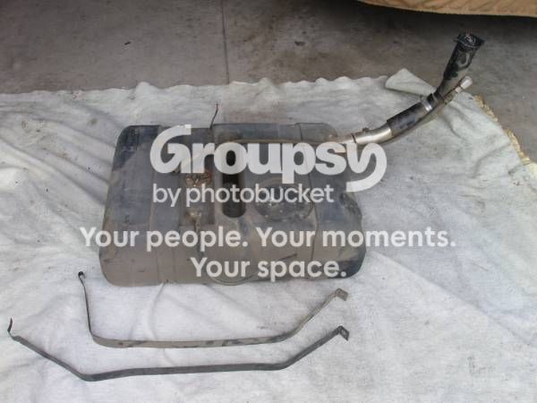

^guess that is the easy way haha. 12" seems kinda deep, i wonder how much it'l hang down below the frame...
Almost 4 inches without re-locating the sending unit. Plus I'm not sure how to route the filler neck. It may impact my departure angles once I add a skid - and the extra 150 lbs of fuel and 50 lbs of tank are too much for my OME 890's (when I have gear loaded)
I like the idea of 450+ miles of range but this is becoming a PITA. I keep going back to that LongRanger aux tank that fits above the spare. May be worth having one fab'ed up.
yea i agree, that (not sure where to buy one here in the states) or just buying a fuel cell...but both are pricey. i'm still hunting for a junk-yard tank that will work well...sadly it seems the ford tank everyone uses is the best fit. still searching though

A tank to go in the spare tire area is something I'm interested in. I'm considering finding a local fab shop to see what they can come up with.
I would like to revive this thread. I really like the idea of using the vacated spare tire location. It seems like a perfect spot to install an auxiliary gas tank.
My intention is to keep the OEM tank in its stock location and add a auxiliary tank (from salvage yard), where my spare tire once was. Then install a NAPA (or similar) fuel pump and wire it to a toggle switch in the glove box. Plumb a fuel line from the auxiliary tank to the OEM tank. Then simply flip the switch to transfer fuel from the auxiliary tank to the OEM tank.

I've been collecting parts for this too. So far I've found the older Camry tanks fit nice in the spare tire location AND if you can find one with sending unit still functioning you could use that as your transfer pump.
As far as filling I purchased one of these JEGS Performance Products 30861, JEGS Cast Iron Exhaust Cutouts | JEGS Performance Products
but have yet to test how it manages the flow of the liquids instead of gases.
Your post did get me thinking. What about a reversible transfer pump. Turn it on as you are filling your primary tank and it fills the aux tank. Then when the additional fuel is needed flip the switch so the transfer goes from aux to primary. Only down side I see is the need to tap your primary tank, or share your main sending line. Thoughts?
