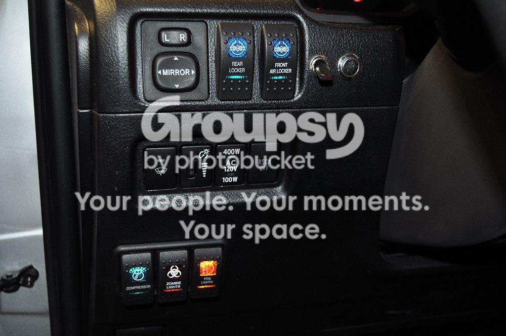

the otrattw switches do not fit in the stock openings, but that doesn't mean they cannot be made to fit.
IMG_0437_zps92b7fb54.jpg~original
these blanks can easily be popped out by reaching up from the bottom, no further disassembly required. I used a dremel to enlarge the hole in both height and width. after that, its simply a matter of running the wire.

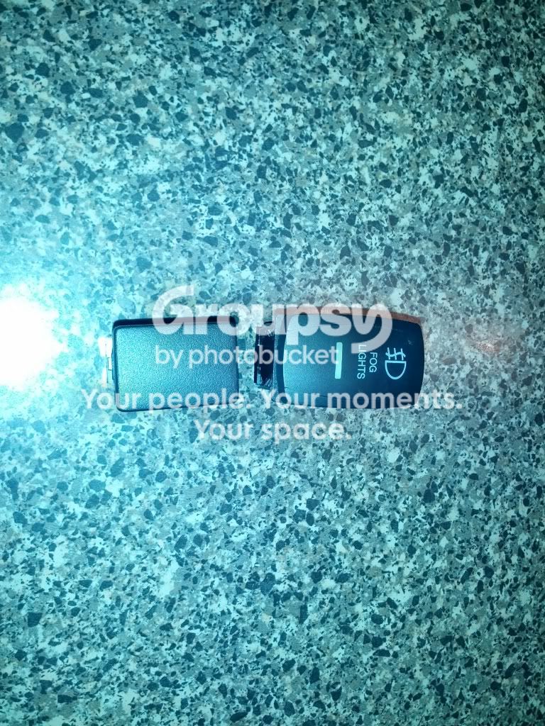

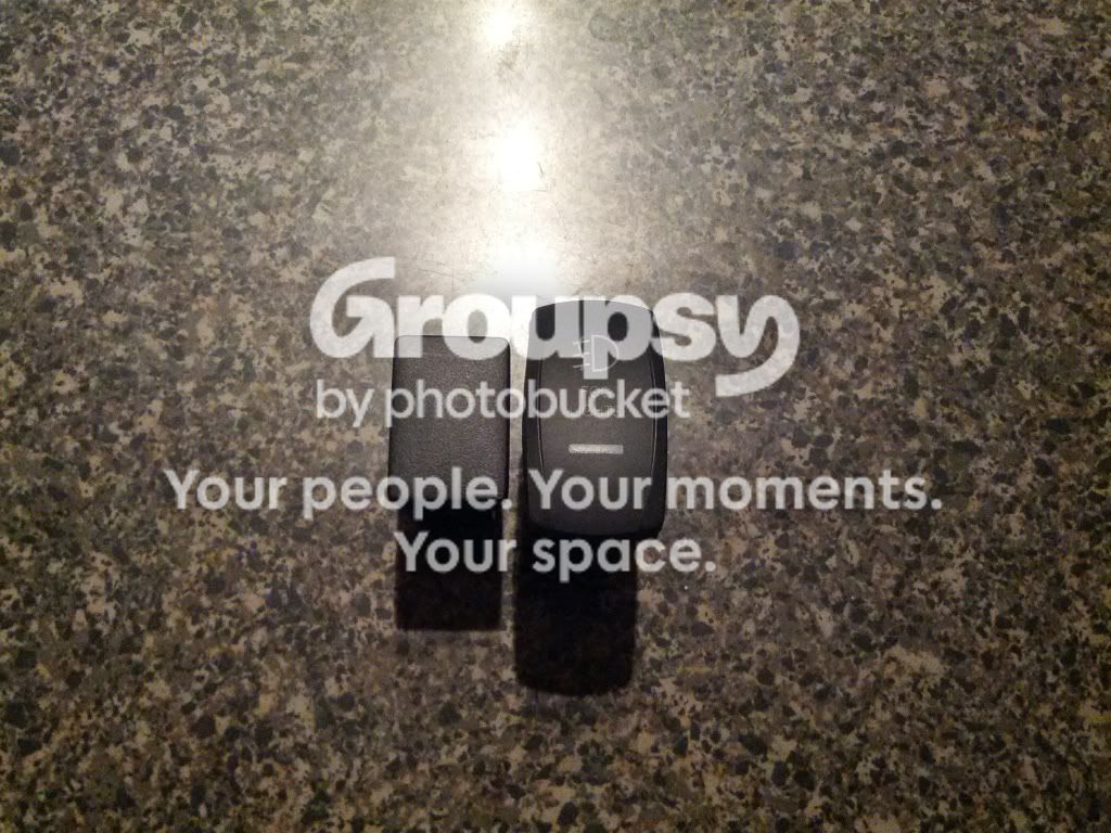

its more of an up and down issue than a side to side one. here are a couple shots of the blank I removed and another otrattw switch
IMG_20130917_211227_zps297c477f.jpg~original
IMG_20130917_211215_zpsc975d0b5.jpg~original
Sweet! please post your results when you get a chance. My switches are currently in-route so I cannot check myself yet. The bulge on the sides makes me think it'll be a tight fit either way and there might be rubbing. Or one will have to stagger the OEM and OTRATTW switches to get them to work.
it'll definitely be a tight fit. honestly, it probably be a month or two before I get around to putting the fogs on, as I plan to work them around a winch/winch plate that has yet to be ordered. So I'll be as interested as you are to find out about fitment of the switches.
I'll be at work for the next few weeks, you might actually beat me to it. But I plan on taking some crappy cell phone pics when I do start; I'll post 'em up for sure.

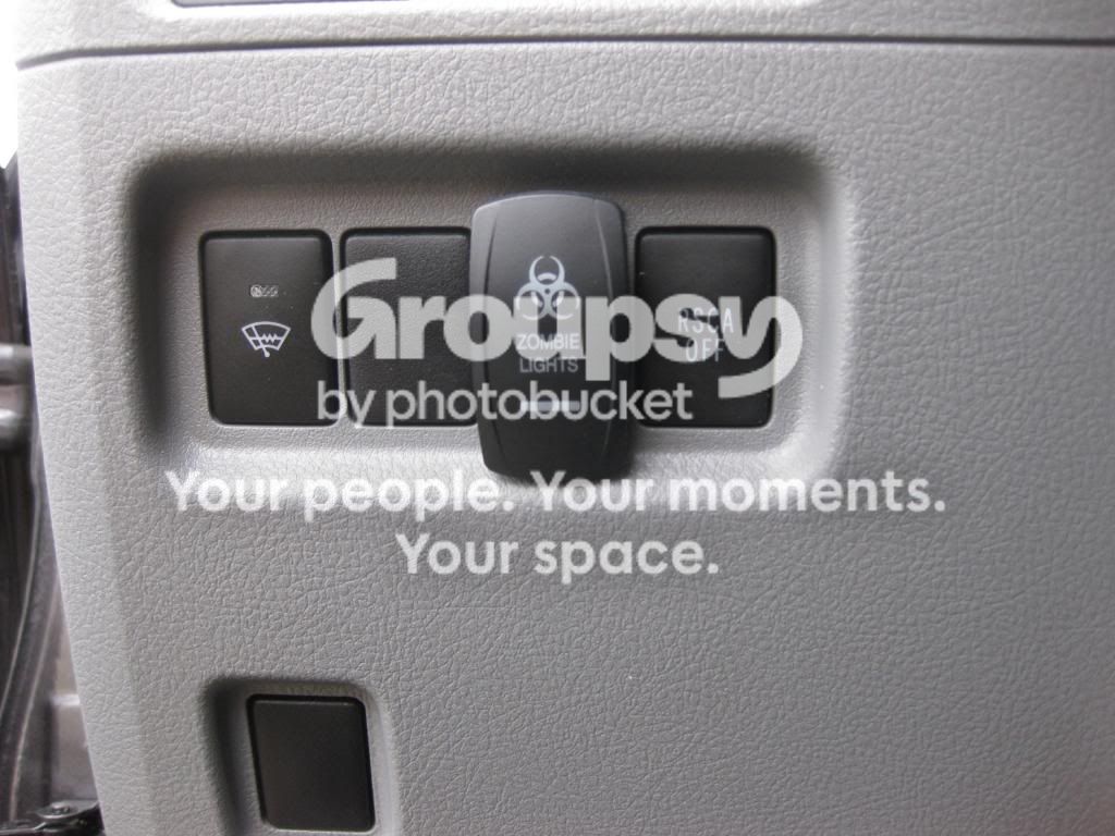

This is the only one I've seen side by side: http://www.toyota-4runner.org/5th-gen-t4rs/87982-rearview-camera-mod-nav-8.html#post1475180
But I am not sure how the spacing is up there vs the lower 4 position area...
Moving the switches around like you suggested is definitely a plan, but keep in mind that most of the switch slots are keyed differently (RSCA switch can't be easily put into the wiper defrost spot and vice versa), so you need to modify the switches or the slots a little bit to fit.
.... but keep in mind that most of the switch slots are keyed differently (RSCA switch can't be easily put into the wiper defrost spot and vice versa), so you need to modify the switches or the slots a little bit to fit.
The dash /switch plastic is so soft you can easily trim any obstructing tabs with a small hobby knife. All my factory switches fit in any hole now, LOL.

Ya ,That's how I did mine too to move them around so I could get the 4 stock ones side by side in a row and leave out the blanks.
I think that row with 4 would be too small for 4 OTRATTW switches as it has tighter spacing.
