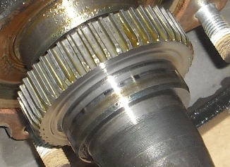

I'm in the middle of this right now (2002 Limited)... I'm going with inner seals and shoes. The bearing seems tight: in/out play is about .43mm (.017"), which I think is within tolerance. I can't detect any up/down slack.
Lots of conversation about placement of the inner "retainer", and where the lip of the seal rides. It looks like mine was more or less centered, if I'm interpreting the photo correctly.
Your interpretation is incorrect. The seal has two lips. The outer dust lip and the inner seal. The polished ring you see is the outer lip riding in the center of the retainer. The actual seal lip is polishing your bevel on the retainer. That is why its leaking. If you want to get a few thousand miles from the repair, put a new seal in and replace the retainer with bevel outboard and moved inboard by 1mm from where it is now. That should get your seals to seal. But to do it right, you should change the bearings. Make careful measurements before you take it apart and put the new parts on. There is very little room for error with these seals.
