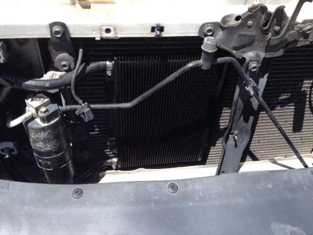

Installed a B&M 70268 Supercooler today and bypassed the cooler in the radiator. Went pretty well after reading everyone else's experiences. My 2wd 2000 SR5 has 223,000 miles and I wanted makes sure I did not have to deal with the milkshake. I have owned it for a year and based on the car fax it was well maintained prior to my ownership, but I had to make sure.
Thanks to everyone who has written about their experiences making easier for everyone down the line.
