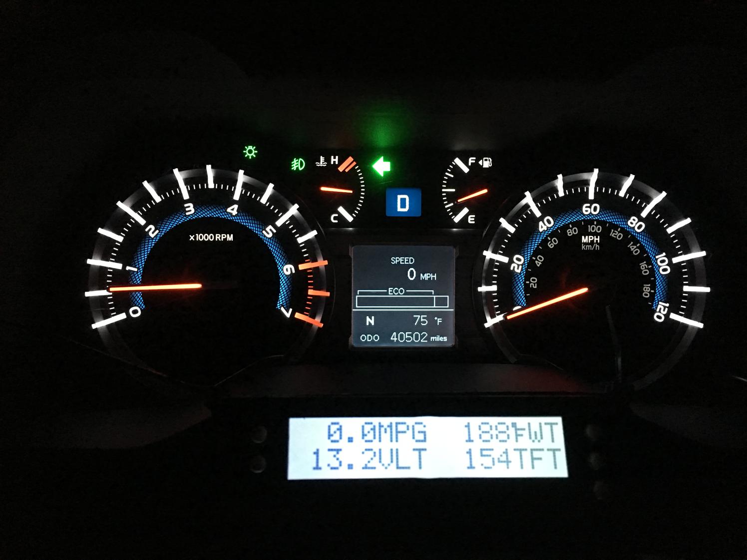

Using ScanGauge, prior to B&M cooler I've seen my Trans temps match my coolant temps (+/-) on long hot days driving on the freeway, and spike to high 190's in stop & go, but quickly come down after some speed and air circulation.
Post B&M, Trans temp consistently 10-30 deg lower than coolant, and can just about match coolant in stop and go, but no major spikes.

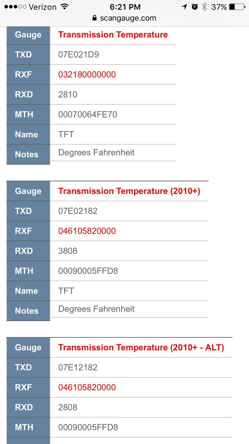

My scangauge is picking up torque converter temps. I was unable to get it to do trans oil pan. Do you know what code you used?

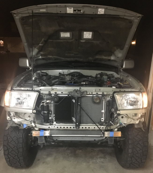

Rad, Tranny Cooler, Filter, Condenser, Drier, Green to Red Notes
So since I have the bumpers off and awaiting some custom ones I decided (at 128k) to go ahead and put a new radiator in and to add a tranny cooler and filter. My AC condenser looked pretty beat up from the years so I also did a new condenser and drier. Here are my notes after all this to hopefully help others.

RADIATOR & TRANNY COOLER INSTALL NOTES:
-Find the tranny install video posted all over the forum. It's worth watching the entire thing. I watched it a few times. Thx to Tim the toolman! https://www.youtube.com/watch?v=2nVbwe2t2T8
-You can trust the images on these threads for 3rd gen runners but STILL the BEST IDEA to visually chase them yourself. I even marked mine with painters tape and labels as I mapped it all out. Basically: OUT tranny hardline (Rear/low return hot > Radiator in (passenger side) > Radiator out (drivers side) > Magnafine in-line filter > in top of tranny cooler > out bottom of tranny cooler > back to IN tranny (front/upper) hardline.
http://www.toyota-4runner.org/3rd-gen-t4rs/63553-writeup-tranny-cooler-install.html
which transmission line heads to the tranny cooler? - YotaTech Forums
-The shroud is no problem and can be added after the radiator is back in. There's a comment in the video to put it in before the rad but I see no reason for that.
-OEM rads are on sale at most dealers now (less than what I paid.) I got mine for $200 and it was worth going the stealership route for this I felt so that IF it was damaged I could simply not take it. I did not want to deal with a damaged radiator as is common per many threads and amazon reviews of the Denso's etc.
-Check your input/output tranny lines on the rad before you put it in...make sure those nuts are tight. Mine were with OEM.

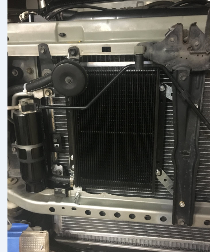

-The zip tie mounting method of the tranny cooler is fine but since my condenser and rad were brand new I just couldn't stand to bend any fins. But mounting it up with brackets was easy-breezy and should allow for even better condenser airflow. Plus, there's tons of room between the condenser and grill so why not? (If you drill that lower left hole put something behind! Don't drill your condenser!
-I simply bent my horn mounting bracket to bump out over the rad cooler. No prob.
-Consider doing your thermostat. I did not since it's working, since I have the SC pulley/tensioner in the way (not an issue on non-SC'd), and since it's something you can get to at any time without removing the radiator. But, it would be a little easier with the shroud and rad out of the way so something to consider.
-Watch your abrasion protection. Split line around the AC line hole is best per the video. Watch them down by the bottom of the shroud where they connect to the hardlines. Zip tie them good to the AC lines...just ensure nothing moving can get anywhere near them obviously.)

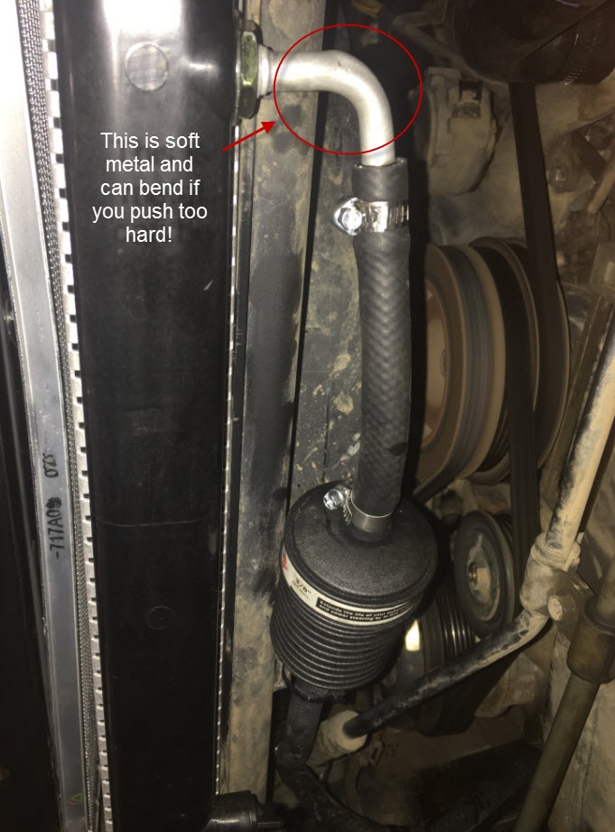

-Watch the driver's side tranny cooler input L-bend line. It's soft metal and will bend. I pre-lubed it with tranny fluid and that helped but I could still only get it on so far. If you try too hard you will bend that line so be gentle.
-I did buy my condenser and drier on Amazon. The condenser came with box open (never good). As is apparently common (from forums and reviews), from the top it looked warped which I did not like but had no blunt or big fin damage so I installed it which was fine. It charged up and held a charge fine as well. I know it's lightweight alloy and many come this way, but compared to my stock I didn't like that bend/warp in it. Oh well. Napa wanted $130 for the same part so on it went.
-Try and minimize the time your AC lines are open. I immediately removed and replaced the lines but if they are off for an extended period of time put electrical tape over the ends of them.

PICS
Here are the pics! Hope at least one of these tips help someone else!
