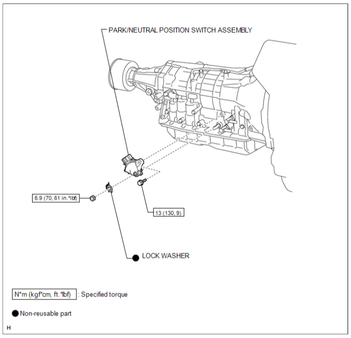

Sorry to be a stickler, but these explanations can be deceiving on the forums. Right side of transmission: looking towards the transmission, or meaning passenger side?
Have a pic of the switch / part number? I will try this tnight.

Left and right should always be from the drivers (or passengers) seat looking forward. :) The switch is on the right side of the transmission. see attached.
