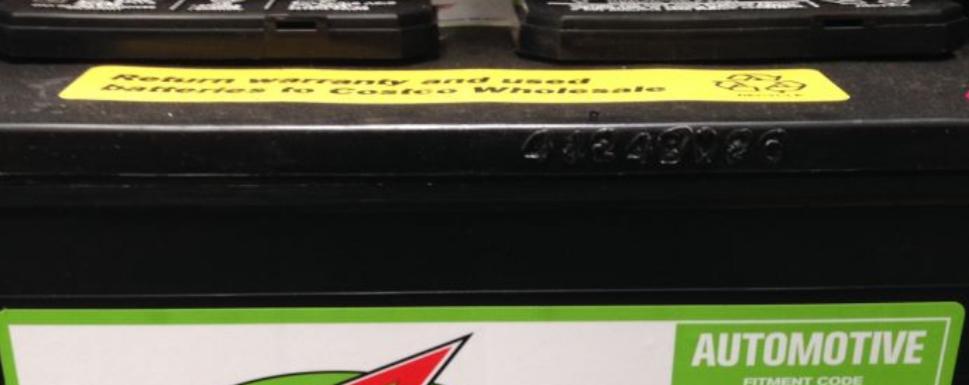

Probably. I was just curious. Like DIY maintenance, I'd rather not hope that someone else did it right. I tried to check the codes in store but found it next to impossible as my size was on the bottom rack of a dark corner of the shop.
Sucks gettin' old.
Raise your hands if you can read this...
