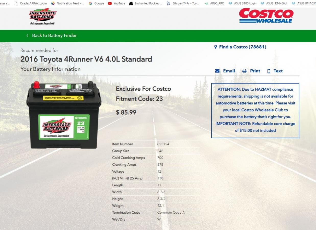

I had a service appointment this morning at the stealership and they said my battery was bad, cranking under specs. They offered to replace for $200, i declined and went to Costco. Replacement was $90 and fit like a glove.
I replacement the OEM battery in my 2013 just last year with the exact same one you have. Doing great so far. Aren't many other batteries just rebranded Interstate batteries anyway?
One weird thing is that if you go to the Interstate web page and use their sizing tool, it actually spits out a 24F battery vs. group 23????
Are you sure the battery was even bad? "cranking under specs" seems like a load of bull to me. Typical dealership up sell tactic to quote something the average owner has no way to verify.
