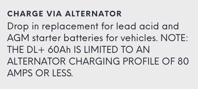

Read the fine print on that battery. It cannot be charged by the car charging system, rather it requires a special lithium charger (which is included in the purchase price). Charger is only 10 amps which means it would take six hours just to charge it, I assume at home. No good for backwoods adventures.
What am I missing?
Appreciate it guys n girls
