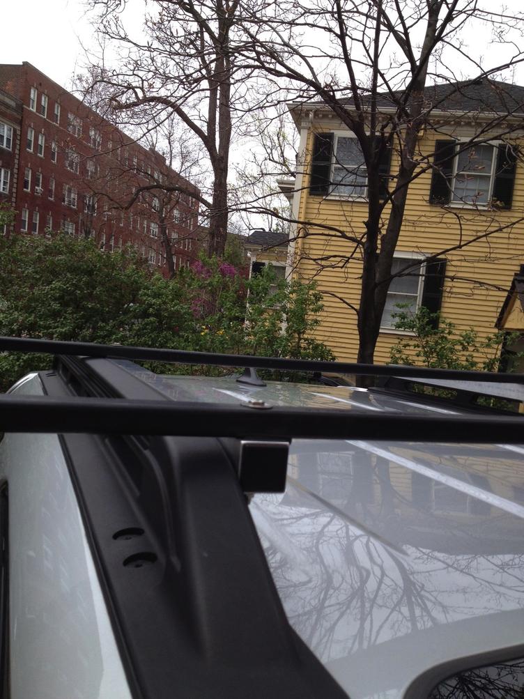

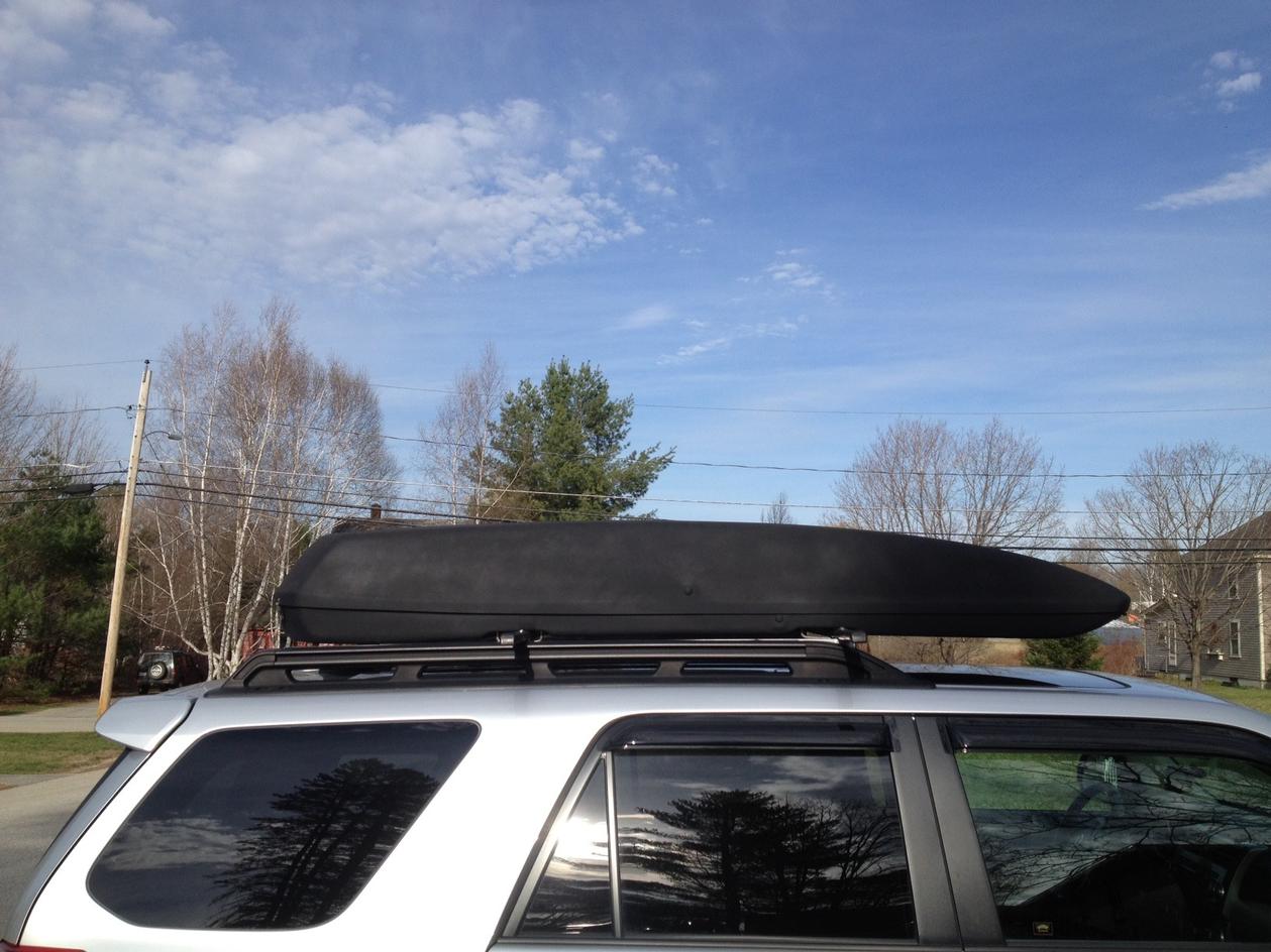

First up was the rack mod to accomodate the packasport box, I used 1.5" square aluminum tubing and all stainless hardware. I mounted the rails using industrial uni-strut nuts with spring backs in the rack channel. this worked out great. I then direct mounted the thule bars so as to keep the as low profile as possible. Image 9.jpg
This allowed for the box to be positioned far enough forward so as to not interfere with the tailgate.Image 8.jpg

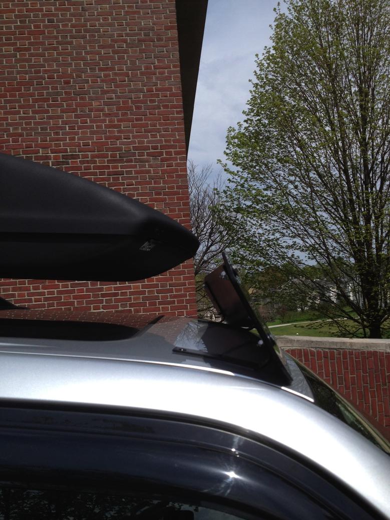

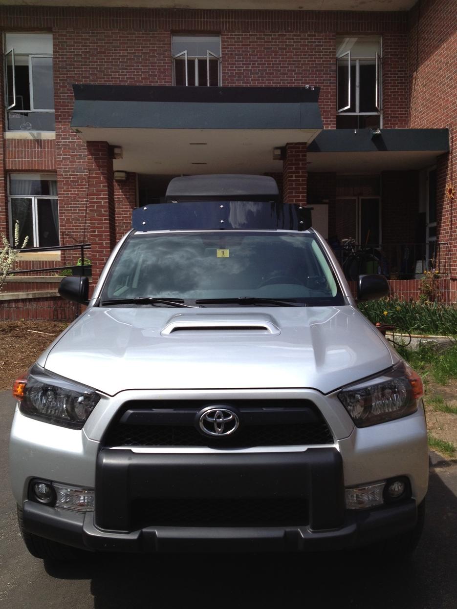

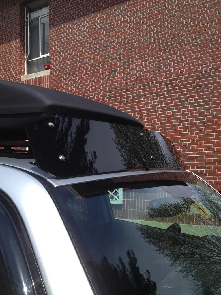

The Box was perfect except that now it was a severe wind drag, and killing MPG's, so I fabricated three brackets using corner braces 6" by 6" and bent them in a blacksmith shop to fit the contour of the roof. I then bent the front leg back to roughly a 45 degree angle. I used 3M heavy duty adhesive tape to mount the brackets. Believe me that stuff is extremely strong.
I then bought a piece of Lexan 1/4 inch thick 8" tall and 48" wide and shaped it so it wouldn't look to homemade. I painted the back side of the clear Lexan black to match the truck but not the front so that road stones would not chip the paint. I pretty proud of the result. it all bolted up perfectly with stainless hardware. it did not even shake at 105 mph...... (testing purposes) :reddance:

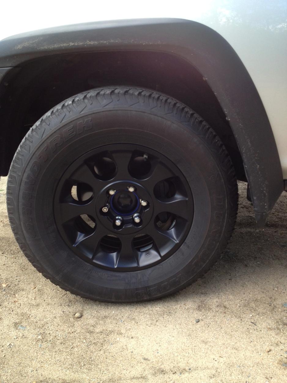

Next cam the spidertrax 1.25 and thanks to the dealer mistake they paid to have the rims powdercoated.

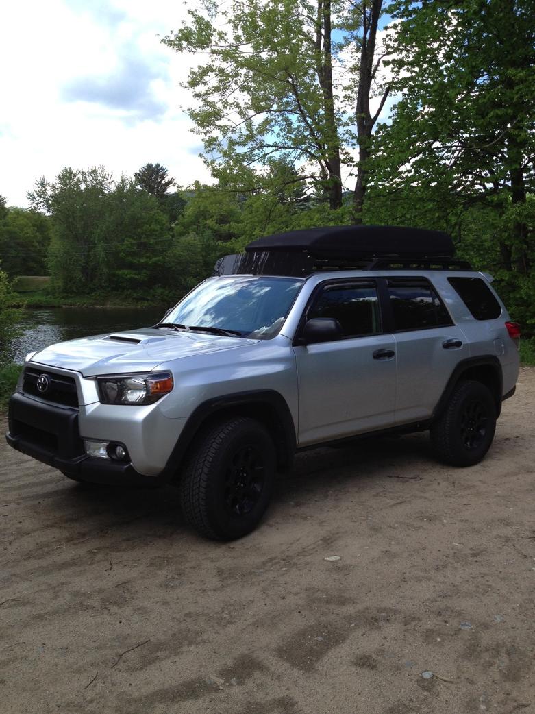

And here is the truck so far, next step is getting rid of these horrible stock tires, and building the storage box where the sliding tray once was.

First up was the rack mod to accomodate the packasport box, I used 1.5" square aluminum tubing and all stainless hardware. I mounted the rails using industrial uni-strut nuts with spring backs in the rack channel. this worked out great. I then direct mounted the thule bars so as to keep the as low profile as possible.View attachment 64904
This allowed for the box to be positioned far enough forward so as to not interfere with the tailgate.View attachment 64905

Yes I installed everything myself, the spidertrax were real easy the only special tool I would say to have is a torque wrench other than that, 30 min install and a world of difference! both look and ride! :banana:
Love the powdercoated wheels. I was calling about getting mine done but a couple of the shops said it would take 2 weeks to powdercoat. My 4Runner is my daily driver so I would need to find tempary wheels while they are getting powdercoated, just to lazy to do that.
I set up with the shop to have them done same day so my truck could sit on a lift, start to finish too 3 hours, they were still warm when I left with them :lmao: only cost $200
