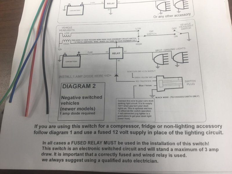

Update: Looks like I will need to go the relay route. Found this diagram showing how to do it. Doesn't pay to try and skip steps. Now to get a relay and figure our where to put it. In the meantime I at least got the switchpro wired and operational and wiped down the engine bay a bit!
http://www.solidkit.com.au/wp-content/uploads/2015/09/RELAY-Dual-Volt-Meter-Wiring-Diagram.png

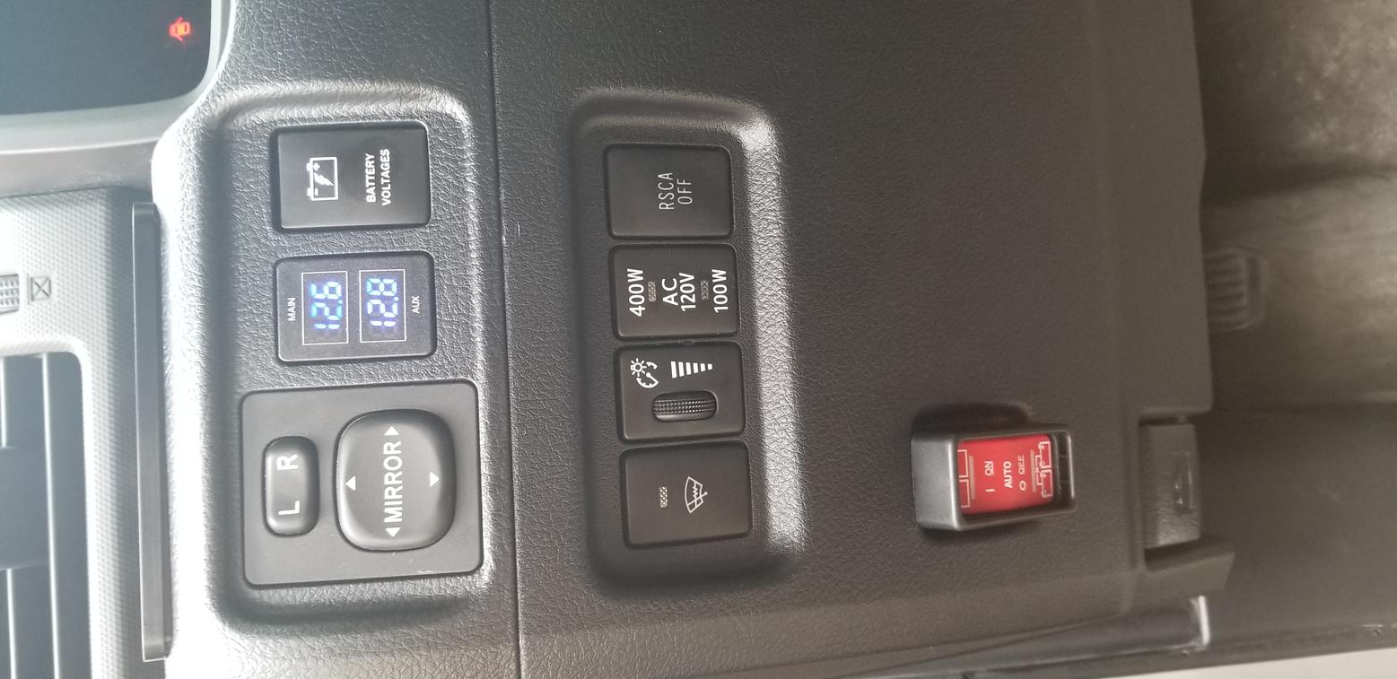

ok, making progress but just hit a snag. My solidkit dual volt meter arrived in the mail today as did my AOB Battery voltage on off switch. the goal was to wire the switch on the negative lines. I can get it to function as an on off but the volt meter only displays 3.3 volts or 6.6v. When the volt meter is hooked directly it reads the full 12.8. here is a diagram I swiped.
any thoughts on how to wire this switch in and get the volts to read properly? I wasn't planning on a relay, the wire from each battery is fused at 2amps so that should protect the AOB switch and it's 3amp rating. I have been able to figure everything else out so far, this is frustrating. Might just need a simple on/off toggle but I thought the AOB would look cool......

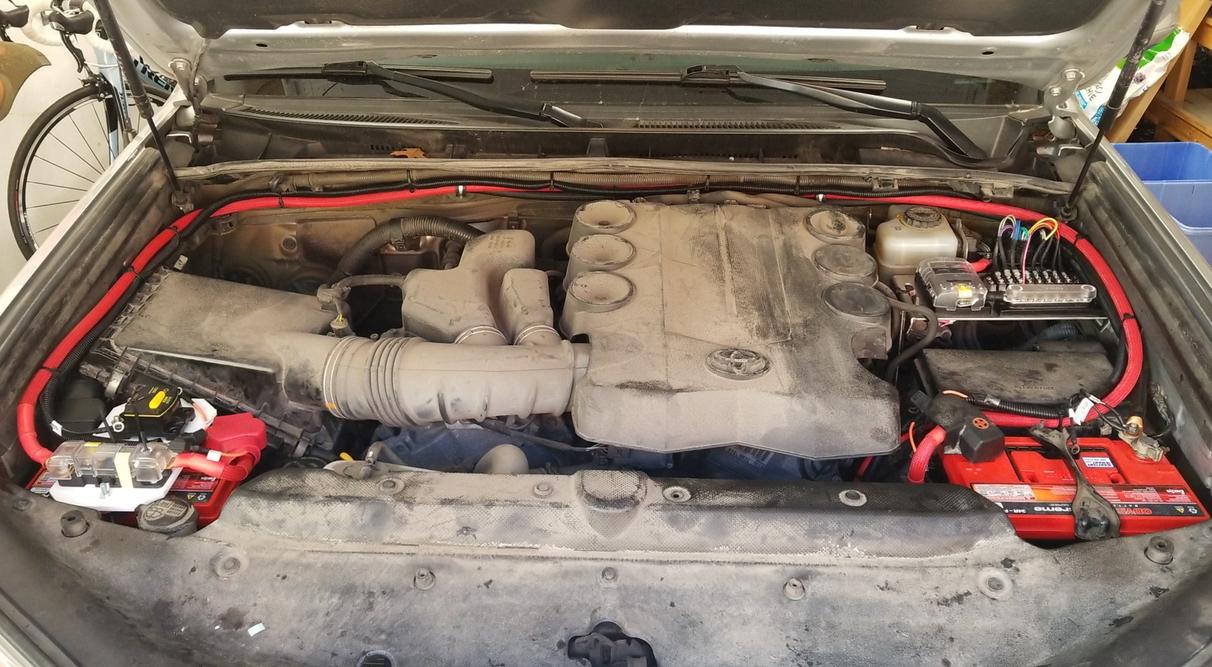

Oh, here is where i'm at so far. Pardon the filthy engine bay.
TIA, Chris

Well I got it to work. Picked up a relay and was able to use the wires that were already run. Now it's time to wire up the accessories. Doing fridge and a couple of power drops in the rear plus the compressor.
This project has been a lot of fun but sure took some time and money. As I often do, any saving from doing this myself was more than offset by upgrades. Shrockworks trays for each battery, Power Tray for Switch pro, SDHQ panel for switchpro, and solid kit volt meter. I had most of the tools and only a bit of knowledge. I have wired and rewired most of my house and am comfortable doing it but this level of 12v was new to me.

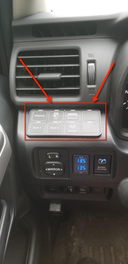

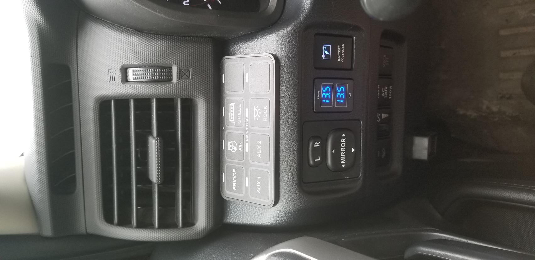

[MENTION=56284]Chrisinvermont[/MENTION] - What brand is this? Is it a SwitchPro?

Yes, Switch Pro 9100. I like it, easy to install and set up. The app on Android leaves a bit to be desired but hopefully as they sell more of these they can update the app. One thing I didn't consider was how the mounting location would reflect in the window when I look at the side view mirror. It's better now that I have the labels on and I'm fine tuning the LED backlights to match the volt meter. I like the location for ease of access both while driving and while outside the vehicle.
