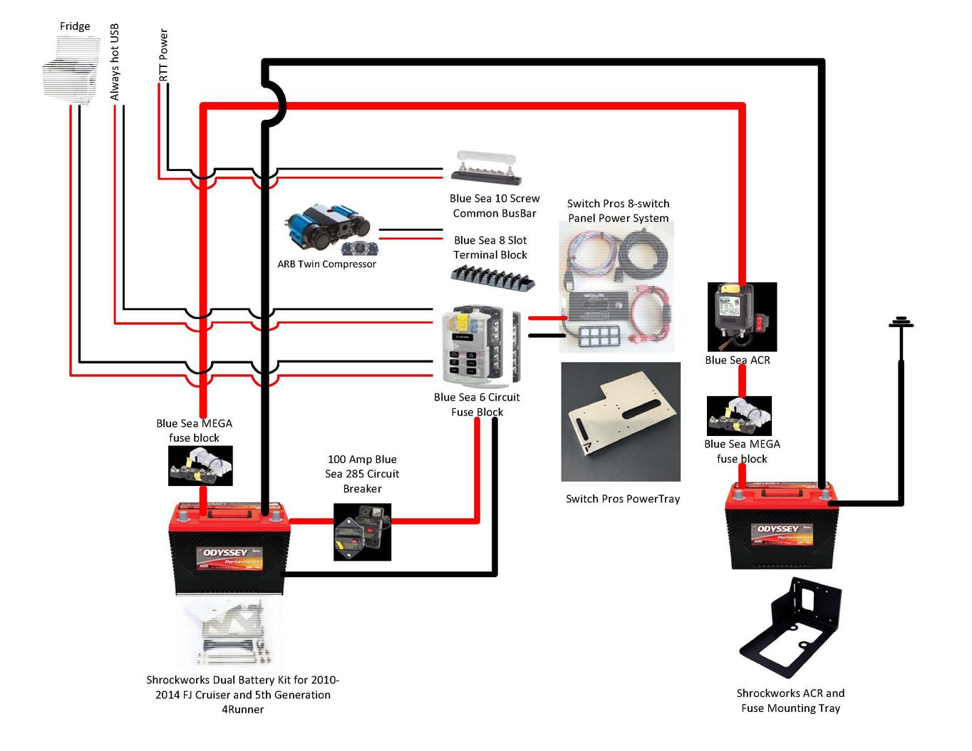

Thanks to all the great advice in this thread! I'm about to tackle this myself and I've been reading every thread and build that I can find. I think I have it figured out but I'm looking for extra eyes as I'm only really experience in AC 120v. Here is what i'm thinking with the parts I'm looking to get.
I think my main question is grounding the Powertray with the switchpro and fuse block. My diagram shows it going back to the house battery but Powertrays sells a ground cable from the ground bus back to the factory ground. Is this Ok? It will be max 100 amp.
Final wire size to be determined via the BlueSea cable sizing app. Cable between batteries will depend on if I chose 150 amp fuses or 300 amp. I'm leaning towards 300amp in the event a winch is somewhere down the road.
A couple of thoughts. First, it looks like you are connecting your switch pro to your Blue Sea 6 circuit fuse block. The switch pro is already protected by it’s own 125 amp fuse and can supply 4 35 Amp circuits and 4 18 Amp circuits. If you connect the Switch pro to that fuse block, I don’t think you are going to find a large enough fuse for that fuse block to supply the Switch Pro. You run the risk of overloading this circuit. Plus, it is excessively redundant. I would just connect the switch pro directly to the house battery; remember it is already protected by it’s own fuse. Second, it appears that you are going to supply power to your RTT accessories off of a BusBar. I would presume that you are going to fuse protect each of your accessories. Again, this is a redundant system and you could overload the 6 circuit fuse block. What I would do with this is put the BusBar between the 100 Amp Blue Sea 285 circuit breaker and the fuse block. I am using the BusBar pictured below in this exact manner. I am connecting 4AWG off of a 100amp main breaker to the main BusBar input, running a couple of small things off the small outputs in the middle, and then continuing on to my 6 circuit fuse block by running 4AWG off the other side of the BusBar.
Finally, I am also using the Shrockworks ACR and Fuse mounting tray under my start battery. I mounted the ACR 7622 on this tray. I found that I it rubbed just a touch against my radiator line. I bent it in by hand just a touch to gain about an 1” of clearance.

Thanks Delgadtn! I did see where you had to bend the line out of the way. That center section of my diagram is confusing. I wont run the power to the switch pro through the blue sea fuse box. Was hoping to avoid 2 wires as the fuse block and switch pro will sit on the same tray but one is 100 amp and one is 125. It looks like the fuse block will accept a 125 amp max fuse for protection so could I use the one line and combine at the positive terminal of the block to feed the switch pro? It won't run through the fuse block as a circuit.
The 10 screw bus bar will be grounding for switch pro accessories and 8 terminal block will be for the positive connections on the switch pro. The Power tray set up is nice with the switch pro and circuit fuse box all mounted to it. RTT will be on a switch pro circuit so I can control remotely. Fridge and USB will be off fuse panel. Only thing else planned is some lights for now.
Thanks again for the feedback. Everything helps, while I've wired houses, this is my largest DC project and I don't want to mess it up!
Sent from my SM-G950U using Tapatalk
Yes. You could do that as long as you watch your amperage. The fuse block and the Switch Pro would be connected in parallel based on the setup described. This circuit has the potential to place up to 225 amps of demand on the system. As long as the wire and breaker used running from the house battery to the block can handle that you would be fine. You would probably need to run 1/0 or even 2/0 in this setting.

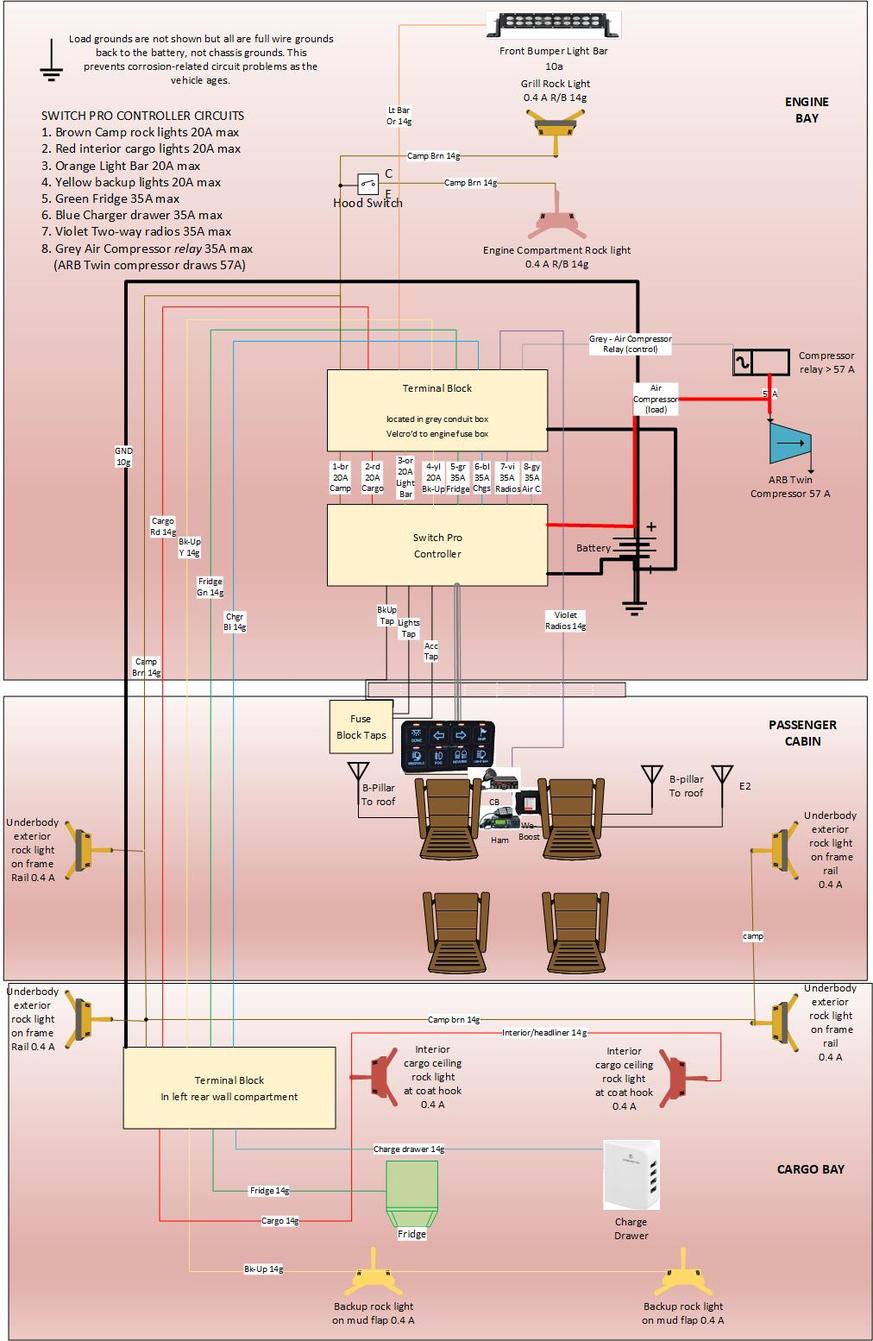

SwitchPro wiring diagram for loads
Since you asked about wire gauges, this is my wiring diagram for my SwitchPro aux electrical system. (There is no second battery at the moment.) It will give you some idea of wire gauges. For long runs to fridges, use 10 or 12 gauge (or heavier.) For lighting, 14 gauge (light bars) or 16 gauge (rock lights) works well. For each piece of gear, read the mfg specs, total up the amps, and use one of the online electrical calculators to find the best wire gauge for that circuit, then make sure it won't exceed the SwitchPro 20A or 35A circuit ratings. I absolutely love the SwitchPro 9100, by the way. Worth every penny.
