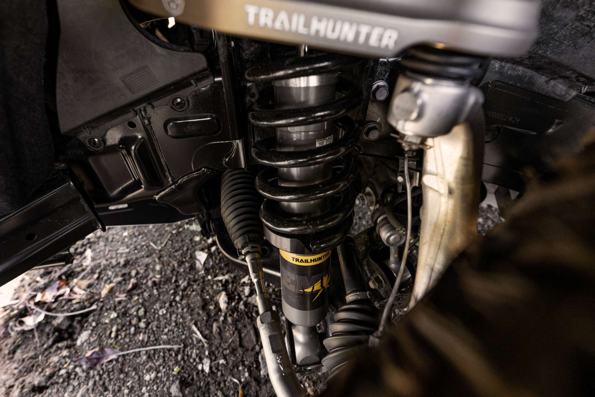

I found some info on steering but not on the rear axle ratio. Note the necked down tierod.
That tierod does look small - but it depends on what it's made of and the leverage ratio with the tire, so maybe it's okay?
3rd gen Tundra looks pretty similar. Hard to tell if it's the same or not.
LC300 does not appear to be necked down. Possibly it's an engineered failure point and the LC has a more robust steering setup. I think the Tundra is an electric rack and the LC is hydraulic rack with electric steering on the steering shaft. Or it could just be the nature of how they are designing them and they all start with the same basic design and as you lengthen that link it uses a tapered shaft. The Tacoma and Tundra having longer shafts have a longer reduced area and the LC300 has a narrower stance and the threaded portion ends up right at the end of the hex portion for the wrench to fit. 2024 Taco Pro and TH models are 3" wider than the std model. Assuming std model track width is 64" that puts the others at 67". LC300 is 66.4". Not really sure why they wouldn't use the same parts if they did share the same steering rack. Looks like Taco at a minimum has a narrower rack.
[MENTION=118321]Jetboy[/MENTION], the Tundrua tierod is a larger diameter overall and the necked down area is part of the forging.
The Tacoma tierod has been machined down at the neck after forging. The neck down will snap first, before the threaded area, making repairs eaiser.
It's possible it's just part of being a prototype?
It seems unusual that they would add a machining step to a production version of that part.
It's an interesting engineering problem that I haven't every really thought much about. If it's going to fail it'll almost always be from buckling. And it'll almost always be on the inner tie rod because it's weaker. And then it would make sense that the maximum tension on the buckling assembly will be at the joint between the more rigid outer TRE and inner TRE. Add in the threads as a stress concentration and it seems like where it should be expected to fail most of the time. A thinner diameter section shouldn't help this. It would be more prone to buckle out of the column and would still fail at the threads unless the idea is for it to be elastic deformation at the narrow point. I'd love to understand more about the design and testing. The LC has no narrow section, tundra does, and Tacoma has a very pronounced one in this image. I think the strongest design is the LC version with the shortest inner TRE and no narrowed section.
Jetboy, it seems way too late in the process for Prototype parts, I would think at this stage they are either pre-production or production parts.
I completely agree that it seems unusual that they would add a machining step to a production version of that part. From my engineering knowledge, I to did a double take when looking at the photos closer. However, the bright surface of the necked area, to me, suggests post-process machining. Below are marked up photos comparing the two.

A necked tie rod does not inherently make anything stronger or less failure prone, but it does control the failure point. I like the idea of moving the failure point away from the threads. Would just make field service that much easier if/when needed.
The Ford Suspension Engineer I know, who first noticed the neck down, concurred it is machined, but is not a typical production step, so Toyota may be trying to minimize the failures by more closely controlling the stress point.

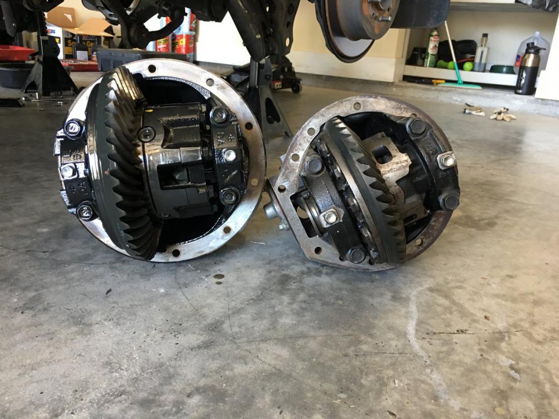

I haven't kept up--how does the outgoing Tacoma's rear axle compare to the 5th gen's rear axle? I swear I've heard that the 5th gen 4Runner got a beefier rear axle than the 4th gen, and the 5th gen gained an inch in factory tire size while the Tacoma never previously did.
The 5th gen 4runner rear diff is significantly stronger than the 4th. The ring gear is marginally bigger, but it's reinforced with more bolts to the carrier. The big upgrade is the pinion though. The pinion diameter got much bigger and the main pinion bearing is huge. So less deflection and less breakage.
The current Tacoma is usually called an 8.75 but in actual size it's really about 8.9". It makes a lot of sense to just bump up to 9.5. The new taco has a smaller axle in the basic models and the 9.5 in the higher output turbo and hybrid models. Other big update is rear discs.
Not really sure why the 9.5 over the 8.9. They're pretty close. Interestingly the 9.5 is probably stronger than the axle in most half ton trucks. The current version is very robust. It should handle 40s without any upgrades. I hope the front is equally strong.
For rough comparison below is an 8" vs 9.5.
