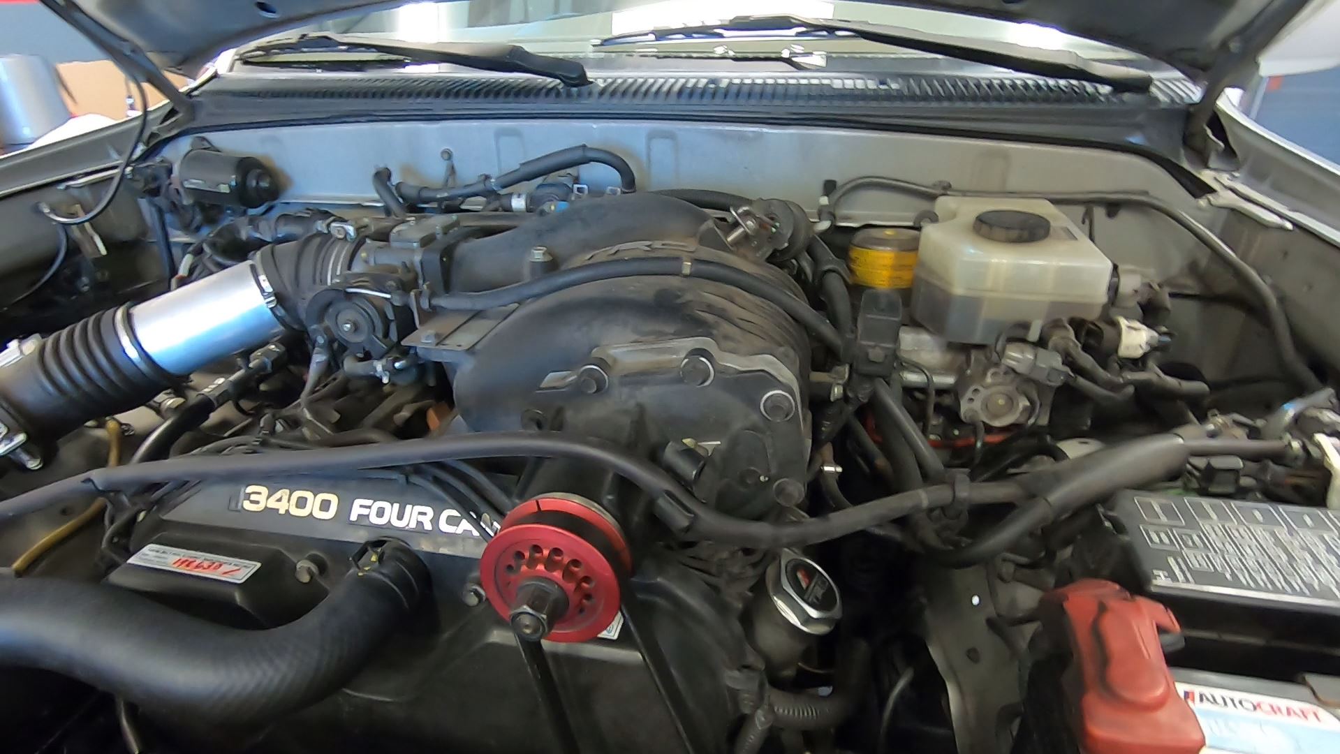

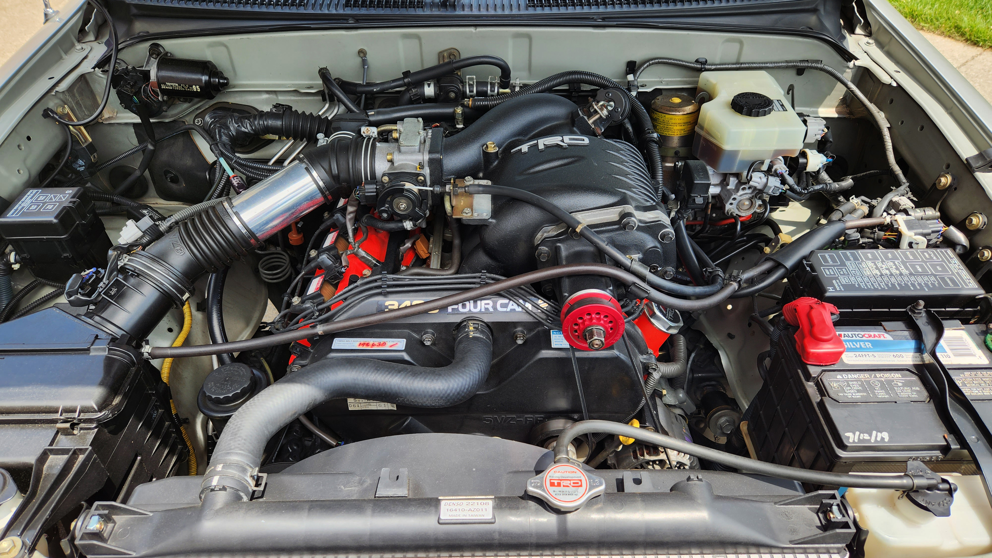

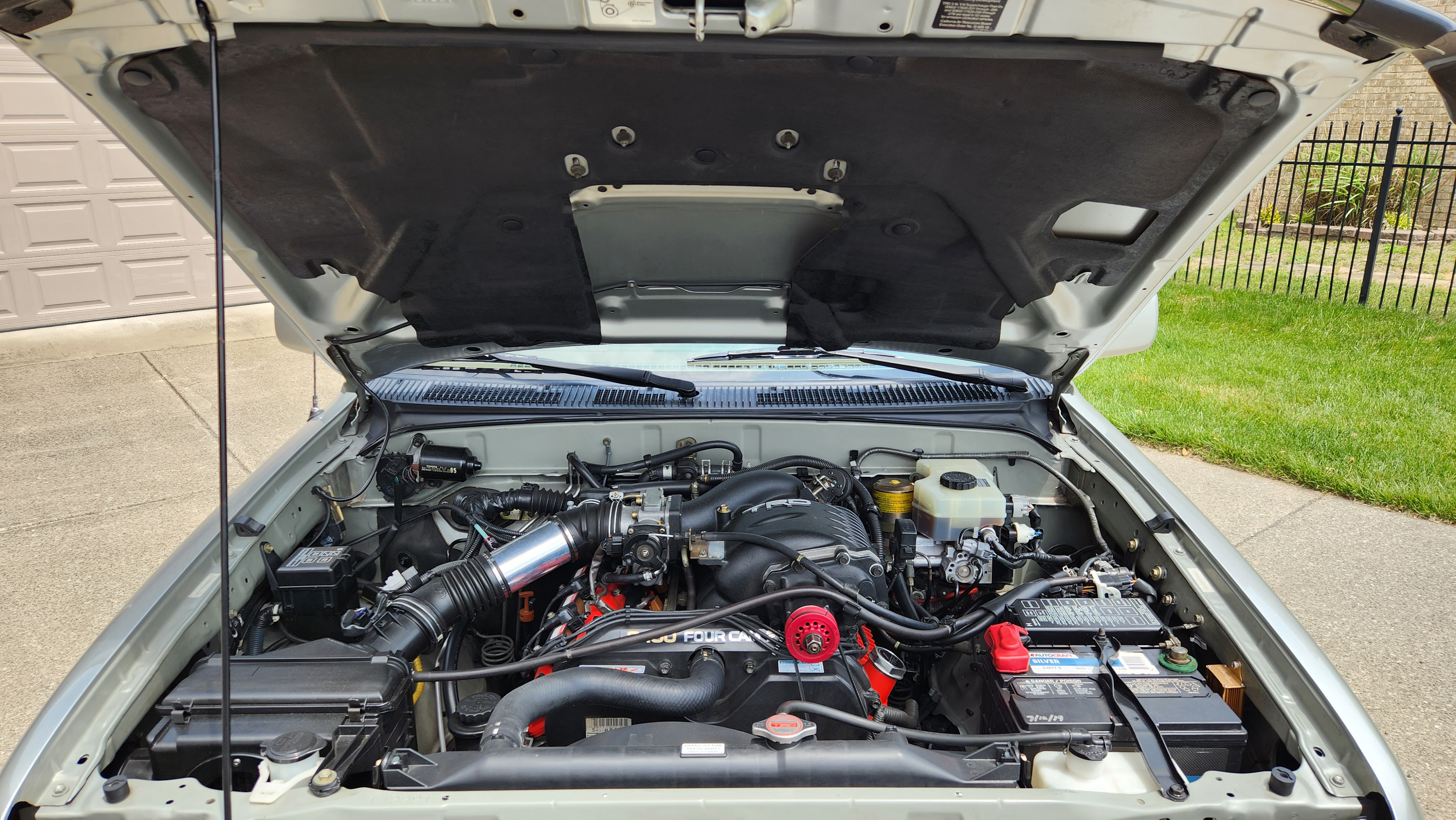

I used to do a complete detail on the o'l 4Runner at least once a year but with other vehicles joining the stable it sorta got left behind. After getting the valve cover gaskets all squared away, I thought I might have a rear main seal leak. I decided to do a full detail of the engine bay and underneath so I could see what's what. Using the right technique it's actually easier than I remember. Bonus I tried some dye on the hood liner and it worked great.
Video in 3rd post.
Next up, I gotta see if I can save my tow hitch.
Dirty:
Clean:

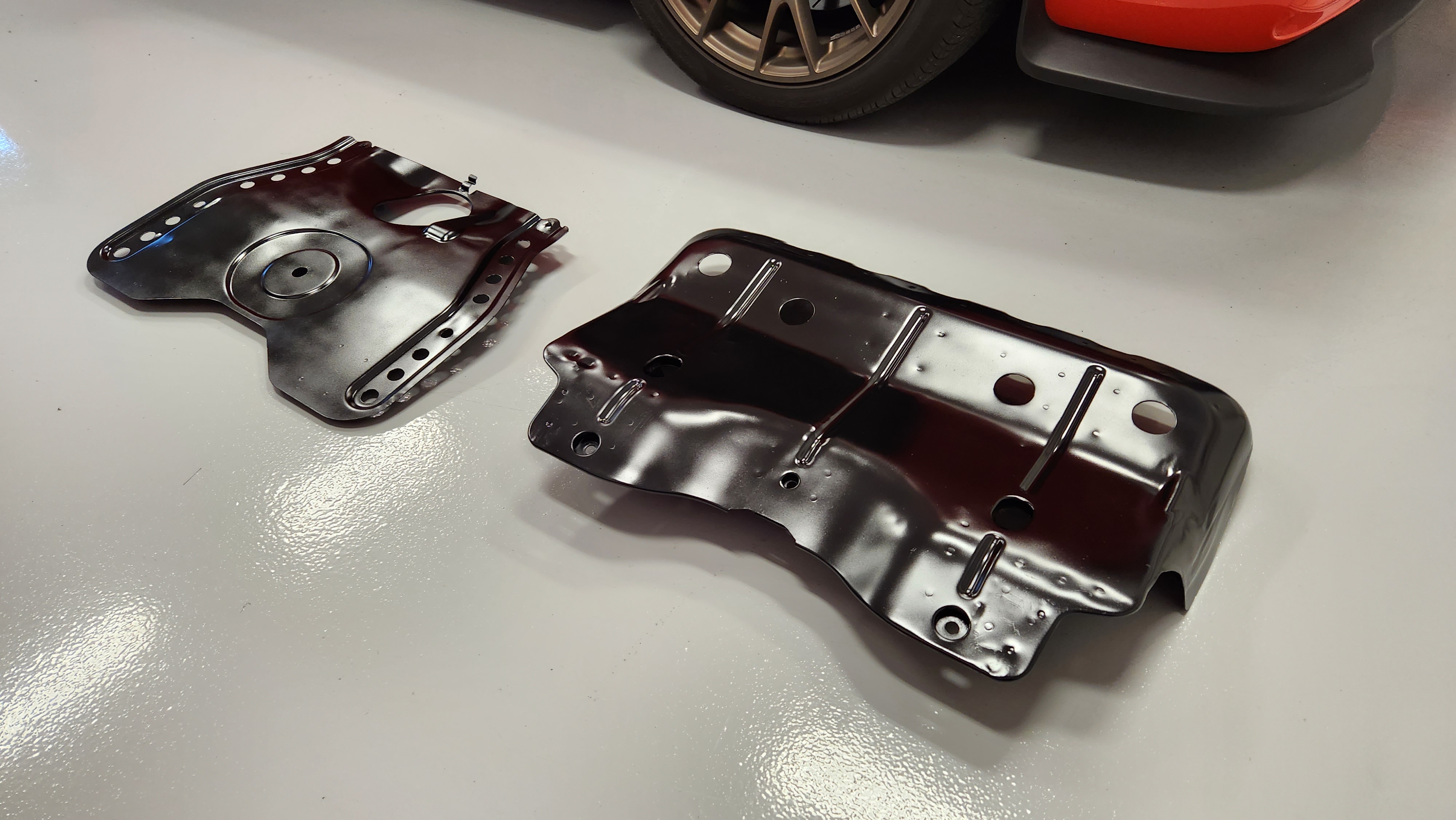

Decided to recondition the skid plates while they were off for the engine detail. Fixed one small dent and noticed a small rusty spot in the back corner of the bigger one. Cleaned all that up, hit it with some rust reformer, paint, and then put some FIPG around the seam to seal it up. I think water was collecting between the two stamped pieces.

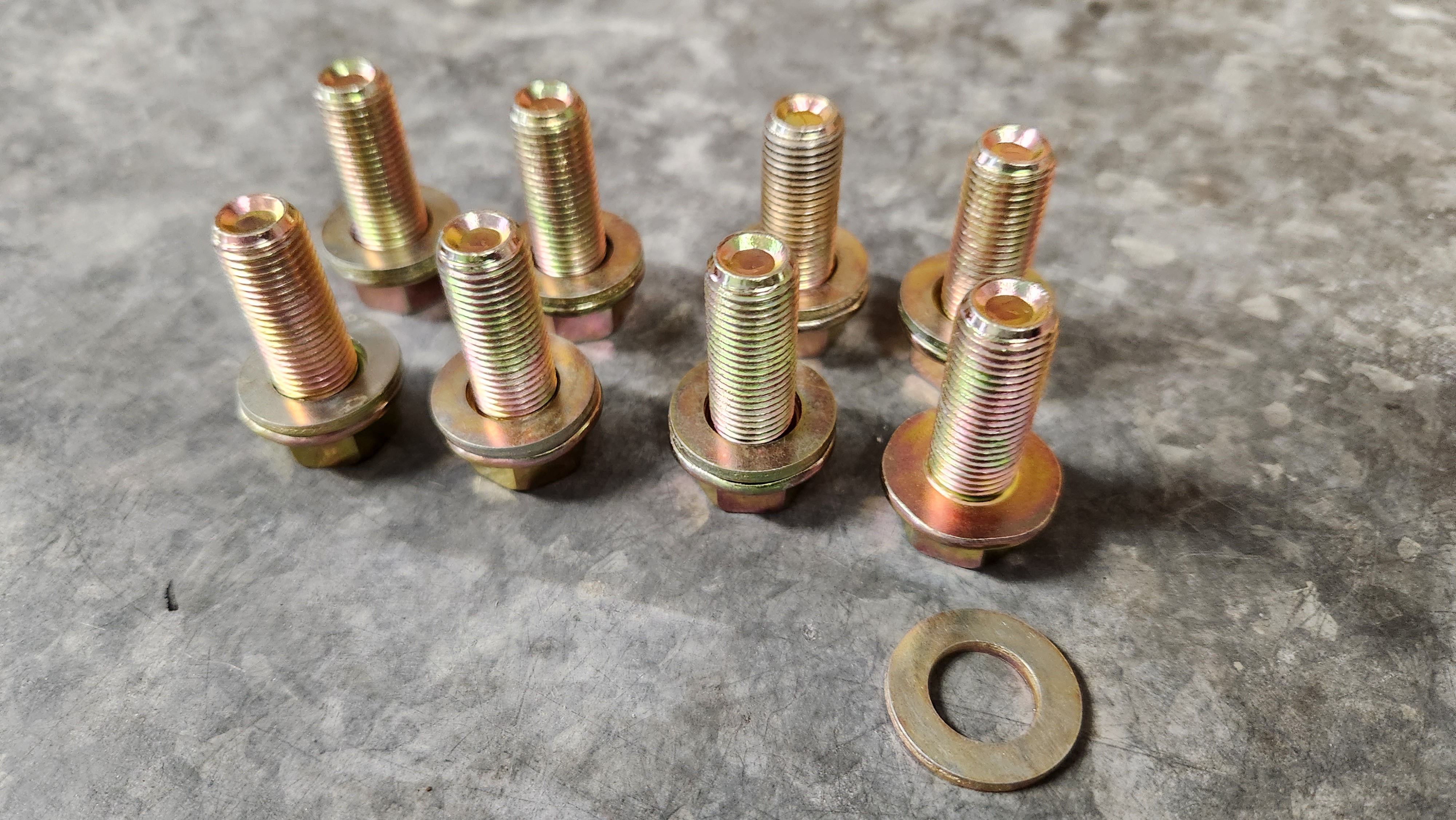

New tow hitch hardware showed up I went with 10.9 grade. I hope I can get the factory bolts out without too much trouble or destroying the Z brackets. I'm a little worried what it's gonna look like in the frame after 21 years. I've started soaking the bolts in Liquid Wrench.
I bet you're right. I'm gonna hope for the best. I don't remember ever having the hitch off the truck.
I pull them when I work on the Frames. As it makes it easier. I expect yours to come right off...:)
