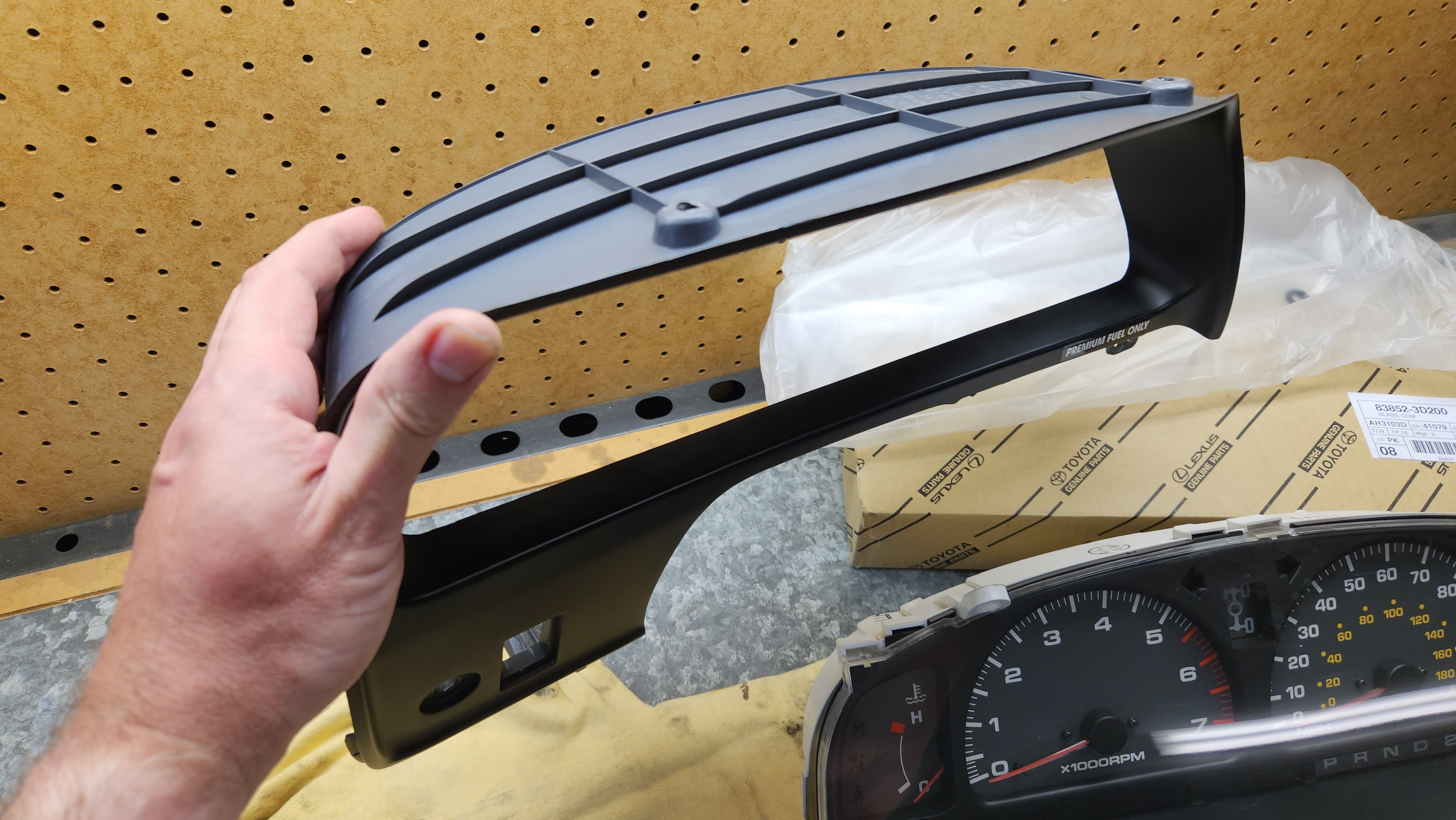

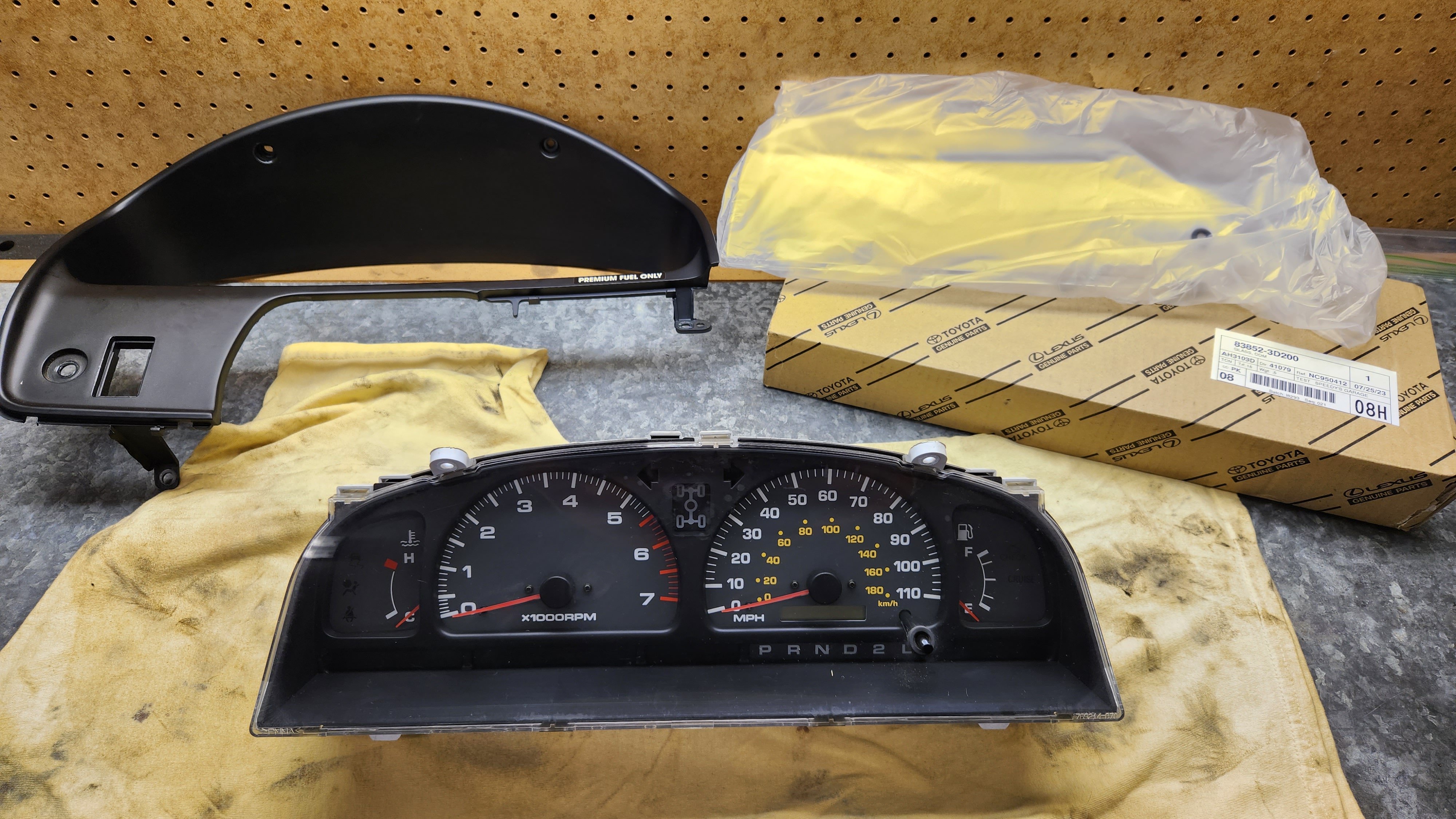

Put in the new gauge cluster lens and polished the original as a spare. Interestingly my gauge bezel was grey on the back side. Makes me wonder if Toyota made all of them grey and painted the front black for black interiors?

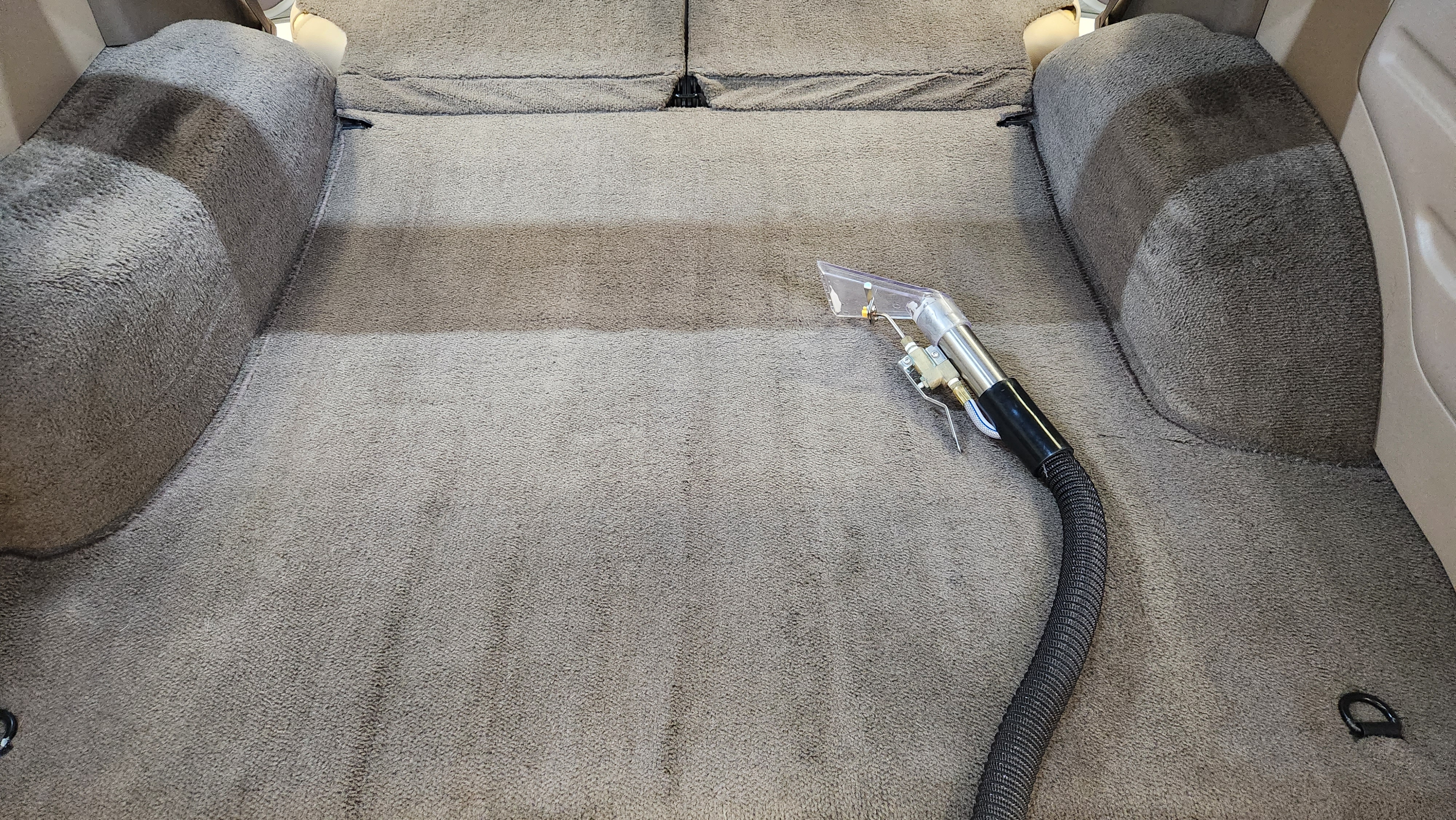

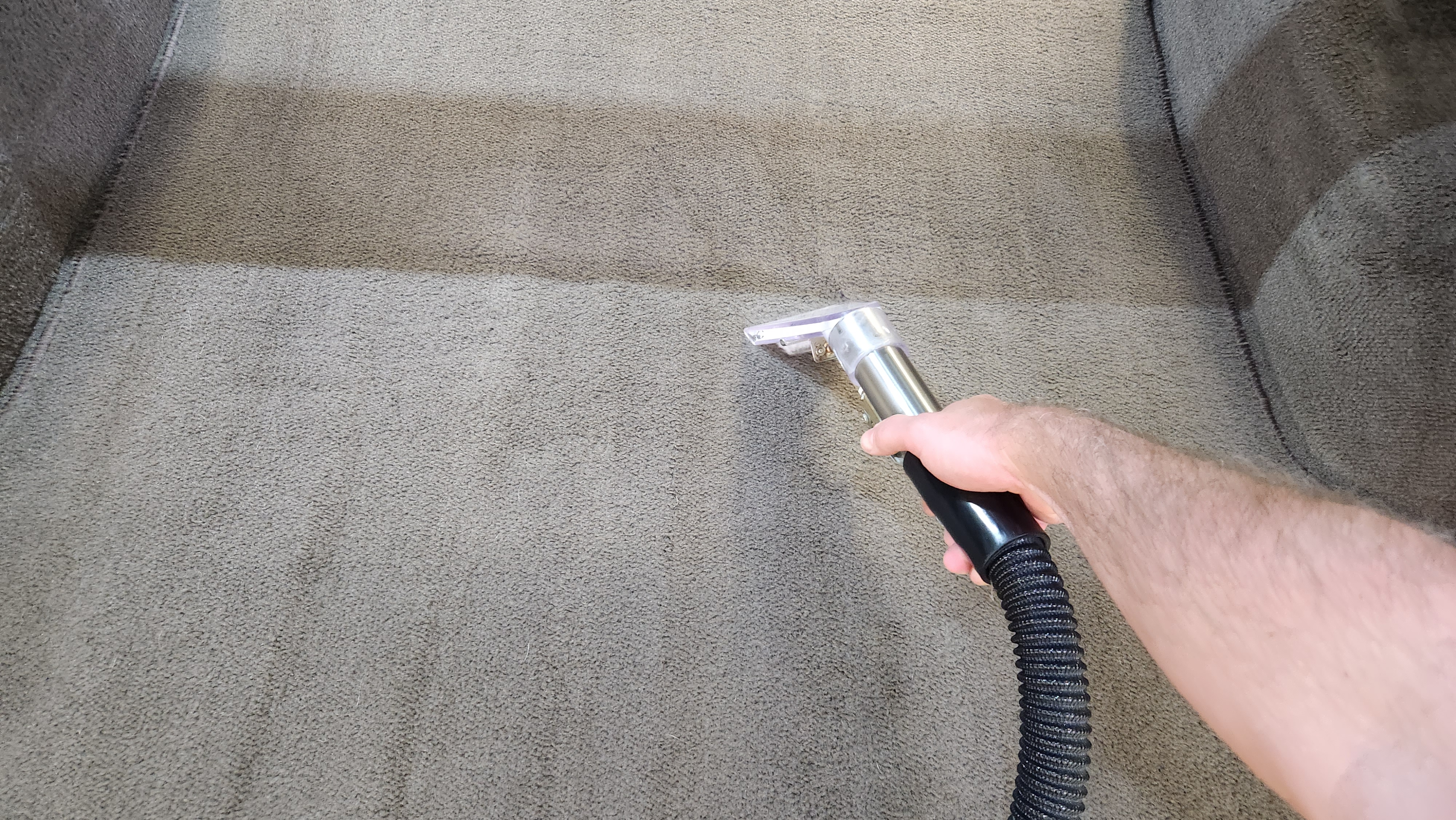

Shampooed the carpets this weekend and they needed it. Spic and span now.
Rented an "extractor" from local big box store for $30/24 hours and it worked awesome with a 20% solution of lavender simple green and hot water.

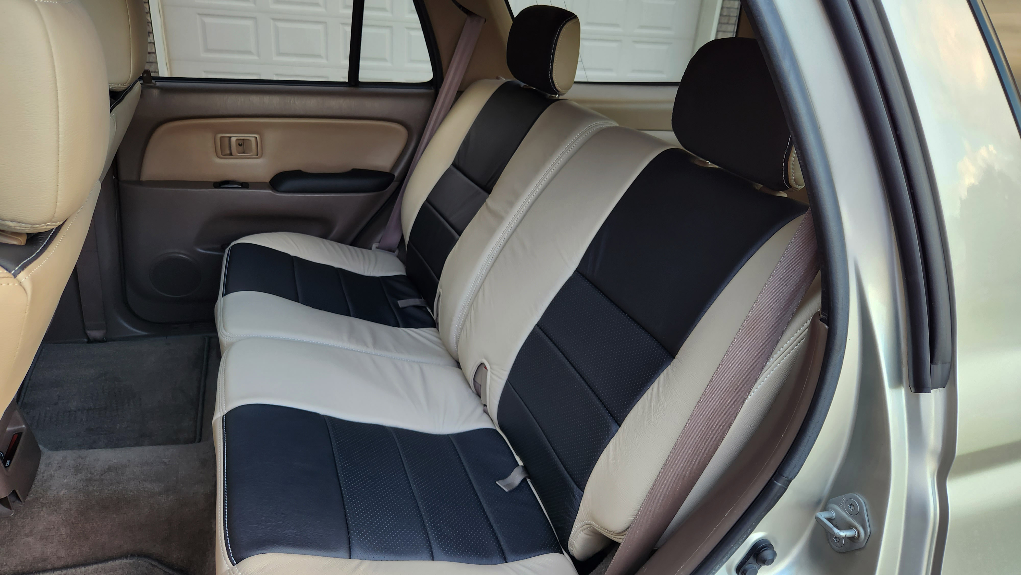

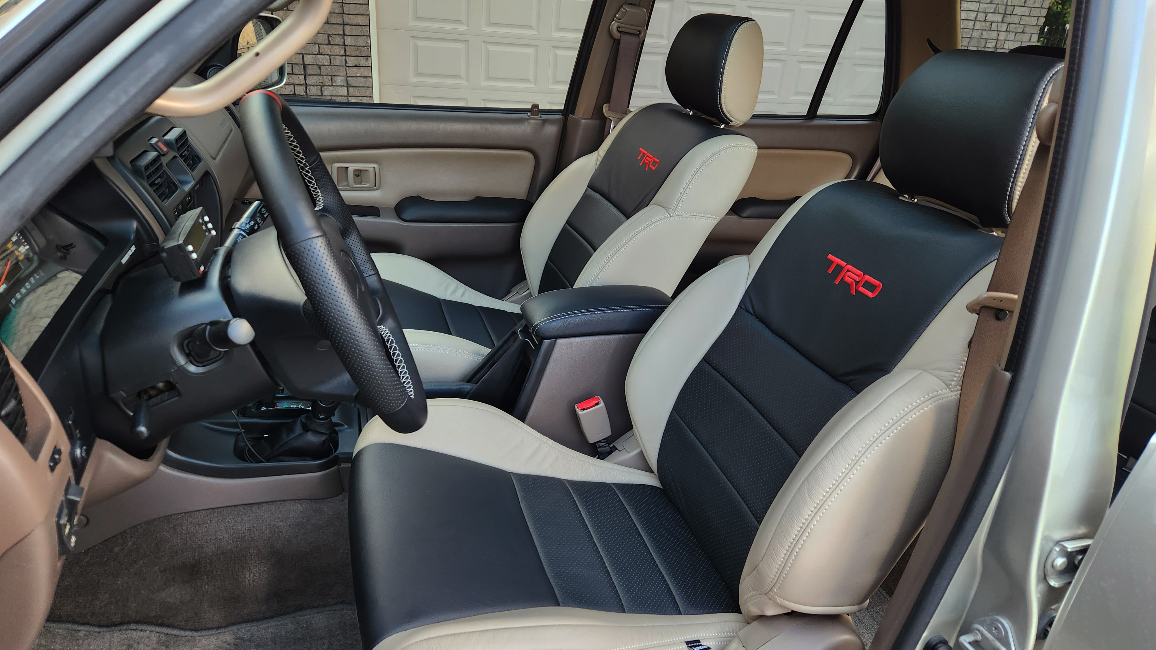

New interior is in. It's Katzkin as mentioned earlier and looks great. Much higher quality than the original leather that came in the truck and I added heated seats which are better than OEM heated seats in our other cars. Katzkin seats came from Affordable Auto Leather in Tuscon, AZ. Found him on the Tundra forum, good customer service and a good price.

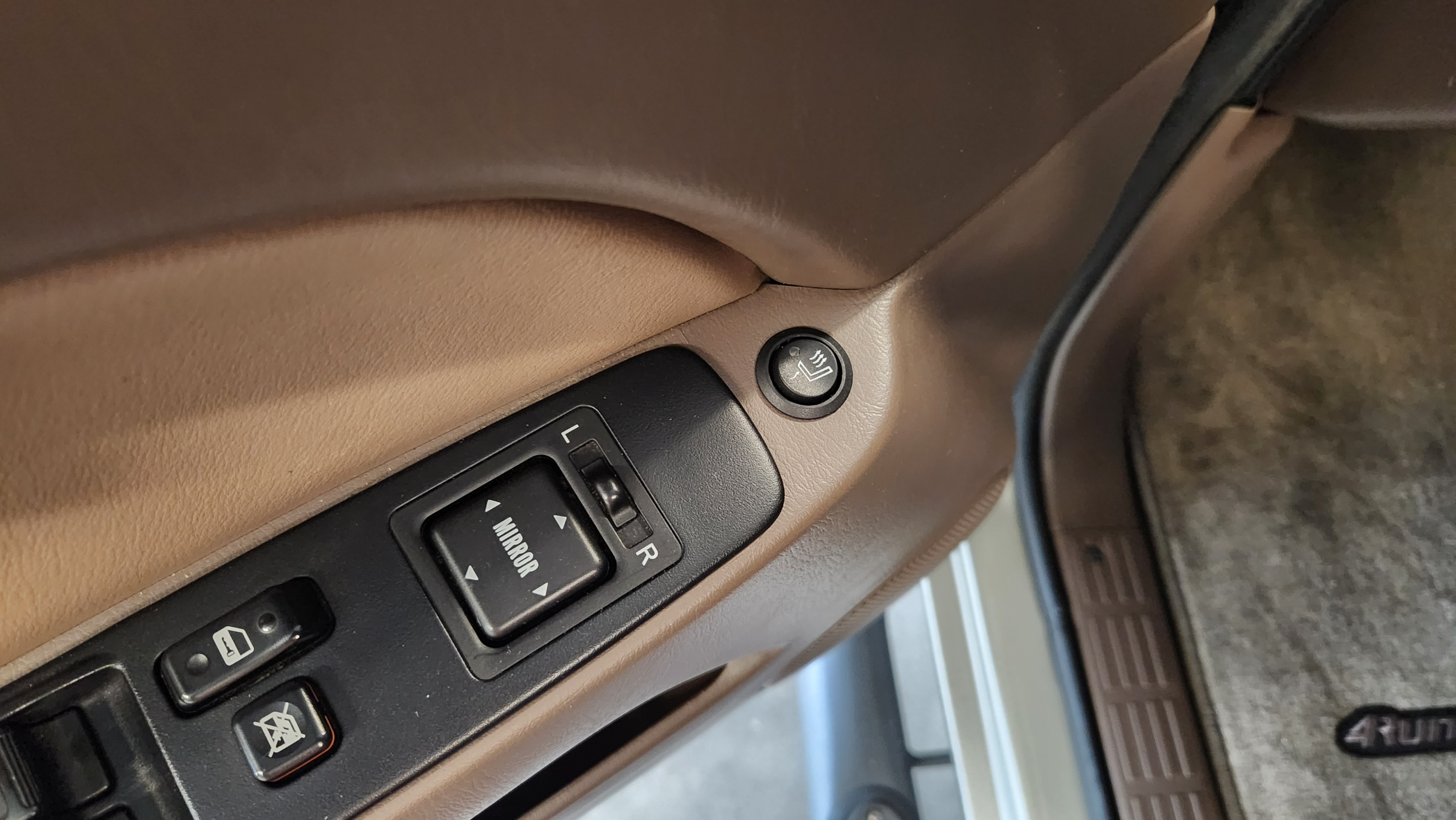

Factory heated seat circuit I tapped coming from the back of the fuse block in the engine bay.
Those seats did turn out very nice . :)
Sent from my SM-A536V using Tapatalk
Thank you sir. The pics make the biscuit color look a tad light, but it's the light. They're lighter than original which I wanted to brighten up the interior, but darker than they look. You can kinda get an idea in the pic of the back seats where you can see the back of the front seat. I'm having to get used to the new height since the foams were all replace up front lol.
I think the heated seat switches came out nice in the arm rest location as well. Super convenient and better than OEM in my opinion.

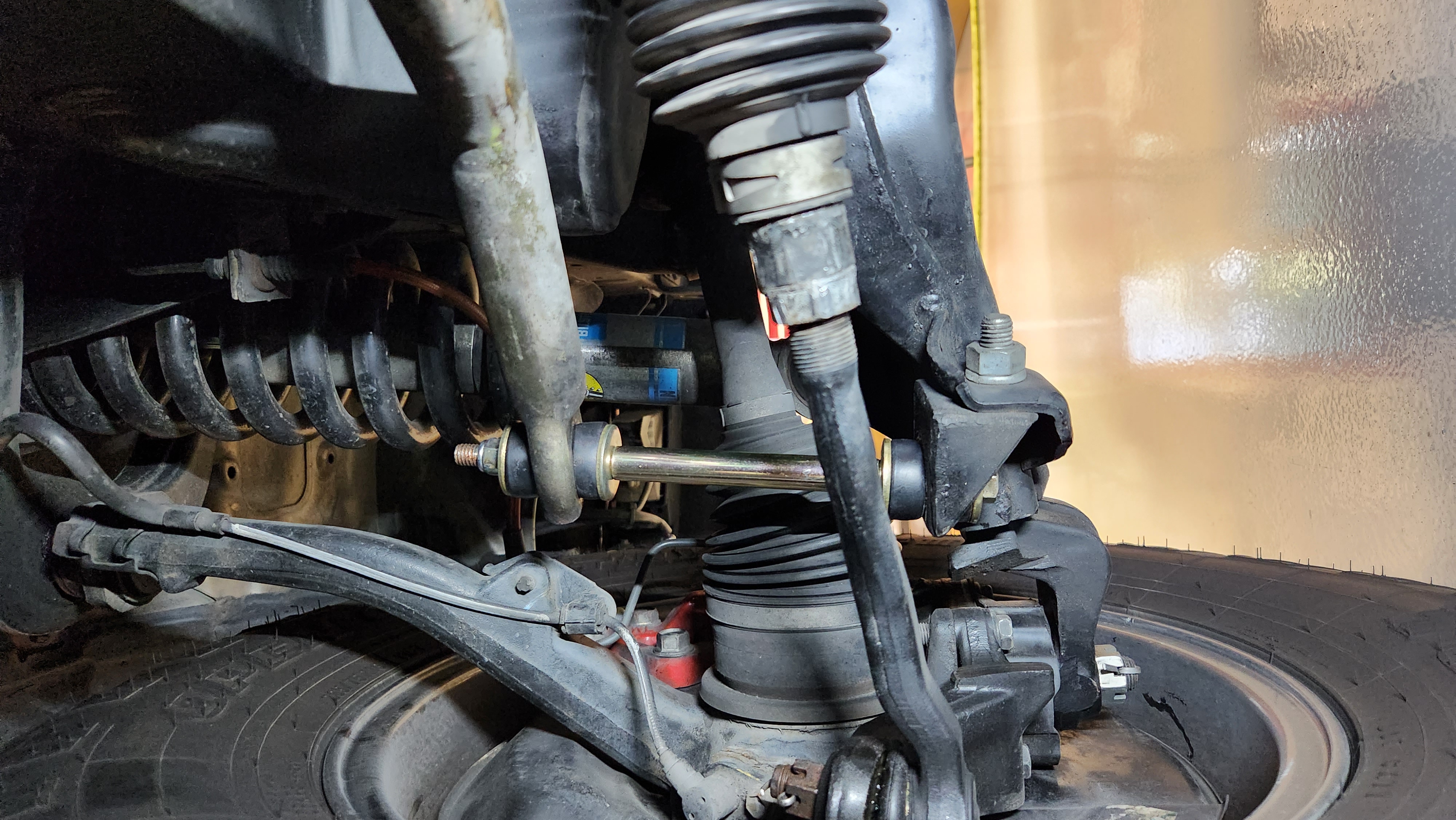

Looks like I'm gonna need some longer front sway bar end links. I did notice the sway bar is pulled down a bit up front but thought it would be fine since it drove OK, but when the tires are off the ground on a jack I can see the steering rack boot (and inner tie rod) will make contact with the sway bar. This would be a very rare occurrence, but I'm OCD and want it right.
I've got Addco say bars, so I need something probably 2 inches longer but that are straight. I can probably build my own with some 9 or 10" long grade 8 bolts and a stainless (or other) 1/2" OD tube. Anyone know of anything premade? I'd rather not go with some $200 adjustables, disconnectables, etc. Wanna keep it simple.

2nd Gen Rear links are what you want. That's what I ran on my 99 when I had the Tundra front springs and about 2.5 inches of lift.

I don't think those will work with the Addco sway bar up front. The end link needs to be the straight type without 90° joint.
I found Energy Suspension makes "universal" links like I need you just measure for size. Something like this should work:

The 90* joint is on the bottom (a-arm) side of things - or am I missing something? (I have addco bars - the stock arms seemed to work until I bent them and upgraded to disconnects)
Addco bar with worn and bent stock endlink:

Where the link in your image connects to the lower A-arm, mine has an add on triangular piece that bolts in (supplied by Addco) then the link goes through that straight through a hole in the top.
Front sway bar end links replaced with Energy Suspension extended units. This solved the problem of the sway bar hitting the rack boots at full droop. Unless it's my imagination the ride is greatly improved as well. Maybe the sway bar being pulled down was causing it to be firmer than it needed to be dunno.
However, as a results of my error the steering rack boots have small tears in them where the inner tie rod rubbed the sway bar, so I have to replace the boots next :rockthrow:
These Energy Suspension end links are much beefier than the ones that originally came with the Addco sway bars. Took care of the oil change while it was in the shop as well.
