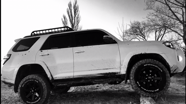

Regarding the load rating, I went back and forth between the C and E rated 265's a month ago when I purchased mine. If you check the C rated 265's load capacity exceeds the rear Axle weight rating.for the 5th gen 4runner. Regardless of the tire weight rating this is the number the truck is rated for. I ended up going with the C load rating, I wanted to minimize the tire weight increase.
^ that looks awesome. I just went with the 265's. I essentially got them for $594 shipped with no taxes, so I couldn't pass them up. Plus I will be on stock suspension for the foreseeable future.

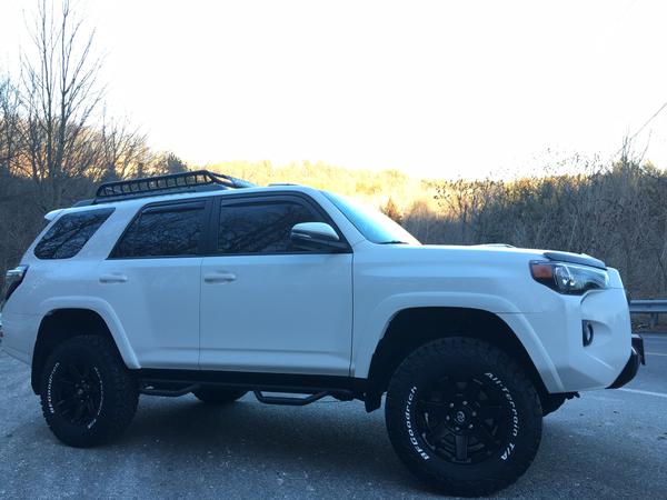

Put them on February 1st along with the front Bilsteins set at the top notch and Daystar 1.5" spacers in the rear. First time lifting/installing bigger tires so I don't have much to compare to; was completely stock before. Love the looks and the loss of nose dive. Heading to Hidden Falls Adventure Park tomorrow morning to take the easy to moderate trails - no armor and it's just me and my wife going so the plan is to take it super easy. I'm running 40psi on the road and plan to air down to 20psi for the trail.
