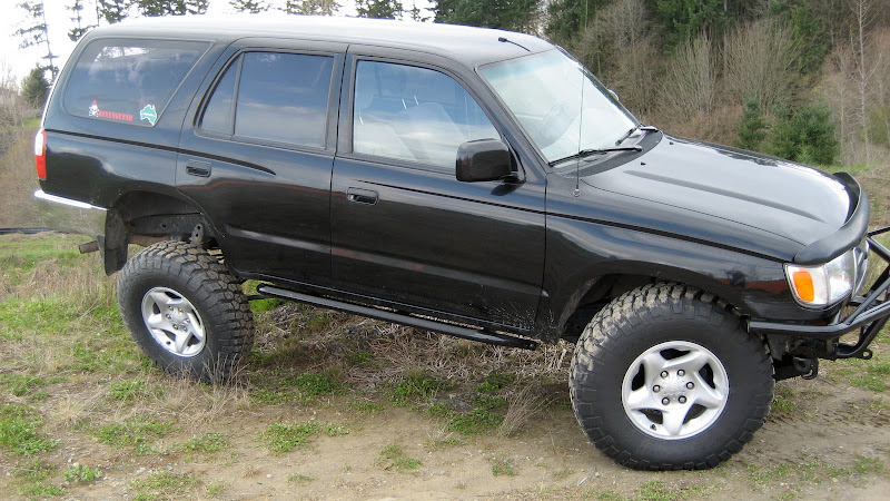

You know what's weird is we have the exact same truck, and totally different experiences. I've never rubbed once (just kisses the edge of the frame at fulllock/stuff) with just a ~3.5" suspension lift, 882's with 5mm trim packers. I'm looking to drop mine down to save cv's and have a better COG. So from my experience with BFG 255/85's I would say a 2" lift with a minor beating to the pinchweld would be all you would need.

Yeah, I can take some measurements tonight. I do sit higher than any OME set-up I've compared it against (about 15 vehicles now) so I know I'm not low by any means. My heavy duty springs make me sit a little higher than medium or light duty OMEs (i.e. 881s/890s). I also have a 1" BL, so I should be a little higher than you with 882s and trim packers (unless you have a BL too).

BTW, in your 2nd pic down rusm, it doesn't look like there's any way you could go through the whole range of steering stuffed like that without some rubbing (or cutting your fenders way back).

The second pic down is an optical illusion, there's actually a lot of room like in the first pic at the top. I wonder if the fenders have anything to do with it? I notice the brian2sun your truck has the limited fenders and it seems like the people that have rubbing issues all have the limited fenders? Or do I have some out of spec springs from OME? I was only supposed to get ~2.5" of lift with the set-up I have, not the 3.5" I ended up with. I'm curious to see some fender measurements.
Yeah, I'll ry to get some measurements tonight. I'm down to go wheelin! Are you in Socal? My flares are the SR5 flares (a little bit smaller than the Limited ones), but where they mount doesn't affect rubbing for me - they actually end short of the body.
