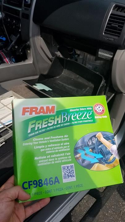

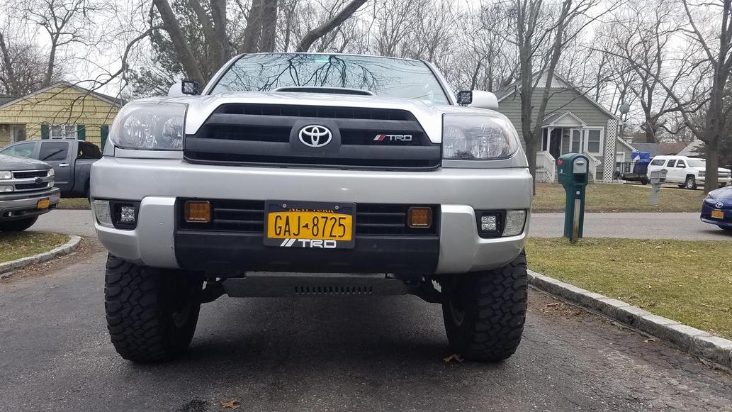

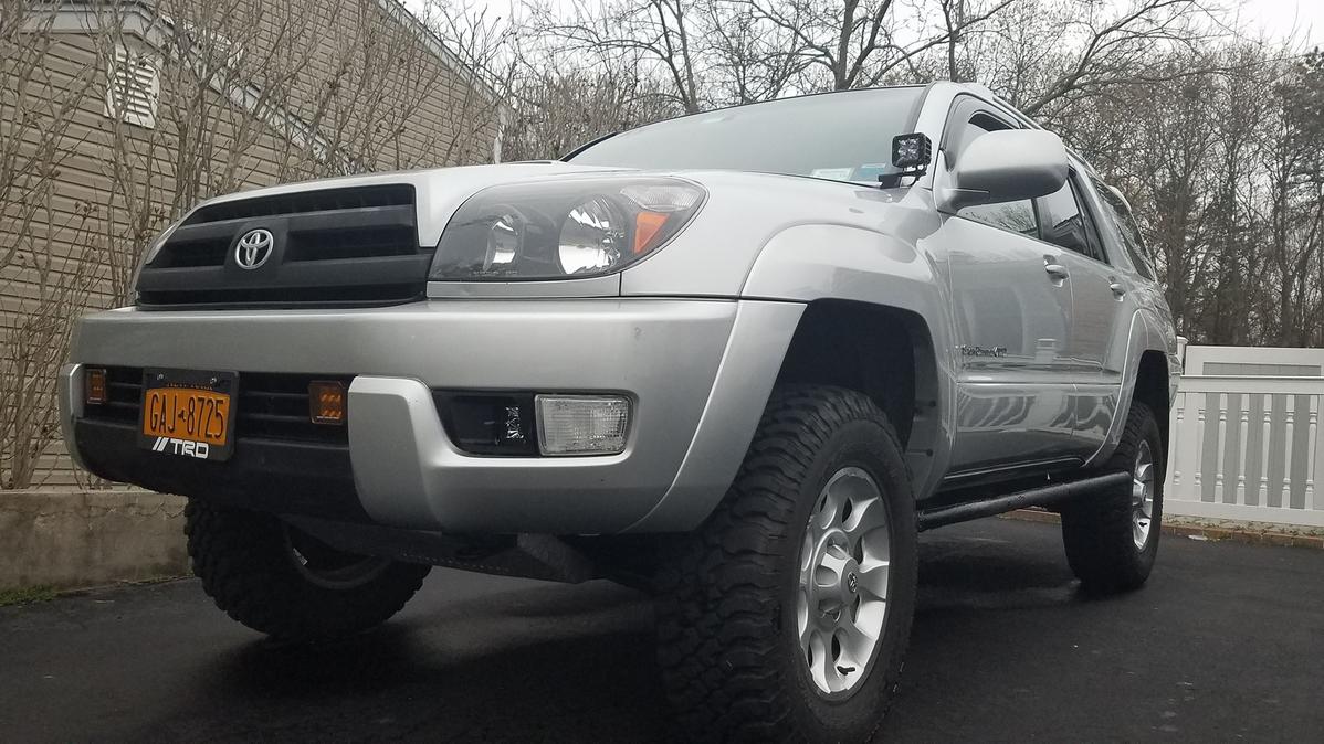

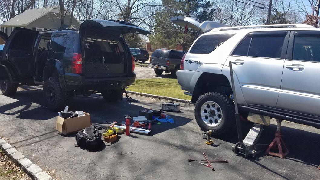

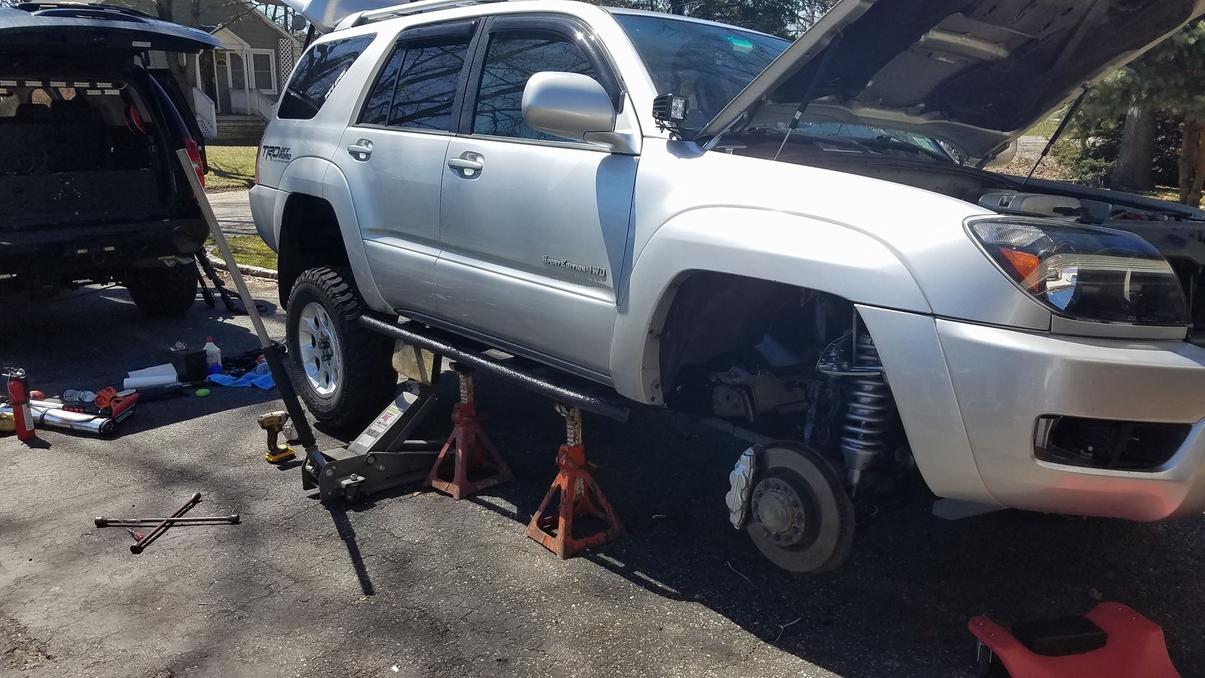

Took advantage of the somewhat warmer weather today got a few things done.
- New cabin filter
- Cut and trimmed wheel wells to eliminate and prevent future rubbing
-New turn signal and DRL housings
- Rigid dually fog lights with 3d printed inserts from @TIN - still need to wire them in

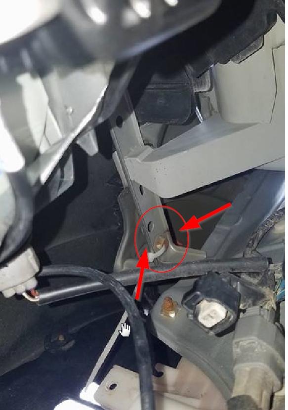

-Fixed the only squeak my truck makes going down the road with a zip tie, which in the inner fender well where the fender attaches to the body.

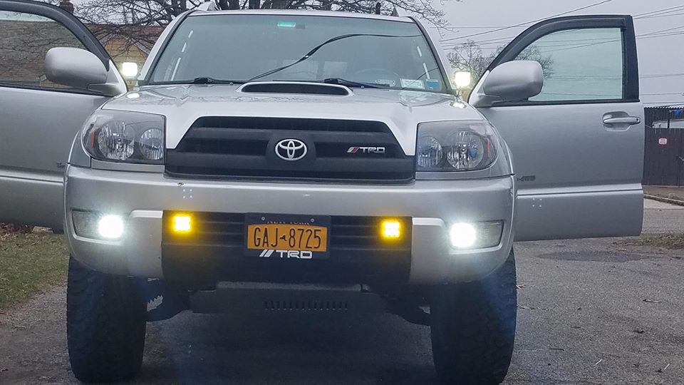

March 26th

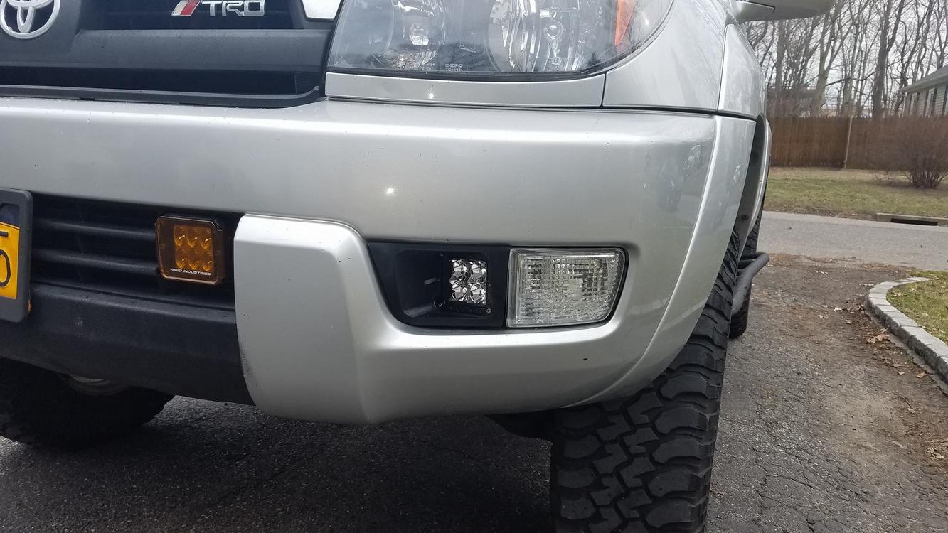

Finished wiring up the Rigid dually flood lights in the stock fog locations.

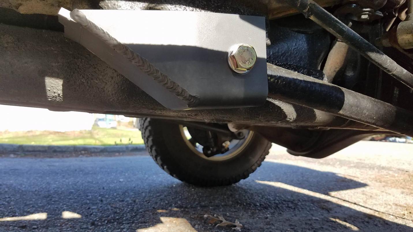

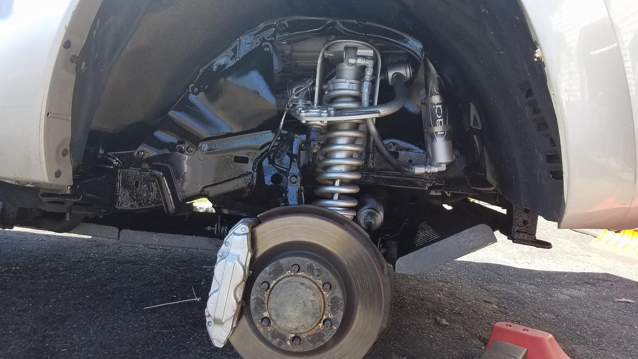

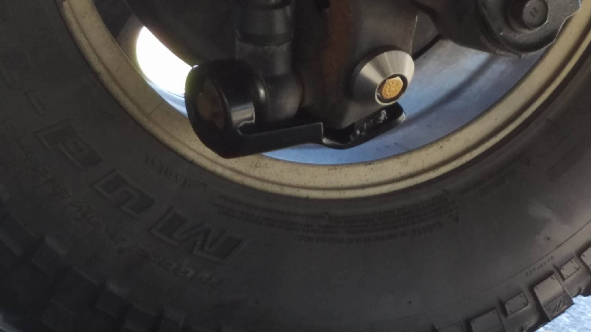

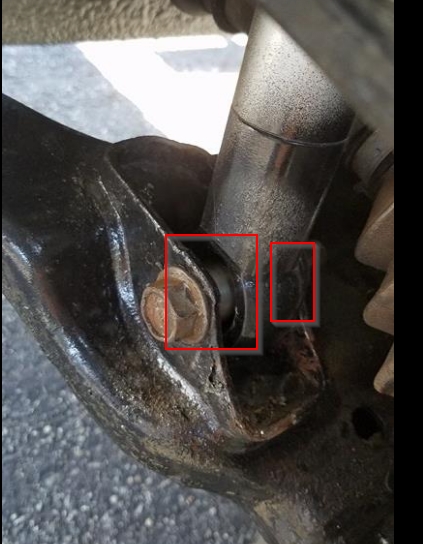

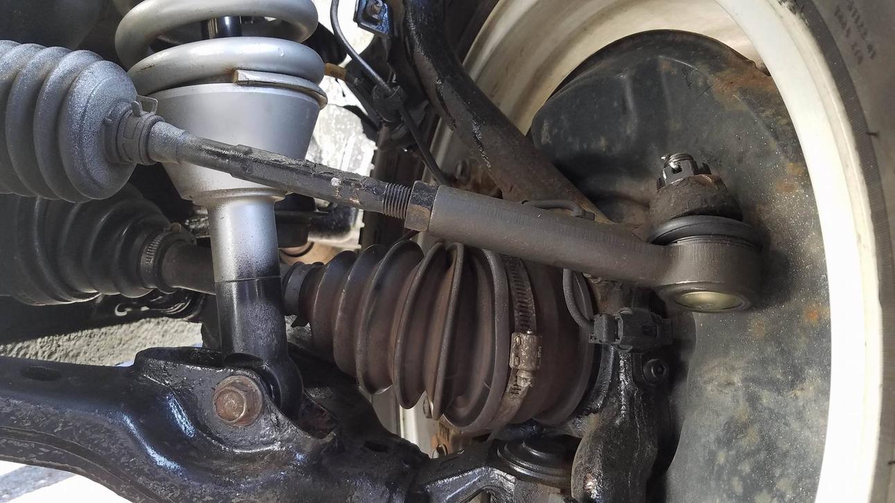

- New outter tie rods
- All Pro Rear lower Link skids
- FJTOYMAN Rear Lower shock mount skids with bolt protectors
- Front coil over lower shock bolt bushings replaced from radflo

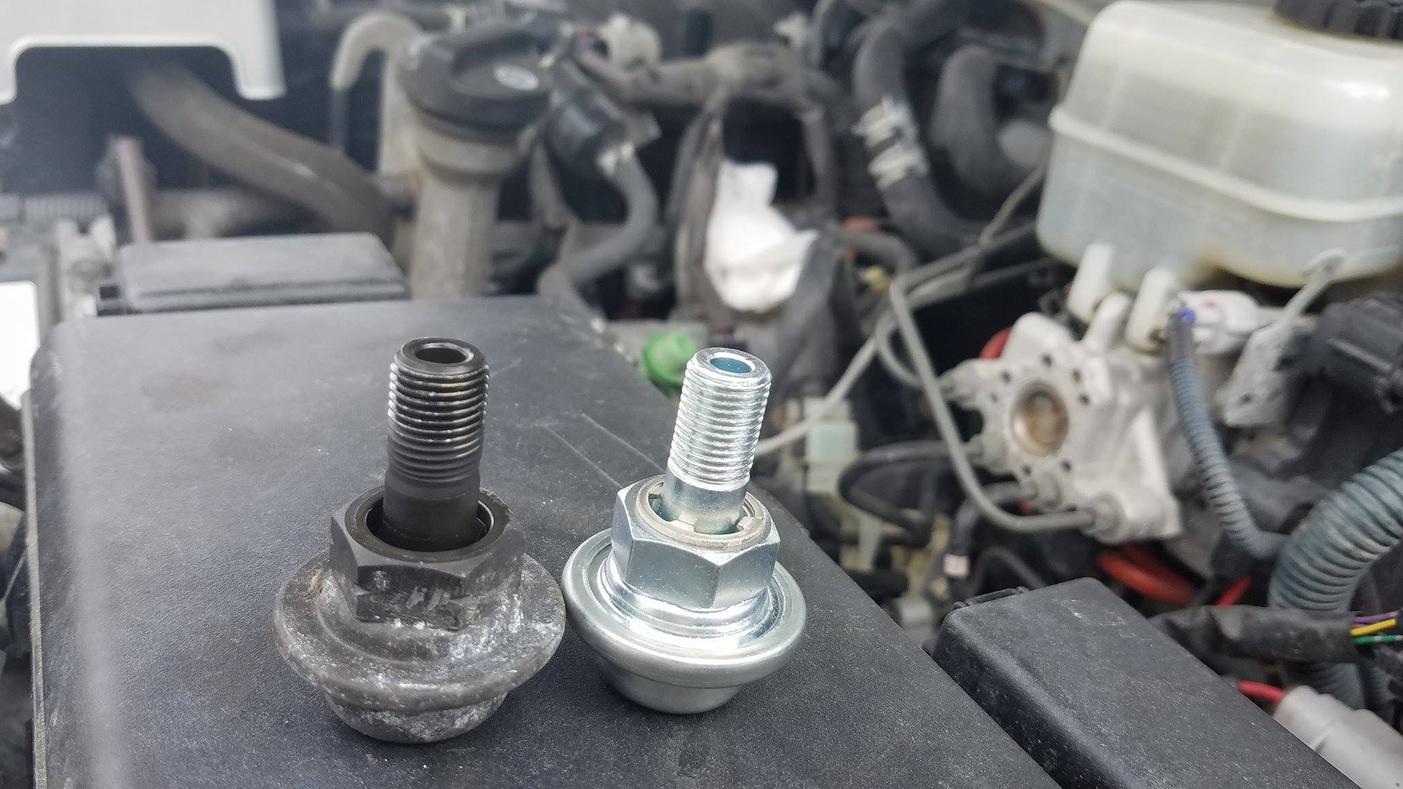

Replaced the Fuel pressure pulse regulator today. Apparently the little diaphragm in these wear out and cause hesitation and an annoying clicking noise mostly when cold.
- Also put on a new diff breather

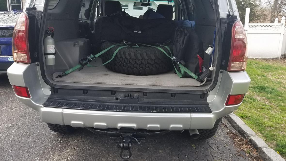

April 27th-

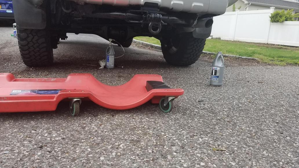

Changed out the Rear diff fluid with some Mobile 1 synthetic 75w90
Greased the driveline with Polytron EP-2 Li Complex Grease
Washed and packed it up to head out PA for the FJ northeasters event!

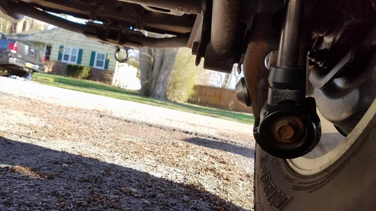

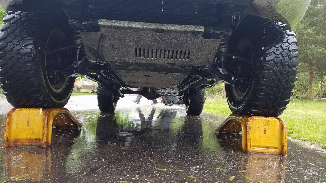

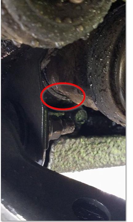

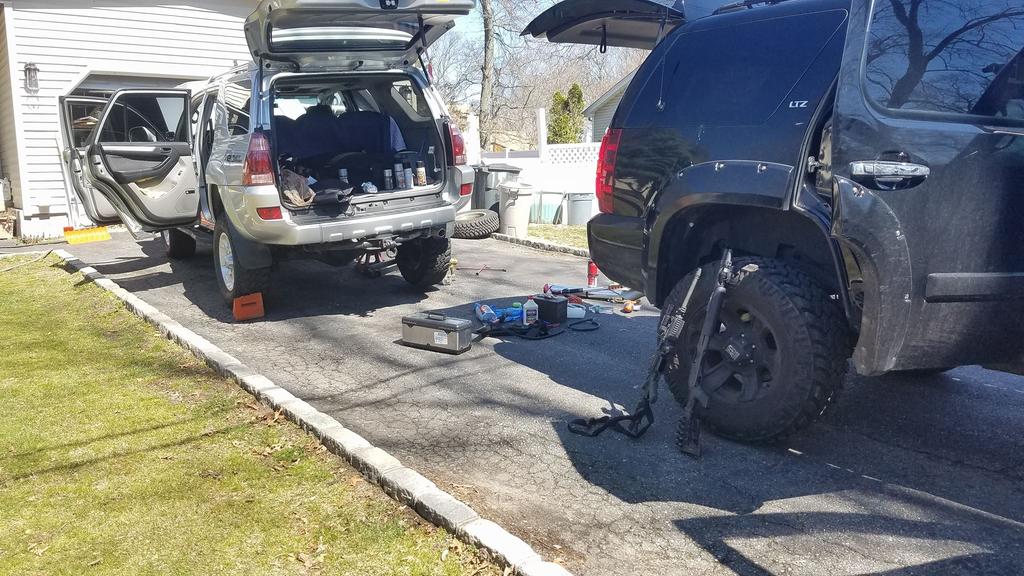

Under body inspection, removed skids...Changed out the Drivers side front Differential Axle seal. It was original and started leaking. Getting ready for the
"Krawlin For Cops" event at Rausch Creek PA on june 3rd
- Looking into some cargo storage solutions, considering some front runner cargo boxes.
-1 inch Body lift and body mount chop coming soon.
*I remember to take pics after I already started cleaning up underneath.

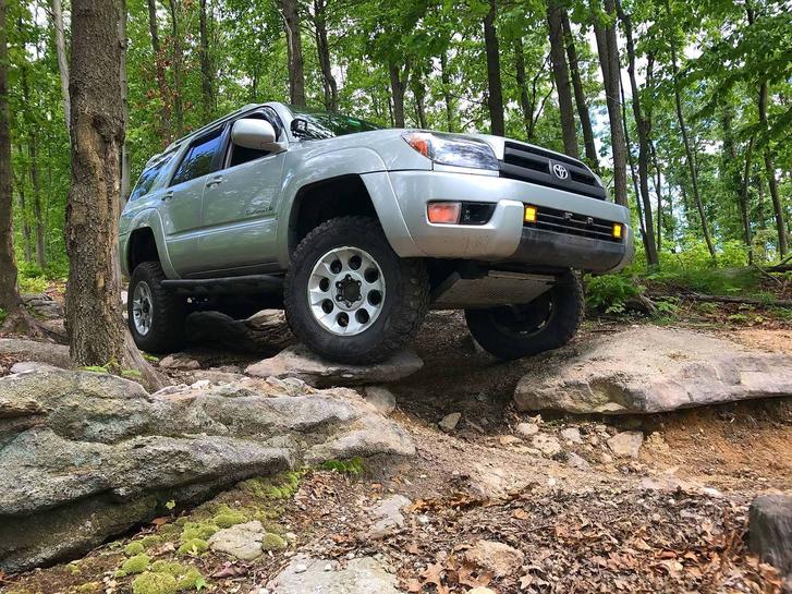

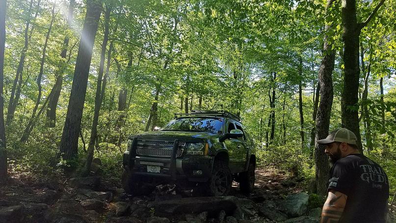

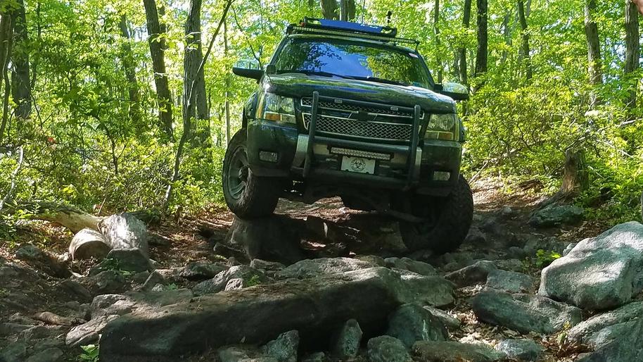

Just got back from another weekend at Rausch creek for the Krawlin for Cops event. Went up with my buddy and his lifted 07 tahoe LTZ. Ran Blues and Blacks. No damage to report drop home 75mph and did the math 18.8 mpg. Cant beat that. Heres jus a few of the shots we took.
