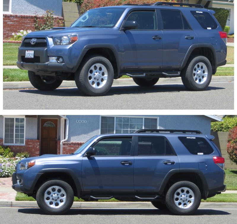

Get it close to level and add air bags. I'm at 0.85 in front, nothing in the rear. Looks almost level. When carrying a load or trailer, I pump up the air bags.
Looks good!
