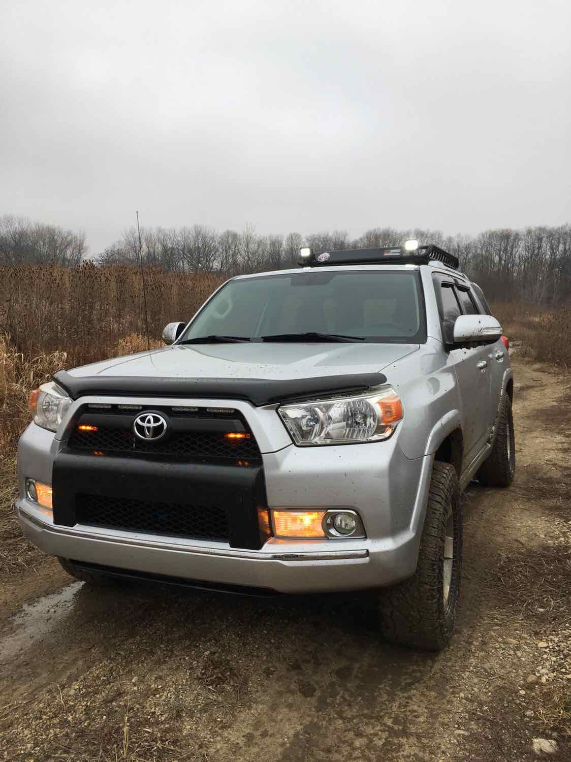

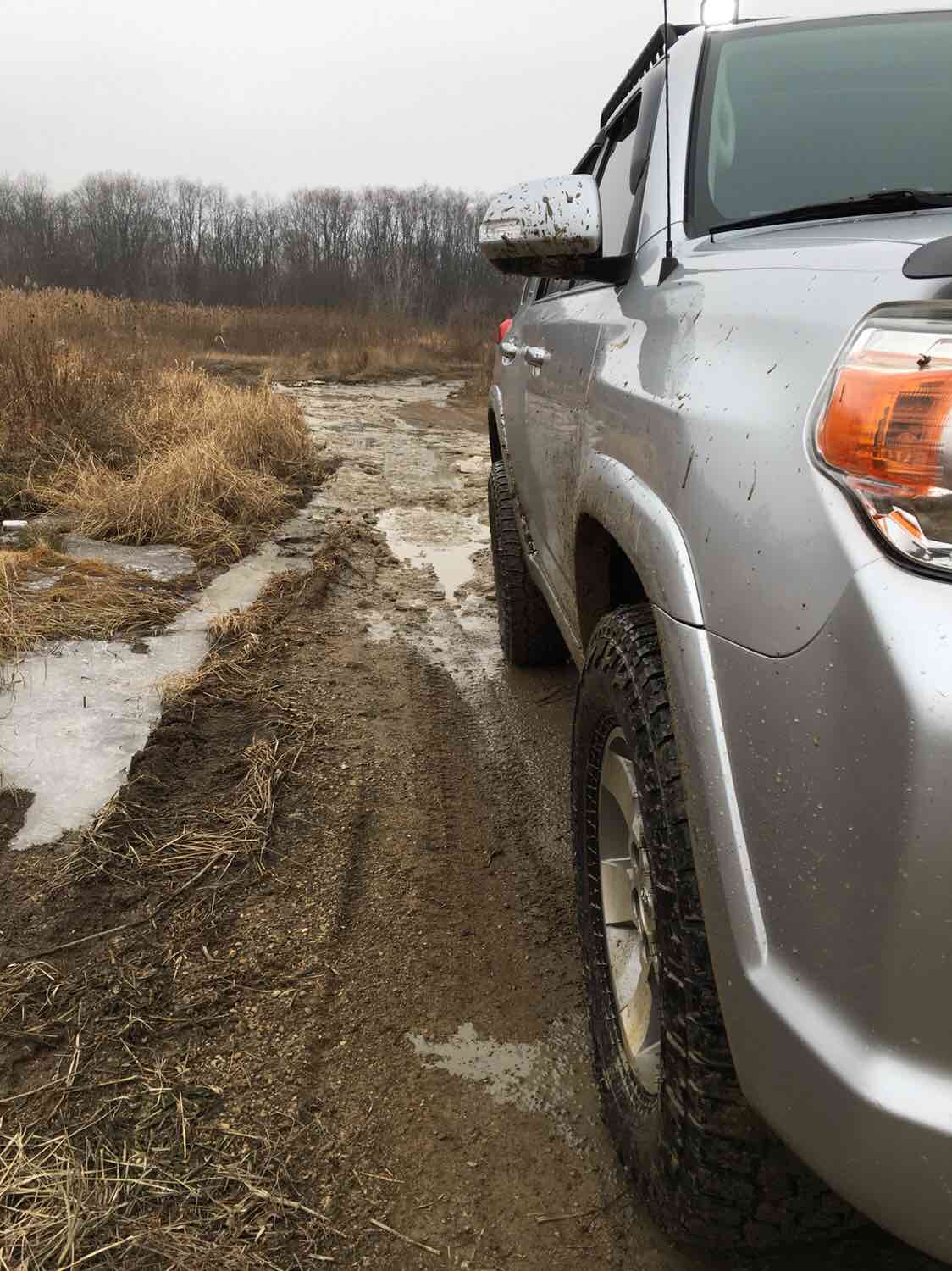

I’ve done a lot of wheeling with my setup as well. More than all of my friends and it’s fantastic. The extra front clearance has been great, even at this lower setting. The ride is amazing both on and off road. I don’t crawl rock because I live in lame Illinois but it’s met my needs. Thinking of going up just for fun and to throw some 33” tires on. Really not necessary though. Plus I’ll have to ditch my cargo basket to get in the garage.
Cleared some of these obstacles the other day no issue.
The latter pics are just for additional reference for those thinking about the .85 setting.

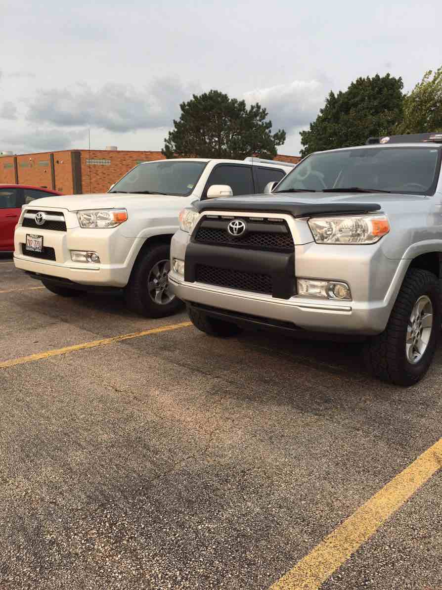

Few more pics next to a stock Runner
.85 front, Bilstein rear with no other mods. Stock size 265 Falken Wildpeak AT3W tires

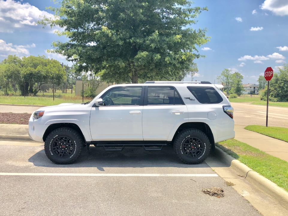

Bilstein 5100 .85" front OME 10mm Rear
Here's my rig after a .85" (second notch) front and adding 10 mm Old Man Emu "trim packers" on the rears with factory springs. I wish I would have done this years ago! Front suspension factory "feel" has not been compromised. I was nervous about this after having put a 2.5" daystar spacer lift on my 4th gen in the past and not being happy with the results. Lift is just right, I can still fit in most of the parking garages in downtown Chicago.

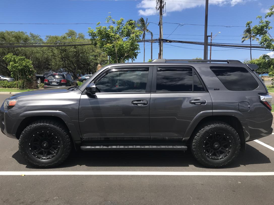

I'm sure the .85 community has seen this on some other thread, but anyways here is my .85 with 265 KO2s ....The KO2s help fill the well nicely ...add about 6 lbs per tire compared to Dunflop. In general the ride is stiffer, but also handles better
Do you have any pictures from the side and I take it those are stock tires?

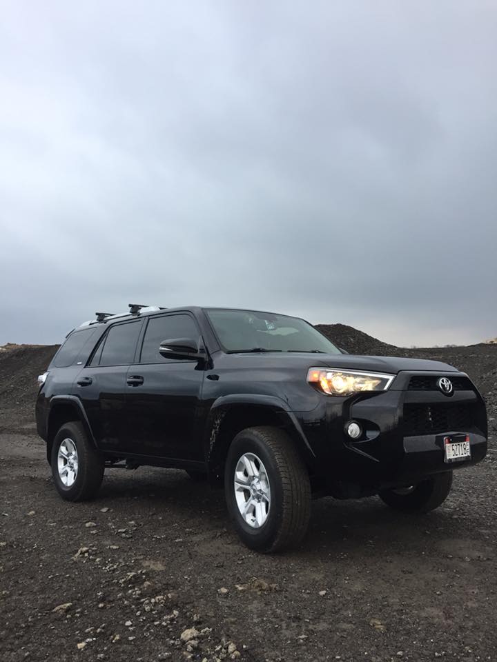

Just got my Bilstein 5100 installed. .85 fronts rear stock. BFG 265/70/17.

Sure man! Since then, mostly pavement, with the one trip to Lone Star Jamboree at Barnwell Mtn... and the Bilstein's and level have worked great. I run them at 35lbs now though...as the KO2s and Bilsteins are a stiffer ride...but that fixed those issues.
Rack is great...I have put kids up there and a few things from the HW store...so not really even scratching its capability. The Prinsu is well constructed and has had no corrosion or leaking issues as of yet.
