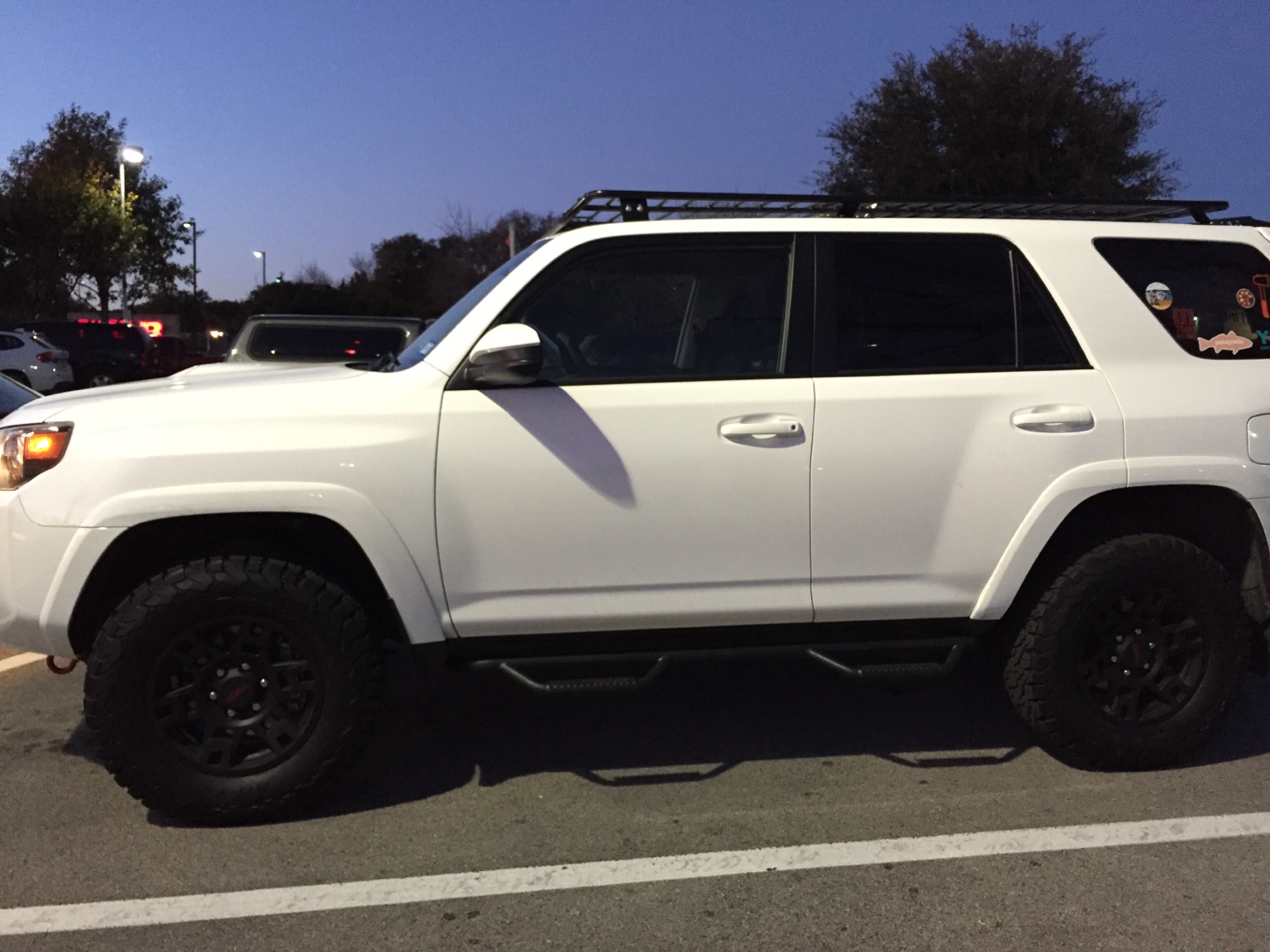

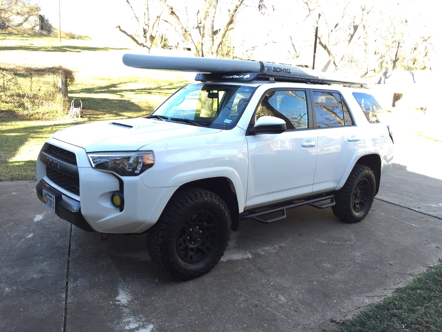

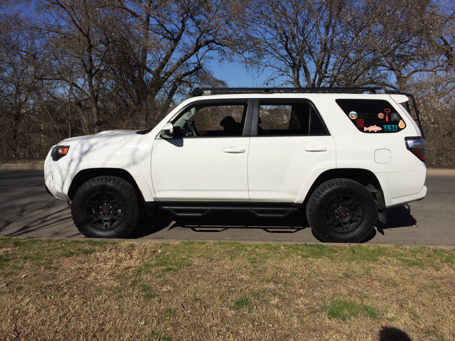

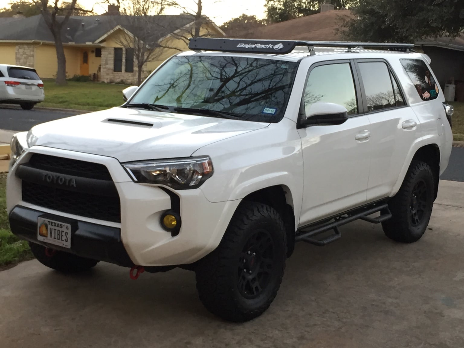

.85 in the front. 10 mm OME spacers on each rear spring.
Not the best pics. Just got the alignment done and it is the PERFECT amount of lift and the ride quality is 100% better. I'll post more later
Was one .10mm spacer used to level out the leaning side or did you add 2 to give a little added lift in the back?
One 10mm spacer on either side to give the rear some lift. Wanted to keep some rake(I hate saggy rear ends). If you put one of these on one side you would have a noticable lean. Even with a full tank its not a 10mm difference.
Looks great. I have a set of 5100's sitting in my cargo area. I think you just made up my mind to for me to get the trim spacers. Used them on my 3rd Gen also and they worked great.

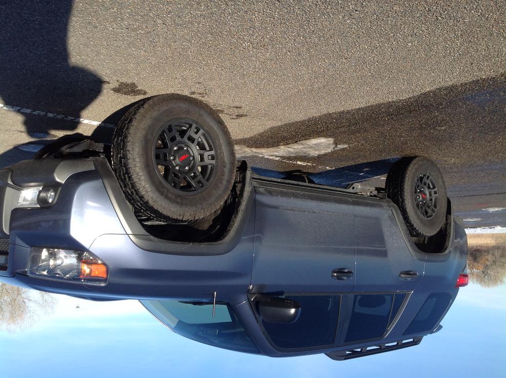

Some more flat shots of .85" front 10mm rear.
Thanks for the pics. I have identical plans when the time comes to replace tires.
Can you comment on ride quality differences with the Bilsteins? Also, if you have a chance could you measure from the center of the hub to the fender on the front? I'd like to know about how much lift the .85 setting gave you. :thumb3:
Ride quality is drastically better. Damper and firmer when braking and turning. Best $300 you can spend on your truck. I'll have to measure from the center hub later but it came out to almost exactly 1" of lift on the .85 setting. The rear gained about .5 inches from the 10mm spacer.

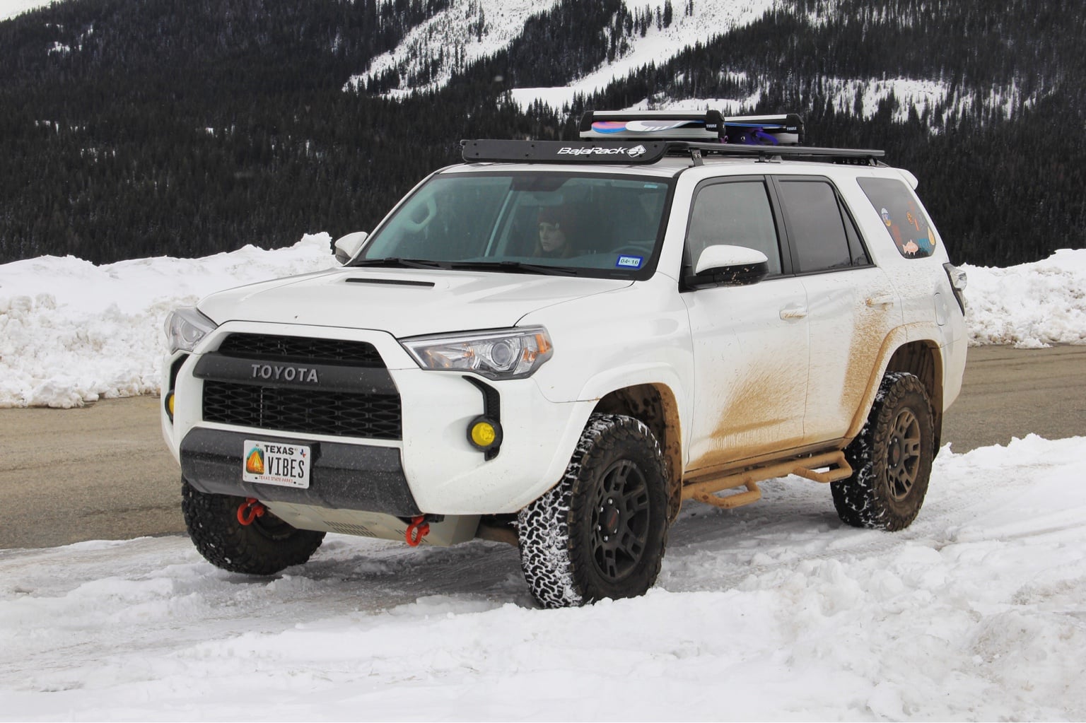

I'm reviving a dead thread. Could people please post up more pics of a 5.5 gen with fronts at .85 and stock tire size? Much of this post is dialogue, and some pics of higher setups than .85. There aren't a lot of .85 pics as the title of the post indicates. Thanks to all in advance. I'm looking to run .85 front with stock tire size on a 2016 sr5p 4wd, and want to see how it looks on a wide survey of other rigs.

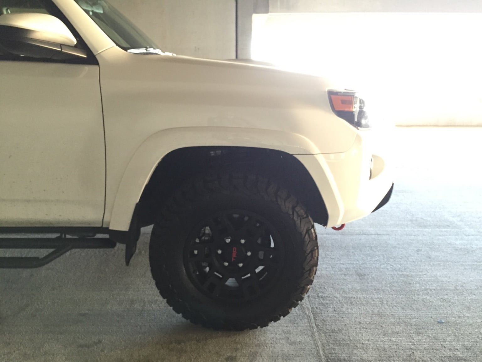

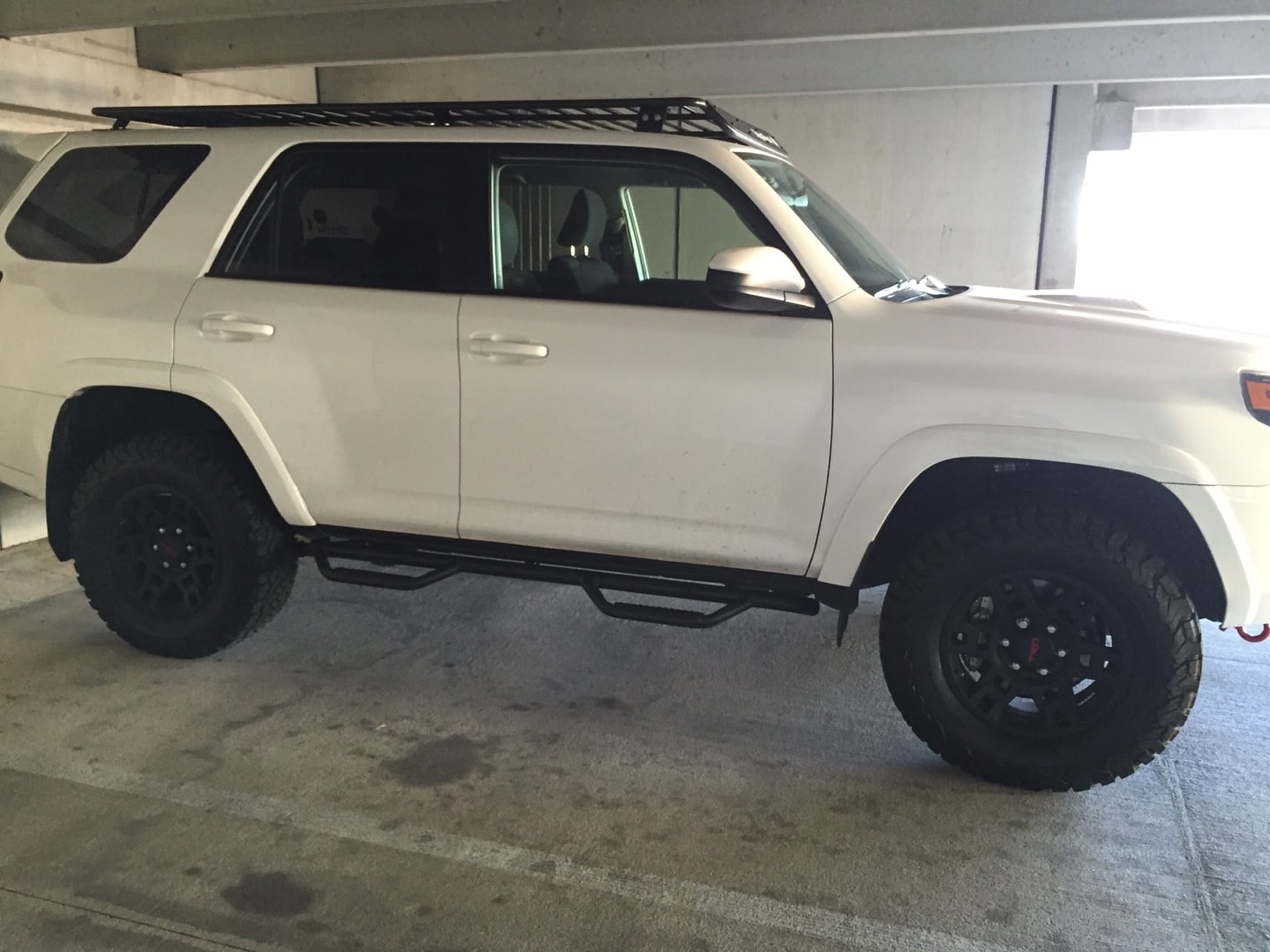

Look at [MENTION=118406]Haydenatx[/MENTION] post above. His is a great looking rig, super white, stock size tires. Only difference is he added 10mm spacers in the rear (~.5" of lift) to keep some rake and installed the TRD wheels. This is essentially what it would look like with very slightly less rake.
.85 setting with 10mm spacers on rear as noted above.
