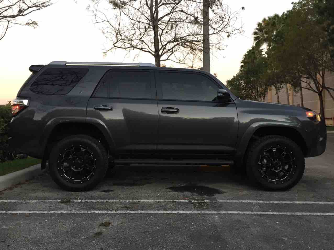

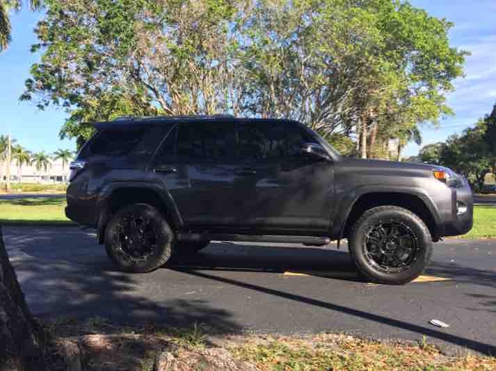

Here are a couple pics of mine @ .85" with stock rear. I initially installed them at 1.75", but ended up switching to .85" before I went in for new tires/wheels/alignment. 1.75" was dead even at the wheel wells, with a slight reverse rake at the frame. As soon as I added any weight in the back, the reverse rake got to be too much for my liking, especially since I haven't stiffened up the rear end yet.
Running 265/70/17 KO2s on 8" wide FN FX Pro rims. Definitely gives it a better stance over stock. Tiny bit of rub in reverse at full lock right, so the inner fender mod is next.

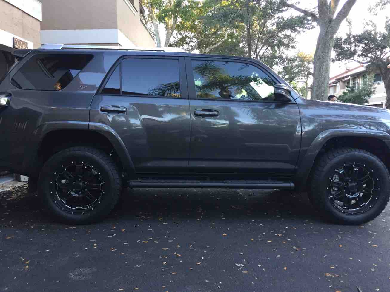

Here is mine 1.75 front rear 1inch spacer

This was super helpful, I'm running the same wheels and tires... Your truck looks great at .85!

Glad it was helpful!
1 - I swapped the shocks and tires/wheels at the same time, so can't say wether or not they'd rub. My guess though is that they would.
2 - Only had the stock shocks on for about 150 miles. The only thing I can say for sure is that the braking nose dive was way bad on the stocks. Fixed the problem with the billies, and I really like the ride. Not much time off road yet, so can't speak to that.
