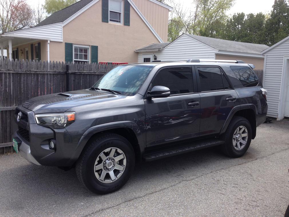

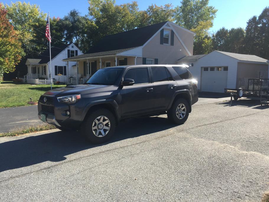

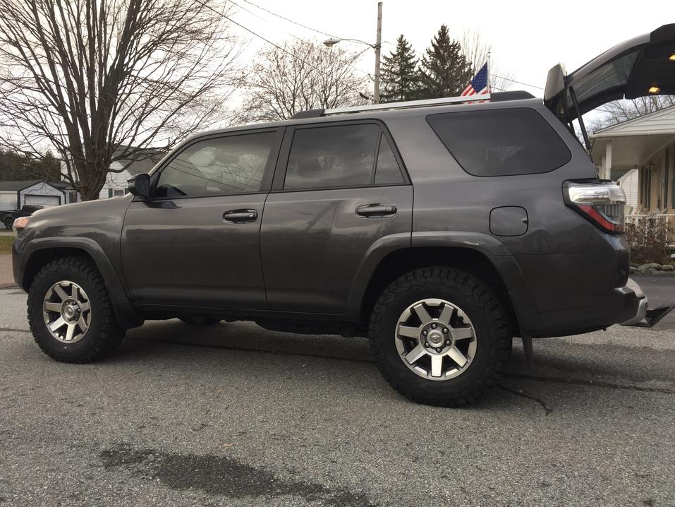

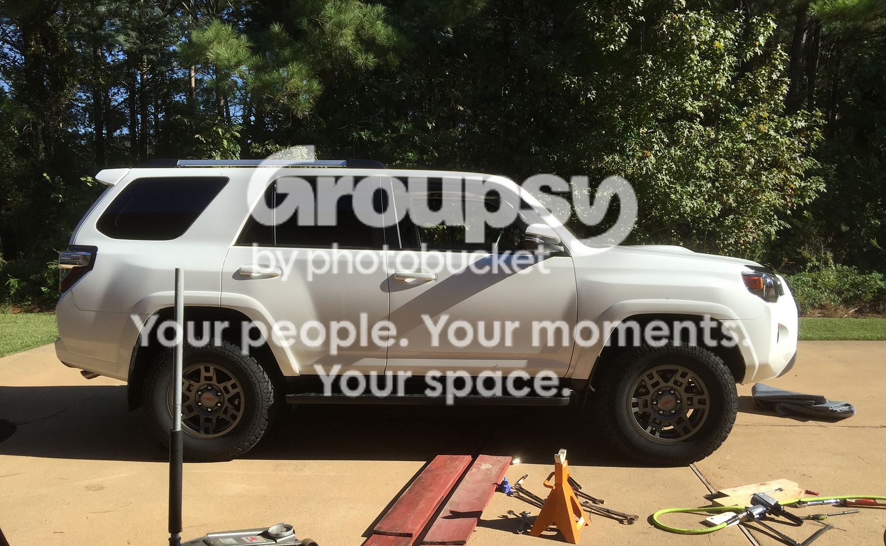

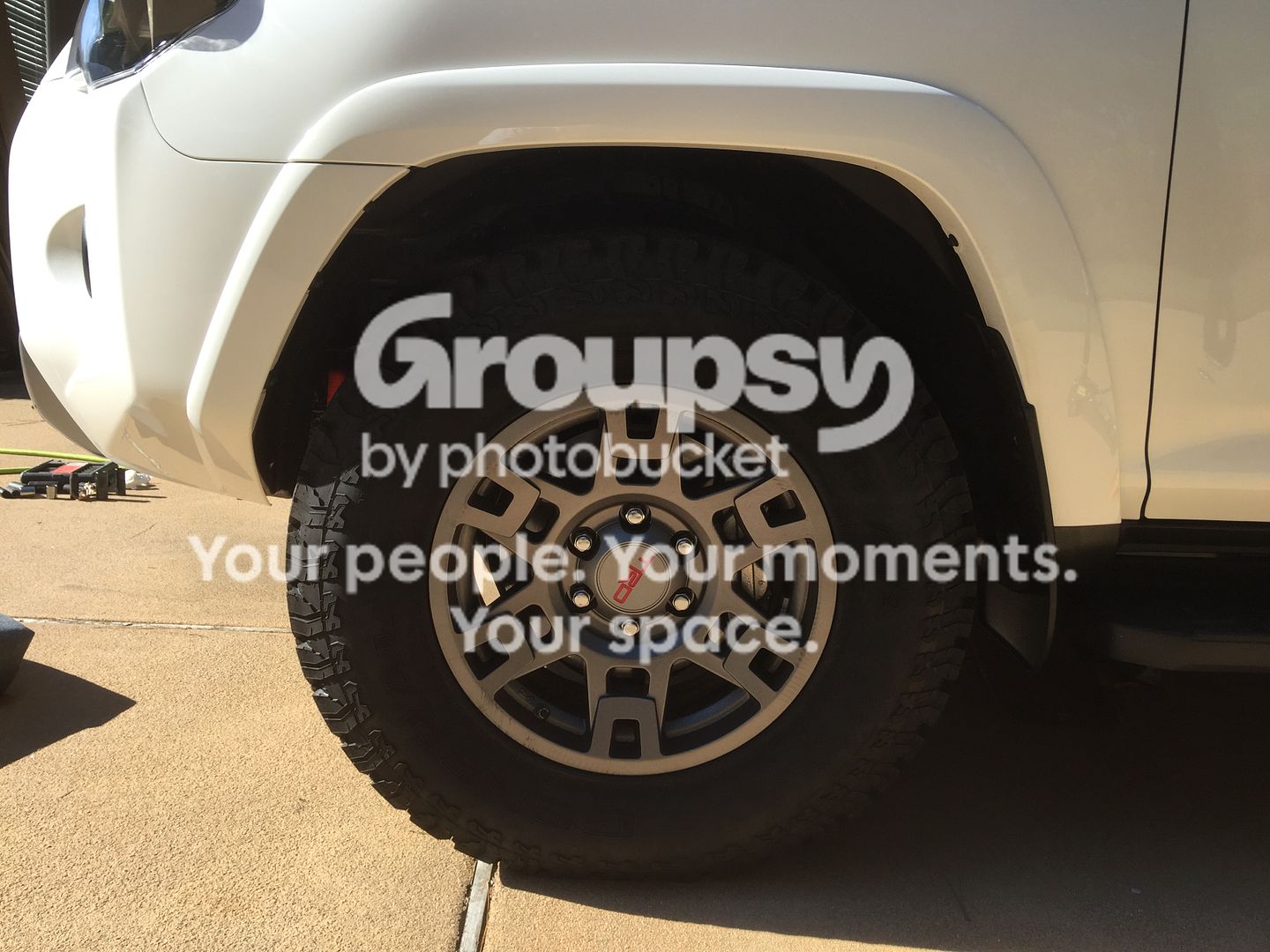

2014 TPE w/ 5100's all around, .85 front setting
I love the ride with these, feels a lot more stable and it did get rid of some of the front end dive when braking. It has KDSS as well. No other mods done, tires are 275/70-17 KO2's and I only get a little rub at full lock on a hard bump. I also did the roof rack delete to help get the snow off this winter, shoulder surgery coming up in 3 days! Hard to do one handed... Here's pics of stock, then tires, then 5100's and the roof rack delete

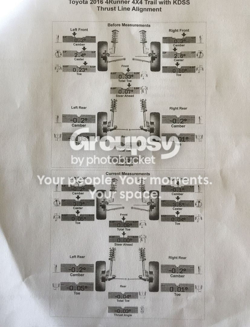

I wanted to post up my alignment info - I know all trucks are different but this will give you an idea how even the .85 lift changes everything
Sorry Toyota could not give me a color copy today but most know how to read these.

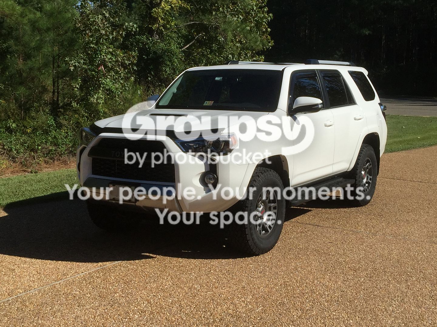

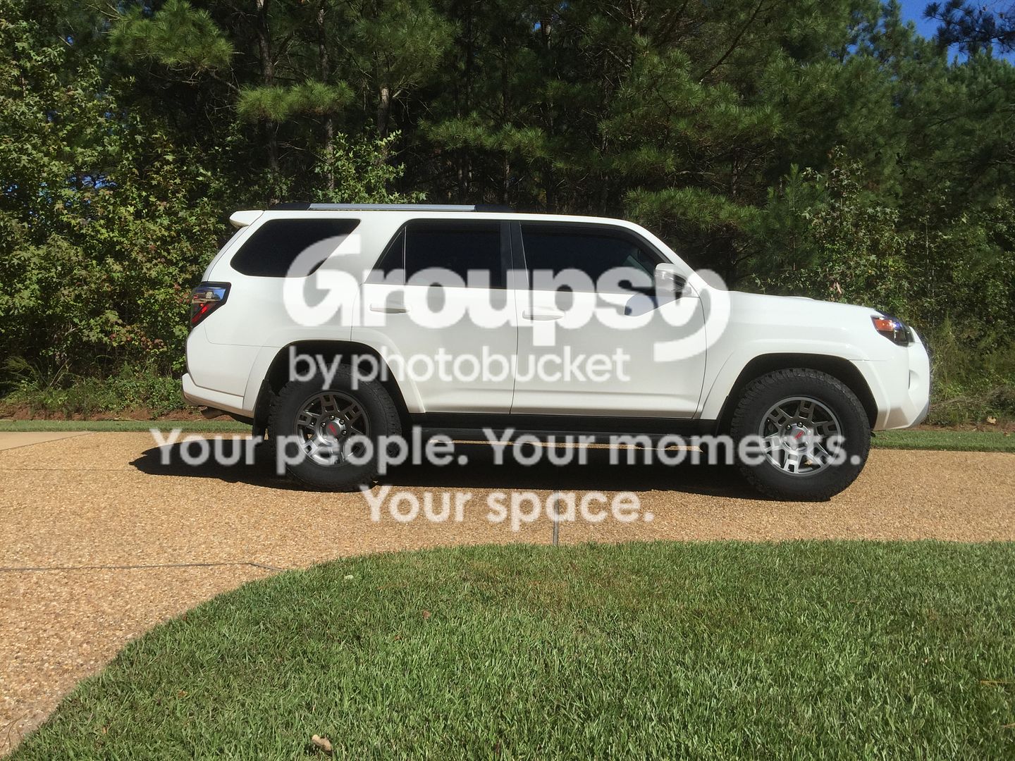

I’ve done quite a bit of research on all of this, and followed many of the same steps codyHTX has done. If all you want to do is level out the truck a little and slap on 275’s, then I would suggest 5100s with the fronts at .85 and call it a day until you are ready to redo the suspension. IF, you want a little more lift/meaner look, then you can go the same route as [MENTION=127657]codyHTX[/MENTION] and I both did, which is 5100s with front set at 1.75 and then add a 1 inch spacer to the rear suspension (and slap your new tires on there). The ride (mostly in the rear) suffers a bit from the spacers, but not horrifically bad, and you still have a bit of rake for loads, etc. At some point, I believe codyHTX and I will both revisit the suspension and replace the springs, etc. But the current set-up accomplished what we were looking for at a relatively inexpensive route. I’m still running stock-sized tires on Trail Ed rims (only NITTOs instead), but because of the spidertraxx spacers, they look pretty good all in all.
Search for some of my posts/replies... I have pics of my truck with 1.75 setting up front and no rear lift... and then 1.75 setting with 1 inch spacer lift. You should be able to see the difference even tho my pics are crappy iPhone images.
