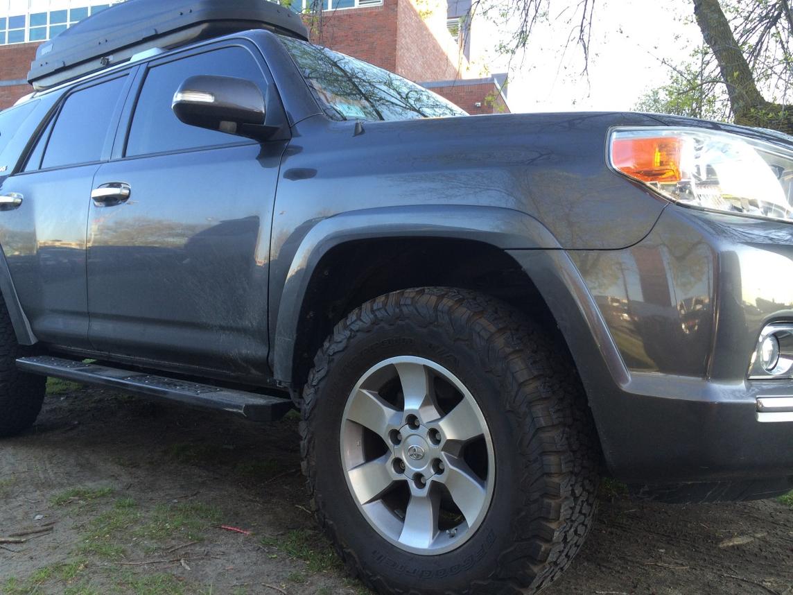

Blistein 5100 0.85 front. Stock tire size 265/70R17 Falken Wildpeak AT3W

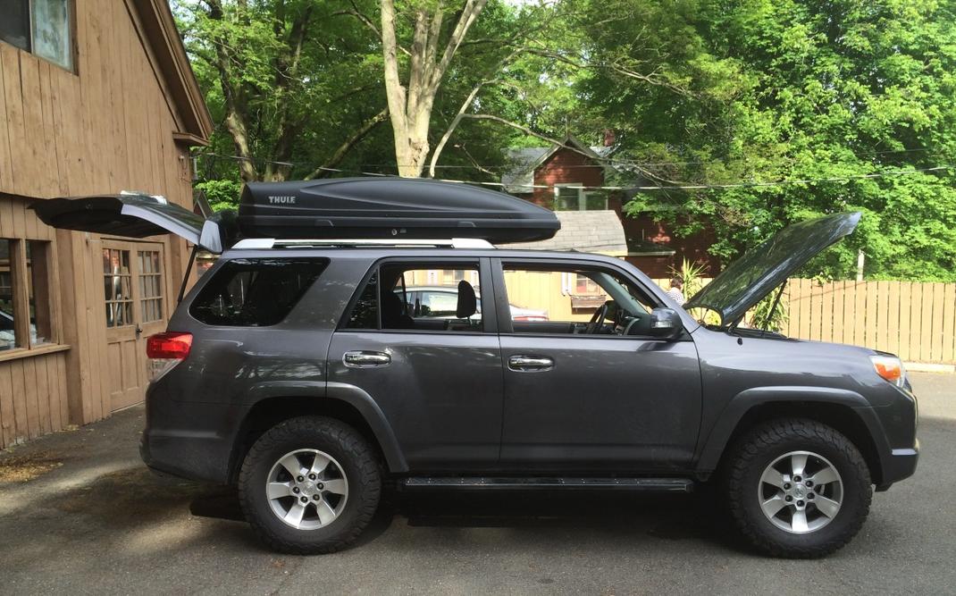

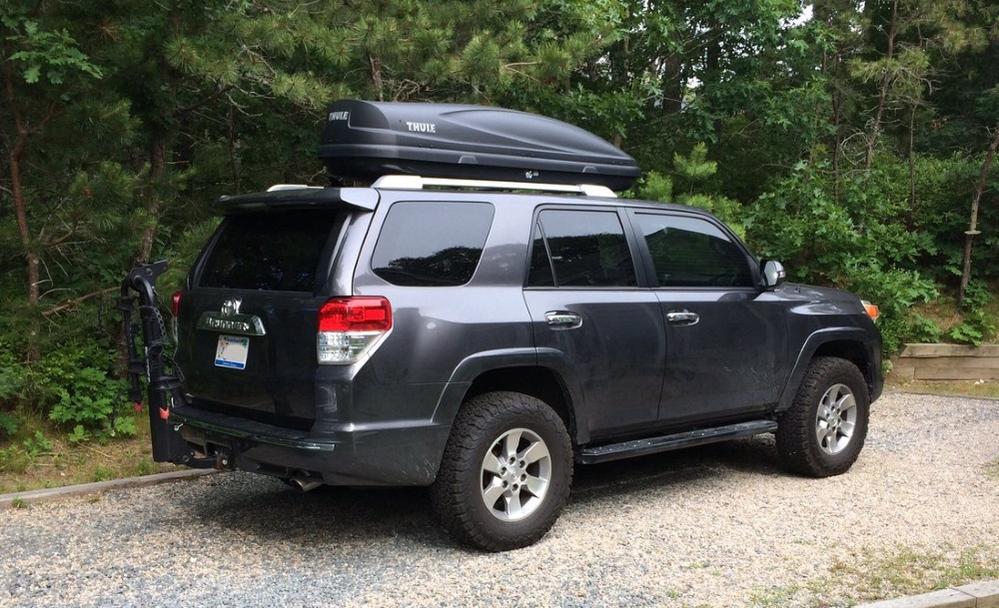

Here's my 2010 SR5.
Front is at .85, rear suspension is completely stock. Tires are stock-sized KO2s.
Here are some of my minor issues:
1. I noticed an issue with visibility. Specifically, my 5'3" wife noticed it. It is harder to see what is directly to the front-right of the vehicle, such as when pulling into driveways or parking.
2. When loaded, now the rear end looks like it sags more, so I need to improve that.
3. Wheel rub during tight turning, but I think that is mostly due to my spacers.
