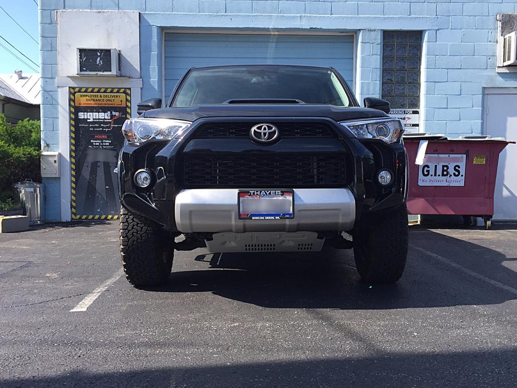

Bone stock, except Bilsteins @ .85.
That doesn't preload, it just makes it longer.
5100s are similar to a top spacer, not a coil spacer, you are adding length outside of the coil
News to me; was led to believe from more than one source that changing the height setting on the 5100 added (some) pre-load to the shock. Regardless, makes no difference to me. The ride is firmer than stock shocks as mentioned.

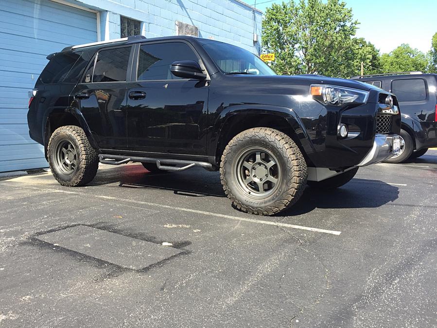

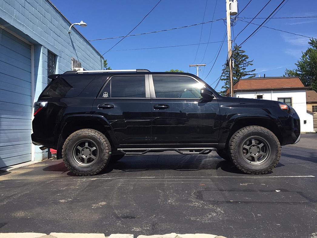

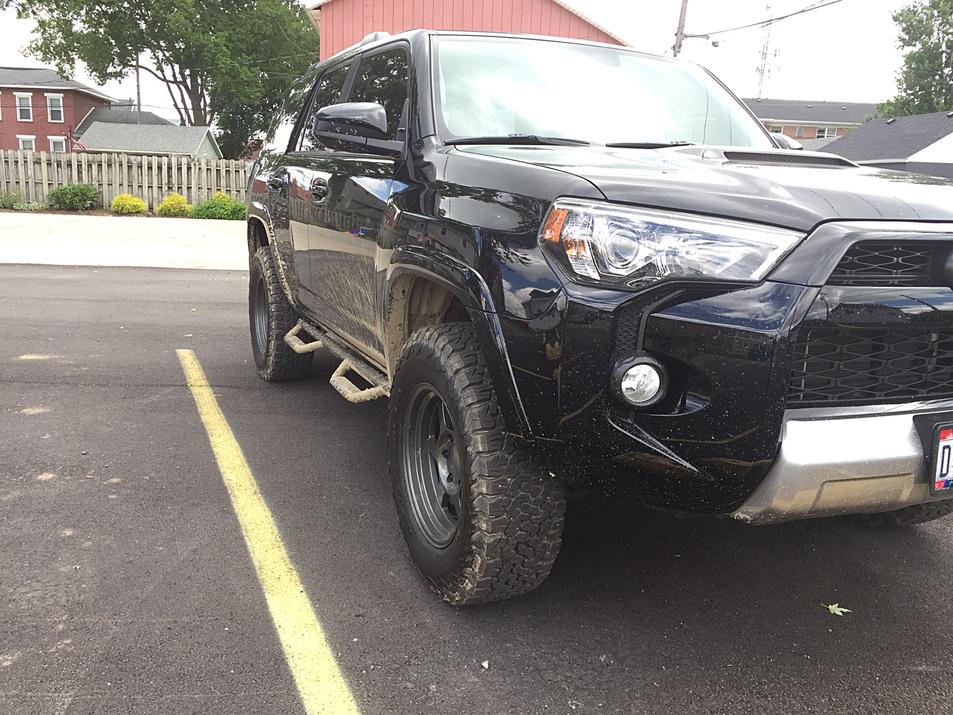

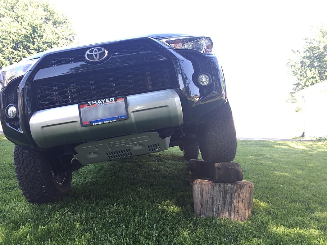

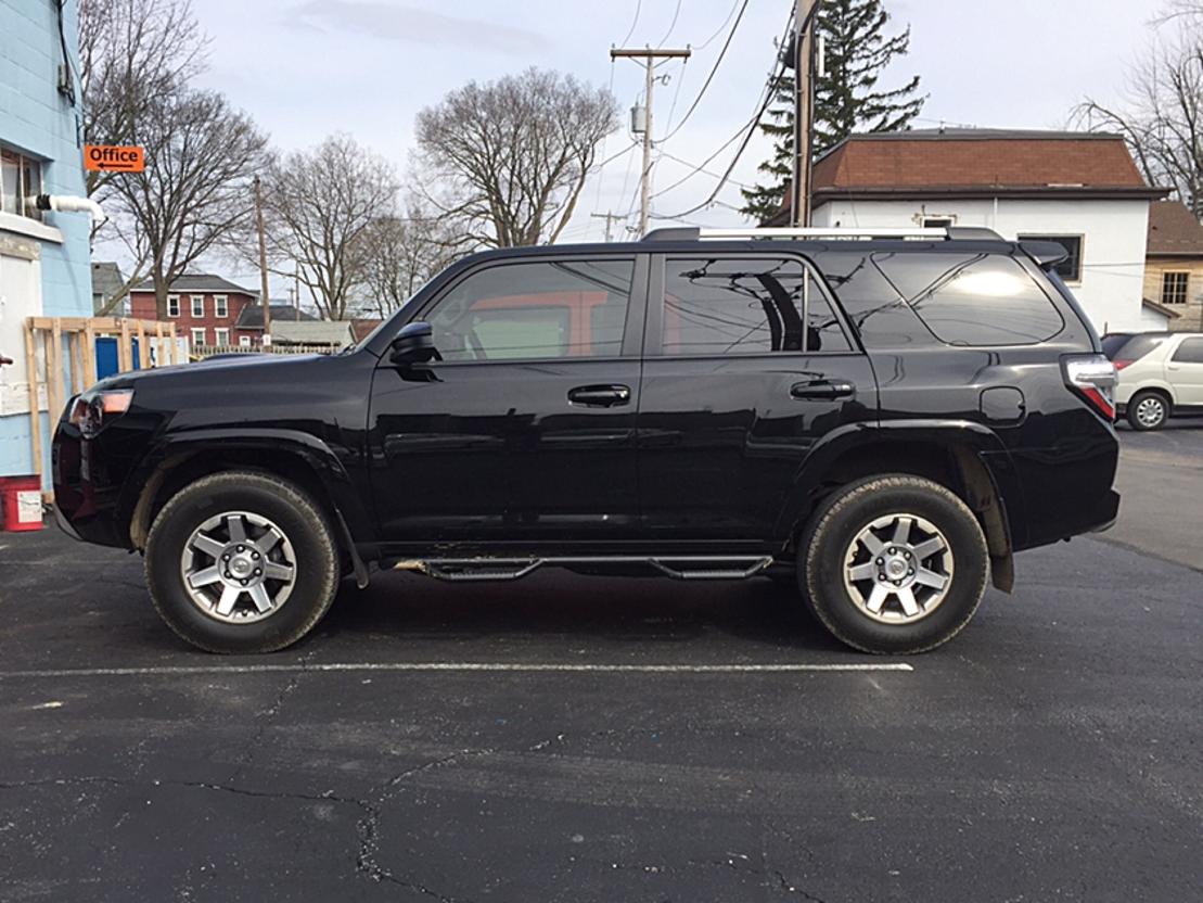

Bilstein 5100s @ .85/0
Before and after:
Was the car lifted in pics #2 and #3)
All the pics after the first pic have the .85 front lift. It simply gives a leveled result with VERY SLIGHT forward rake. The ride quality is similar to stock but a little bit stiffer. Not as much body roll when turning and less nose dive when breaking.
