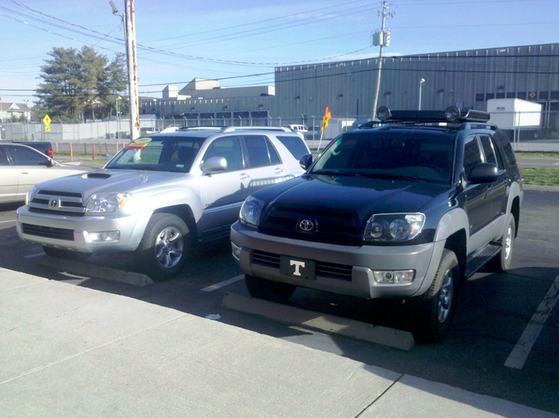

Bilstein 5100s at .85" with stock springs
That looks just right to me. I like a little rake. I think you may have it :bravo:

Another quick pic...Went to get an alignment and just so happens that a stock '05 was in the parking lot. I wish I had taken a better side pic showing the difference in the stance, but you can still tell that my truck is much flatter and noticeably lifted. The tech even made a comment that he liked it.

Looks good.

Hi, I just thought I would post some data on my Bilstein install that may be useful for others. I have an 09 V6 sr5 4wd that had 2.75” of rake (measured from the center of the wheel hub to the bottom of the fender: front 18.5”, rear 21.25”) and installed 5100’s all around (front set at 0.85). The actual front lift was 1.25” and the rear did lift exactly 0.5” (as others have experienced). I could have easily went to the 1.75 setting if I knew for sure that the rear would lift (I can only assume because of the increased gas pressure helping the coil a bit vs the original shock?). With the current lift, the running boards are dead level now, where before they pointed down with the rest of the nose. It’s surprising how much room was opened up in the front wheel wells with only 1.25” of lift.
The best part of the shocks is the much improved handling. I am absolutely amazed at the change in handling without sacrificing the ride quality. As others have stated, nose dive during braking – gone, body roll during cornering – gone, bump steer – gone, original ride softness (stock coils) – no change.
