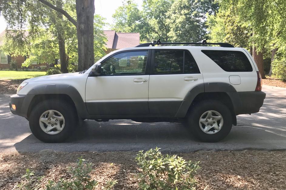

Just installed a full set of Bilstein 5100s, front and rear. Fronts set at 0.85". OEM springs, no spacers.
The end result: front went up 1.25" and rear went up .5".
I was looking for a mild lift and am very stoked with the results. Was able to get new Falken Wildpeak A/T3W tires in 265/70/17 to fit without rubbing.

I too just went with 5100s all around and new front stock springs. .85 setting. KYB mounts. I was surprised the car seems to ride softer than the xreas on pavement and handling is also very good. Cant wait to take it on the beach this fall. Very satisfied with this set up.
I just finished up the whole setup. 5100’s front and back, no spacers, KYB mounts, stock springs (front ones are new, but they’re OEM spec moogs) .85” setting up front. I got about .5” increase in the back and just over 1” up front. The running boards sit perfectly level, but there’s still a tad bit of front rake. Happy with the way it looks. I pull a trailer from Columbus, OH to central PA a couple times a year, so I didn’t want the negative rake.
Rides so much smoother than before. The old shocks had been leaking for quite some time and had practically zero rebound to them at all. Once my Cooper Discoverers are worn, I’ll go up a tire size for sure.
