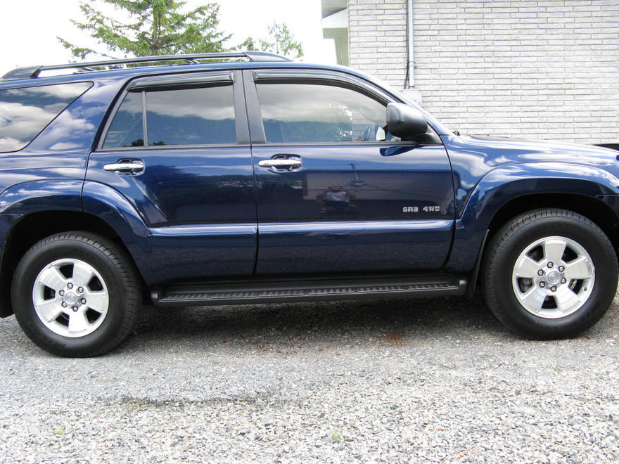

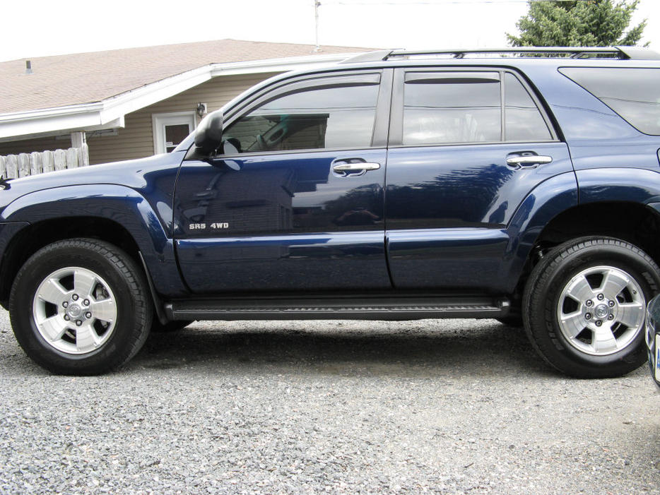

I got a chance to take a few shots. The lower shot is with Bilsteins installed all around with fronts set at 0.85. Although the pics are from different sides, you can clearly see the rear lift from the shocks. (tires stock 265/65/17)
Stanleybb50’s description of “the ride” couldn’t be stated any better. Even if you are not looking for a lift, these shocks will transform your ride.
Btw I had the 4 installed for $200 (not at a dealer)
